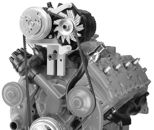

    It's tax return time... woo hoo! Time to spend it before it gets here... so this is to anyone that's gone through a vintage air installation... I can find pics of the unit mounted under the dash, that's the easy part so far. I can't decide between the Alan Grove bracket and the Vintage air 131004. There's only one small stock picture of the v.a. bracket on a 239 that I have found online, but from what I can see I think I like the look better due to the alternator tensioning arm.
    Does anyone happen to have pics of their flathead running the 131004 bracket? The larger pic below is the A.G. bracket that most shops resell.

    Here is my flathead with the vintage air bracket
  18. Brentphx
    Joined: Aug 12, 2014
    Posts: 256
    Brentphx
    Awesome, thanks for the replies... I definitely think I'm leaning towards the VA bracket. Should be ordered soon!

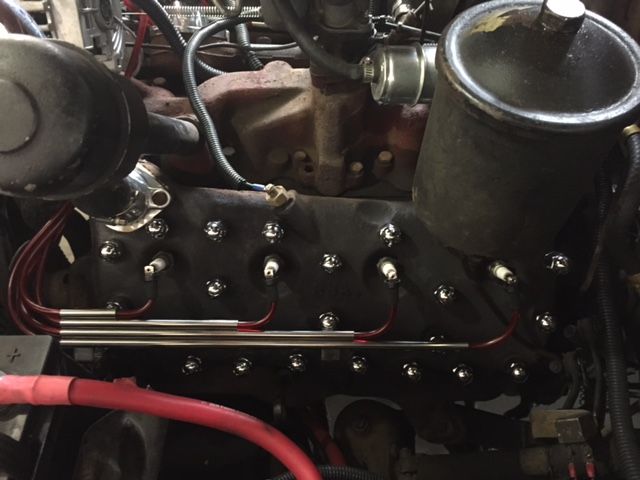

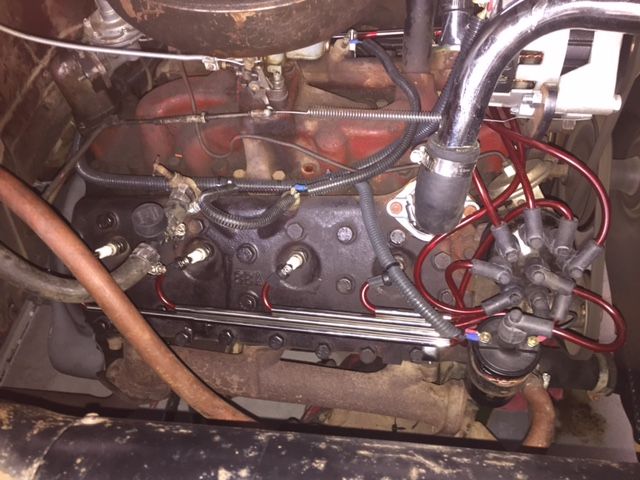

    Spent a few hours playing today, here's a few before and after pics... the rattle can was sprayed over the grease/dirt/god knows what else was on those heads so it was only intended to cover the faded maroon paint.
    Drivers side Before:
    Drivers side After:
    P***enger Before:
    P***enger After (I still need to arrange the wires on the cap, just plugged in to make sure it ran lol):
    I pulled the acorn covers off the shelf, figured she'd been pretty nice to me since I brought her home... why not add a little shiny. I know it's a waste on stock heads and looks better on finned heads, I couldn't help myself lol.
