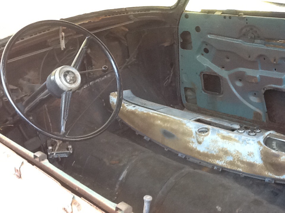

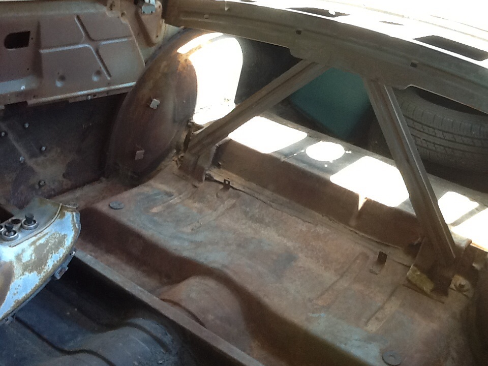

    Got the interior gutted out a while back and cleaned the shell out . Retired entire car with an ez wiring harness. Very nice people and helpful with installation questions . Also got the dash dis***embled , sanded and painted
