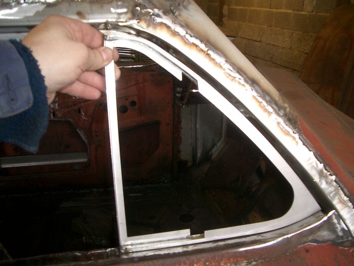

    To i have worked with the doors. I fitted the vent windows.
    I have closed the holes under the vent windows and made it to fit togther with the windows
    I made it on both the doors
    Her's a test of the ventwindows

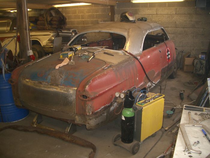

    Her's the car from the rear. I have begin to think of repair the rear stone deflector or maybe do a totaly new one insted and throw the old in the junk

    I say make a new one....for me I would have to repair it, but you can make anything.

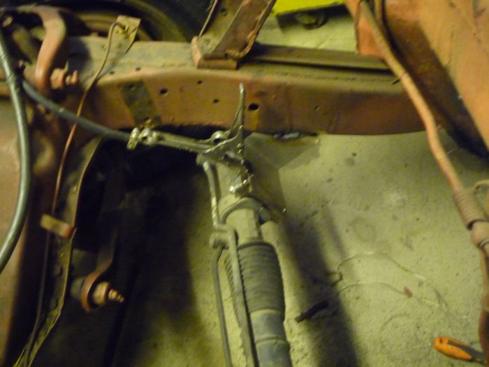

    I have worked with Saab r&p steering
    Her's a test of the place for the r&p
    Her's the p***enger side spoot welded
    The driver side
    The both sides are welded on the easy areas the rest will be welded when i take of the body from the frame and can rool the frame to better placement
    /Stefan

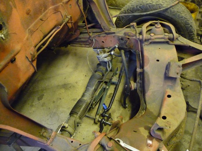

    Interesting placement of the rack. Do you have the linkage figured out yet, any pictures of it in action?
    Where will the exhaust exit the motor and how will you clear the rack? Under? Over? Fender well headers?

    I have figur out how i shall do with the steering
    I shall use a adpter thats move out the steering bars so they will be aprox 16" long
    it will look like this but not moving to the other side
    I'm working as engineer so that good to have as background
