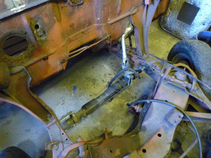

    I were out and screw up the r&p
    I have test a shaft with jonit. I don' know what is coming from but i belve is from a saab or opel
    Her' s seen from the inside
    I have think to do somthing like this as steering adapter
    /Stefan

    hmmmmmm.
    so that will spread out the drag link to the outer tie rods.......
    Should work ok I would think.

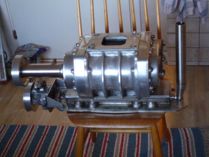

    You are right i have a blower to the flathead
    Her's home made blower mainfold
    The servo pump is from a Honda thats are rotaing backwards
    Her's my GMC 371 blower
    /Stefan

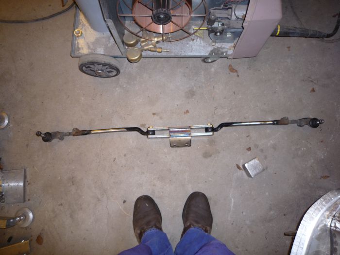

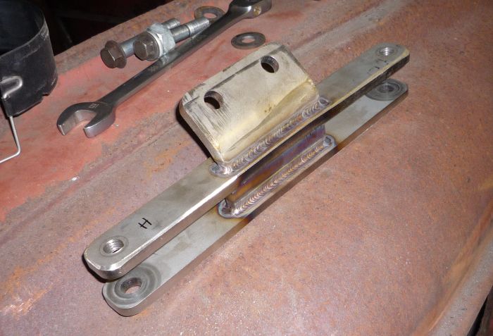

    I have done a steering adter to the saab r&p steering
    as model
    And the ready one
    Her's the adpter with the steering bars
    The bars are shorten 100mm [4"] eath and the adpter move the bars out the same
    Her's is is the bars and the adpter asembeled in the car for test.

  12. JAWS
    Joined: Jul 22, 2005
    Posts: 1,848
    JAWS
    Nice work...
    Using the stock spindles and arms, you don't have to rethink the factory's steering geometry. You are just replacing what was in between that did the same job, with something more efficient..
    I dig it!
