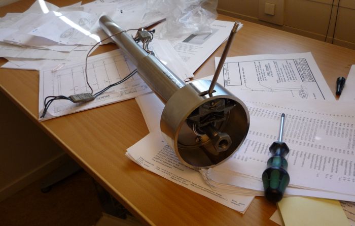

    I have to begin to make more parts to my new steeringshaft
    I will put in a turn signal under the steering wheel
    The bracket i have made must be modifided it were imposble asemble it togter with the contact
    /Stefan

    I have made litle more on my steeringcolon
    The turn signal switch hausing have get a 2" usod pipe weld on it down.
    In the other end of the pipe will the holder to the dach sit.
    The shaft will put inside the housing
    /Stefan

    Her is a test asembly of the steeringcolon with turn swith in the hausing togeter the inner shaft
    /Stefan

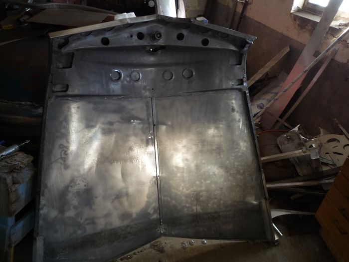

    I have begin to sand blaster my hood
    the inside is blasered now. I have only taken chemical rust remover on the new blasted aeria
    It is nescerry to weld some small holes in the outer edges.
    The ****ing work blaster the inside of the hood took 4.5 houres with taken up old sand and fix it so i can use it aigin
    /Stefan

    I have blaster the outside yesterday.
    It take lott of time to do it and i used approx. 150 kg [330 lbs] of sand to blaser one side.
    after i have blaster i have to take up the sand and reuse it.
    /Stefan

    its that regular play sand ?
  15. Stefan T
    Joined: Sep 15, 2008
    Posts: 2,165
    Stefan T
    from Sweden
    Yes
    it came from a forgoten bunch of sand down of my home
    i have bought some real good sand too but i have not try it yet i must have some more bucket to colect it in after use
    /Stefan

    Stefan, be careful not to get the panels hot with that sand as they will warp.
    Looks great as usual. Getting closer to driving......

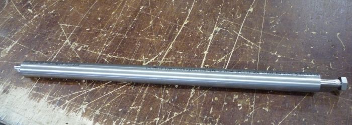

    Her's litle more of the steering colon
    The outer tube is now ready
    Her's it ***embeled with the inner shaft and with the cables and turn switch
    /Stefan

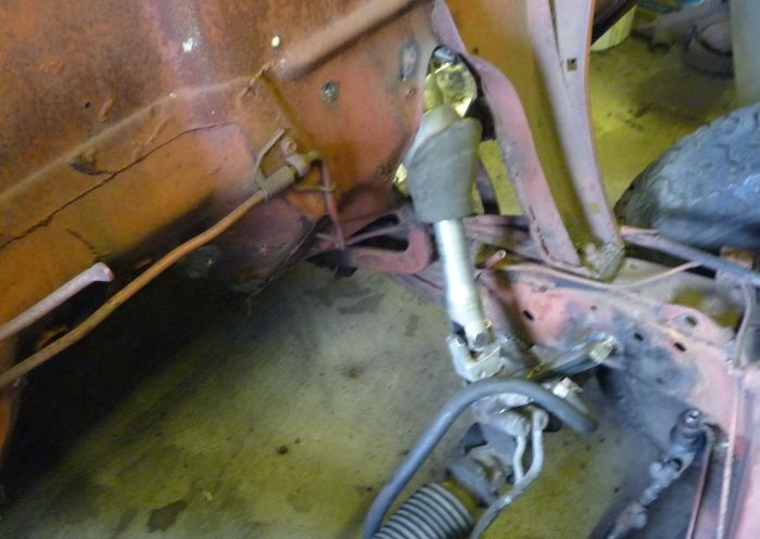

    Her's a test of steeringcolon in the car
    It must be coneted to the lower steeering shaft and fasten to the firewall
    /Stefan

    I were in the garge today and worked on my steeringcolon
    it is now fasten in the lower end to the body
    Next thing to do with the steering is to close the holes around the rubber grummet to the steering shaft with sheet metal.
    /Stefan
