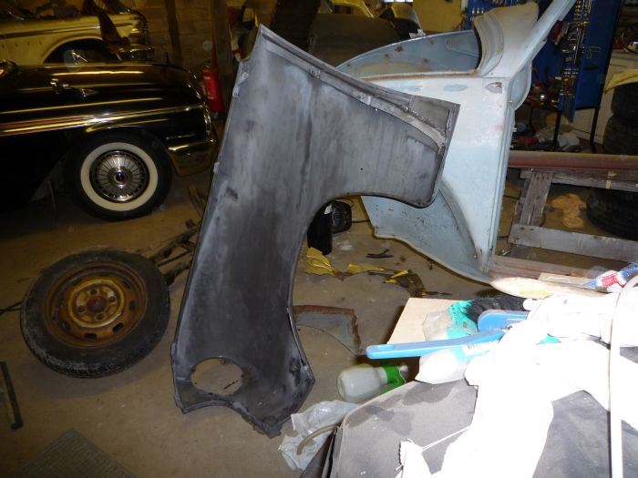

  3. Stefan T
    Joined: Sep 15, 2008
    Posts: 2,165
    Stefan T
    from Sweden
    Thanks for the coments
    I have disasembelde the innerfenders
    And i blasted some of the parts today
    But there is more left to blaster.
    /Stefan

  18. Stefan T
    Posts: 2,165
    Stefan T
    from Sweden
    Thats right and it not fun to blaster a way. It take time if it sits well
    I have little luck for some of it flys dirict of but only some of it.
    /Stefan
  19. RPaciotti
    Joined: Nov 17, 2009
    Posts: 29
    RPaciotti
    Stefan, if that's the original rust proofing, a little heat from a propane torch and a gasket s****er will go a long way... at least for the big stuff. Just heat for a few seconds and it s****es right off!

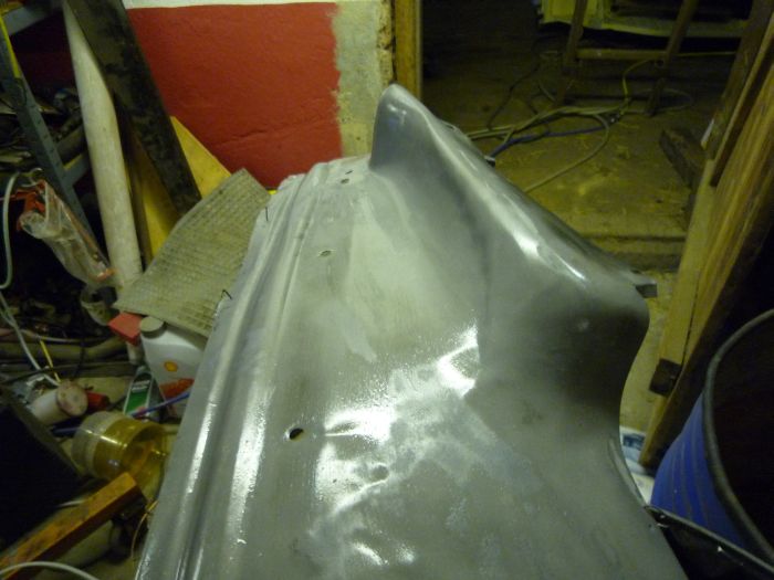

  20. Stefan T
    Posts: 2,165
    Stefan T
    from Sweden
    Thanks for the tips and for your coments
    I worked little on my front fenders and weld up the holes for the 1950 turn lights
    I shall use a 1949 grille on my shoebox.
    /Stefan

  22. Stefan T
    Posts: 2,165
    Stefan T
    from Sweden
    I worked little on my front fenders and i have weld the bolt holes for the 1950 turn lights
    I shall blaster the rest of the fendes soon as i have time and the wether is good enought.
    The rain most of the time now
    This fenders is blasted....
    /Stefan
