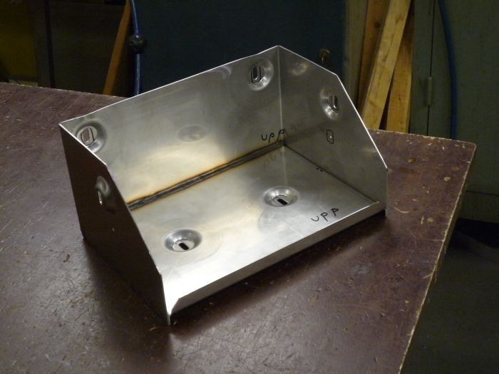

    The batteri box is rusty
    so i made a new one
    Her's the new one made in AISI 304 or 1.4301 (Stainless Steel)
    /Stefan

    Nice work Stefan. Everytime I see this thread near the top I get excited to see your progress! That battery box is great!

    Fantastic job with the battery box ... not that I'm suprised how well it turned out :) .

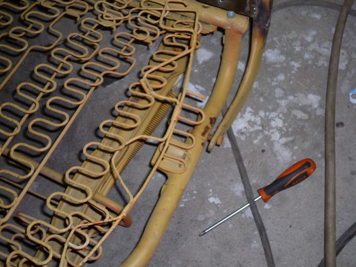

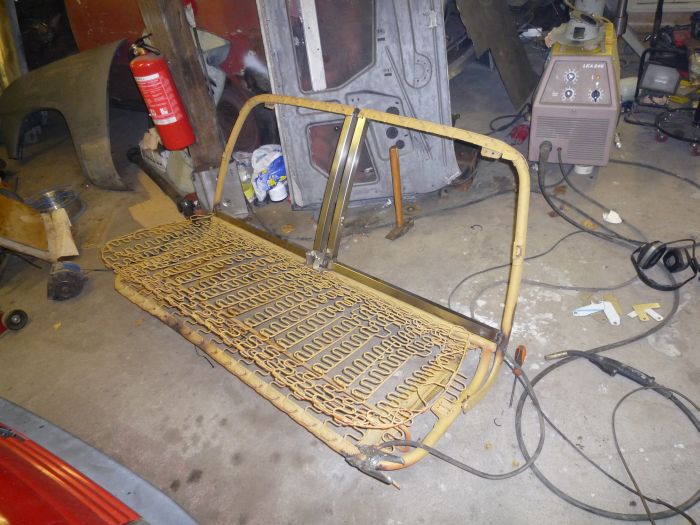

    I have begin to my front seat i have take down from the storage and put the back together with bottom
    The lower pipe in the back have some serius rust damage and the springs are bad to on the back
    so i removed the springs and change the pipe to an 30x30x1.5 mm square pipe
    next think on the seat is to put in 2 pipes or L-irons to the middle.
    And put in hinges i the middel of bottom peice.
    /Stefan

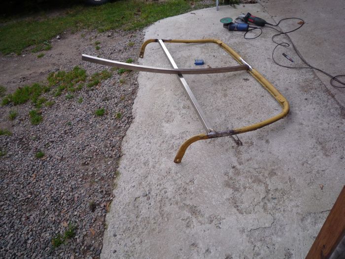

    I have made some more on my seat
    I have rolled a square tube so it get same radius as the outer pipes
    and i weld in 2 peices of the pipe. I have weld some holes in the bottom part of the seat.
    The seat is from a forest wreck.
    Next thing on the seat is to put in some hinges in the middle.
    /Stefan

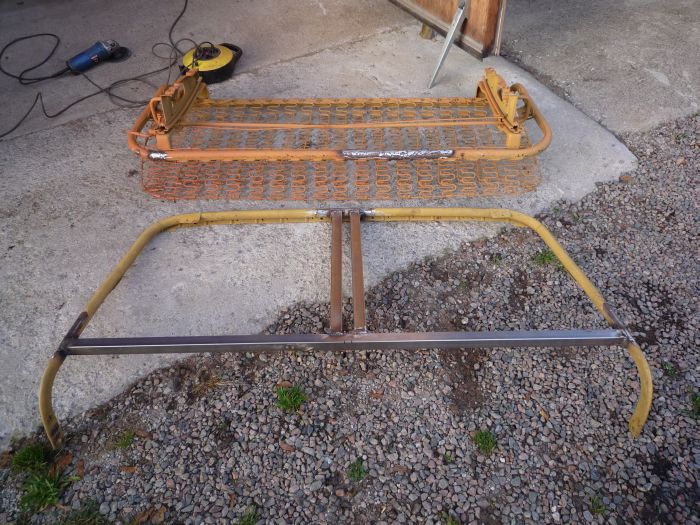

    You will want the longer radius hinge arc for the out side so it fold forward and inward. Both sections wont be able to be folded at the same time, but the ingress and egress with be better. My 46 Chevy works this way originally, I don't know if it will help for your ford seat.
    The outside hinge points are approximately 6 inches forward of the bottom of the seat back. The inside hinge points are higher by approximately 1 inch and are set just ahead of the seat bottom, roughly 2 inches.
    I will take it apart if you need for a visual.

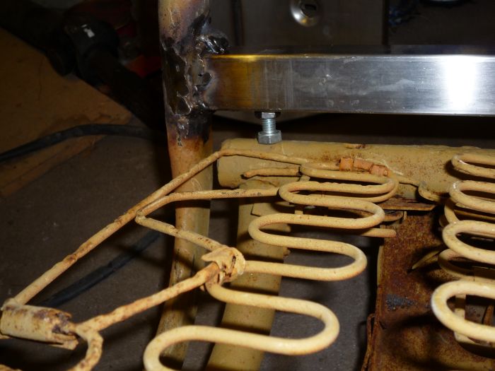

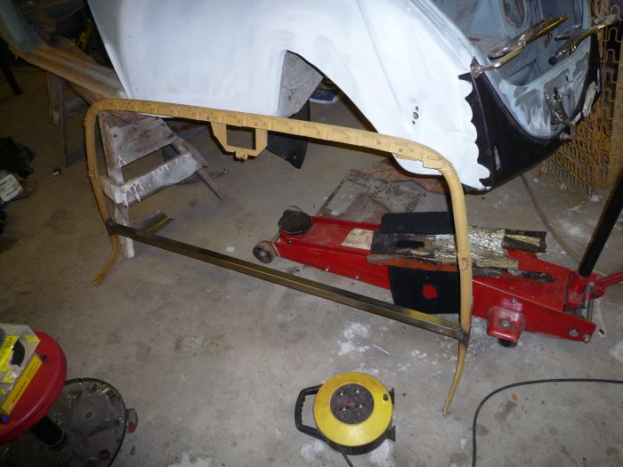

    I have work with my front seat
    i have made middle hinges for the back and cut the back in 2 piecses
    I have to made some adjustments on the hinges on the backs.
    The outer hings points must be change so they work with corct angle.
    I have think to maybe use small ball joints in the outer ends
    like this in size M10
    /Stefan

    I worked little more on my front seat
    For posibilty fell the seat more. I rotated the lower hindge point so the angel is more right
    i adjusted the center hinges on the backs
    I have put screws for adjusting the seat angel
    After the adjustments it was posilble to fell the seat.
    This pic show the seat in upright position
    /Stefan

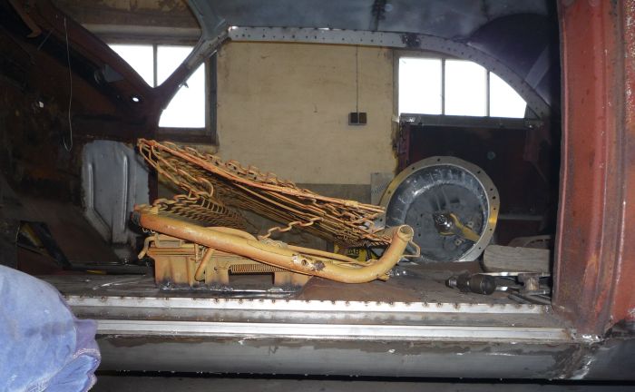

    I lift in the front seat in the car
    The seat is from a 51 and my shoebox is a 50
    the bolt pattern was 100mm [4"] to wide on the seat
    and i must repair the bottom brackets.
    I think maybe to widthen the bracket 2" on eache side so they fit the original holes and lower the seat 3/4" when i change the bottom brackets
    /Stefan

    I have lower and made the bottom brackets wider
    I cut out the footbrackets under the seat so the seat fit
    Test of the seat in the car
    Should i take more on the hight of the seat or is it engout with 20mm [3/4"]?
    That is posible to take some more on the vertical brackets up to the frame
    /Stefan

    I think that with a chopped top you should get the seat as low as possible, I wish that I could lower the seat on my 52 but there is no way to do it and keep the power seat. I am only 5' 7" and still look at the header.

    I cut out 20mm [3/4"] of the brackets up to seat
    So now it's 40mm [1 9/16"] lower than it was from the beginin
    /Stefan
