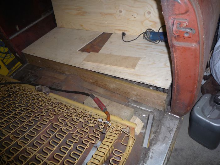

    Now is it time for the rear seat and i don't have any.
    So i think to scratch build it.
    I have bought a 12mm playwood sheet to begin with.
    I cut out 2 pcs and put them up for test.
    Her's a pic with my sister son that sits on old couch cushions for see if the hight will be right.
    /Stefan

    where are his shoe laces? Why don't he have any tools in his hands? Uncles are supposed to be cool and teach the nephews about cars........
    Seat position looks good. Headroom with the headliner in?
    You are getting closer to being able to drive it, I am pretty excited for you.
    Keep it up!!

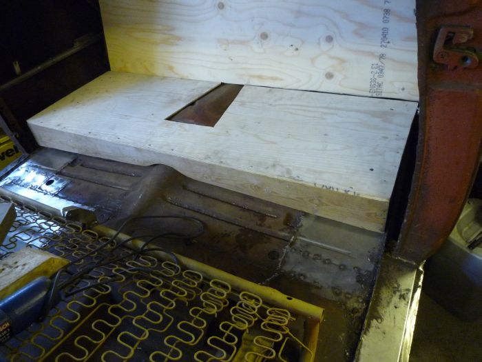

    I have made brackets for the re****at
    I will use one one eache side. they are 5" in the front end and 4 1/8" in the rear end
    And my sisterson have a the oval vw that's is in the background in some of the pics.
    I have help him and he me and i teach him.
    /Stefan

    I have put in the brackets in to the rear seat on the floor
    He bracket ar 5" high in the front and 4 1/4" in the back of them
    and the over parts of the brakets are poseble to lose from the from the floor
    by lifting in the front and pull the seat.
    I have begin to fit a board to the front of the seat. I have begin with a 5"x3/4" borad that was fond in the garage
    /Stefan
