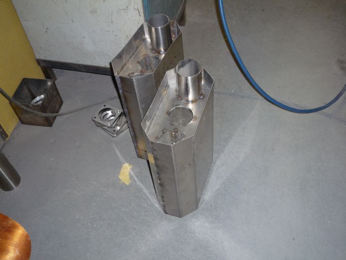

    Her's a little update of the mufflers
    Her's the inner parts of the mufflers
    Next will to put shells on the inner parts
    /Stefan

    How big of an and cap pocket is there going to be? I like the looks of these and they should sound real mellow. The shear size of them and the tube diameter should be more than enough to silence that blown flatty..

    The pockets is 60 mm on the side with the centre pipe and 55mm on the other side
    I have spotweld on of the halfs of the shells
    /Stefan

    Like I said, those are big mufflers for a flatty. Just about right for a hopped up Smallblock chev. So the flow from your blown flatty should make good use of those.
    Don't forget the drain hole. I would hate to see them rust from condensation forming pools settling in the bottoms.
    Excellently executed Stefan. You are an engineer, that is why I knew you had the bases covered.

    There is little more made on the mufflers
    And i will not do a drain hole and they will not rust they are in made in AISI 304
    Stainless Steel
    I have used the same model of mufflers in 20 year on my Olds Cutl*** 66 with a 455"
    and it sound good
