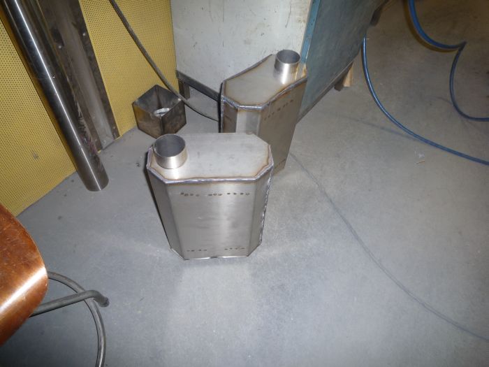

  10. Stefan T
    Joined: Sep 15, 2008
    Posts: 2,165
    Stefan T
    from Sweden
    Thanks for the coment
    Her's a little update of the muffler build
    I have begin to weld the ends of the mufflers
    /Stefan

  17. Stefan T
    Posts: 2,165
    Stefan T
    from Sweden
    Thanks for all the coments i have get this year.
    And Happy New Year to all readers.
    And a little update of the mufflers
    Now are they ready welded.
    and only surfis treatment left and maybe hanges.
    /Stefan
