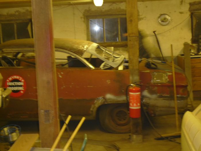

    Her some more testes with difrent angels of the rear window
    first
    second
    third
    forth
    I want to have more opinons of my testes
    Maybe i will chop the rear window
    i think of lower it little more

    I like the third one the best.

    If possible throw car outside in daylight and take some pics, it helps.

    I also think I like the third one. Swedeshoebox- did you chop your rear window area at all? I don't think it needs to be chopped.

    I like the third on best also. I agree with taking the car outside, there is just too much stuff going on around the car to get a true feel of the lines.

    Your fourth version works for me! Remember that the backlight has some crown to it, and actually sits up from the frame once the gasket is installed. I'd dry fit the gl*** and gasket before you deside which version will fly with your chop's flow. Also, add some paper or tape to fill in the missing areas of the Sail panels to help you visualize the line of the chop.

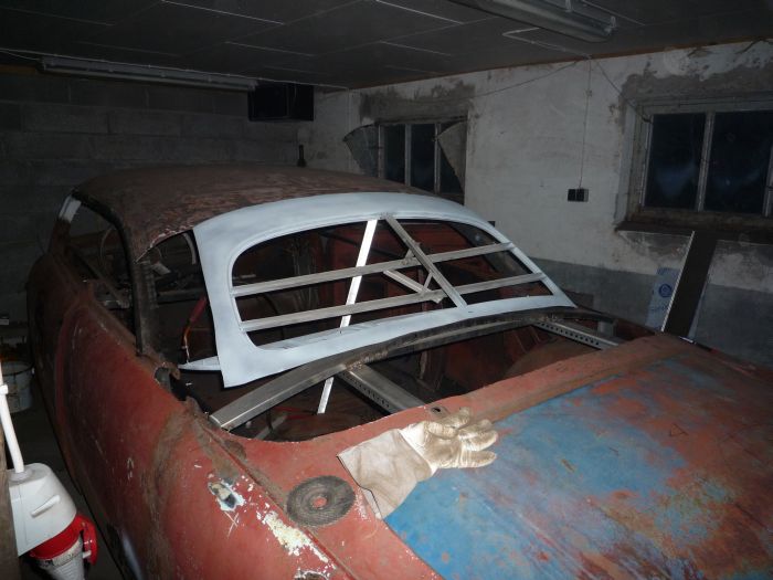

    Her comes some new pics from today i have build for 3 h on before lunch
    My work is closed 1 of 2 fridays becose of bad times.
    so i could work on my shoebox chopping
    I have to lengthen the profile in the middel when i have lower it
    I have put in pisces in the side of the rear window package tray
    so it fits when ist have been moved forward 270mm [10 5/8"]
    I think to have the rear window in this position seams it ok or should i move it?

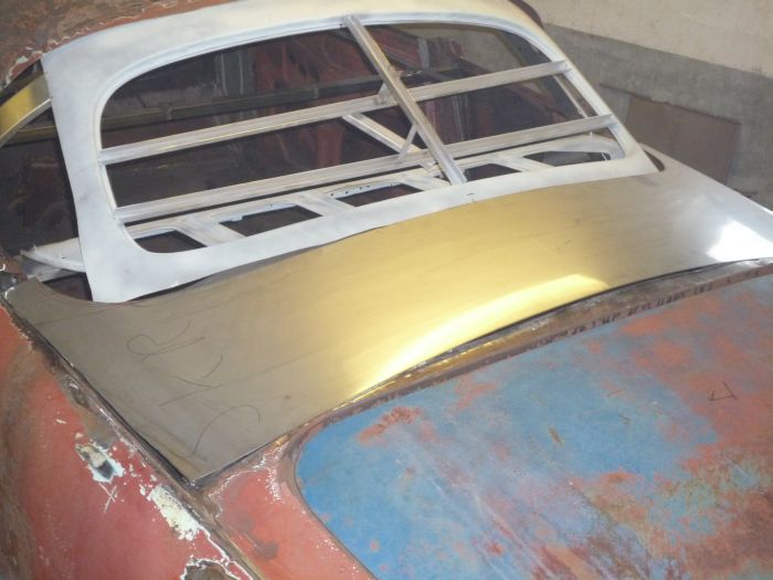

    I have rolled the big panel betwine the rear window and trunk in the english wheel
    The next thing is to weld the panel when it fitts
    More updates next time i will work on the Ford 1950

    I have put in the big piece behind the rear windodw
    I have attouche it with all my sheet metal locks and some welding pliers
    Now it is ready for welding
    welded and time for grinding
    My sister son inspect the work i have dome
    next thing is to deside what i should do with rear window for get right shape of the roof
    give tips if i should hold on this place for rear window or i should move it or do somthing eals with it
