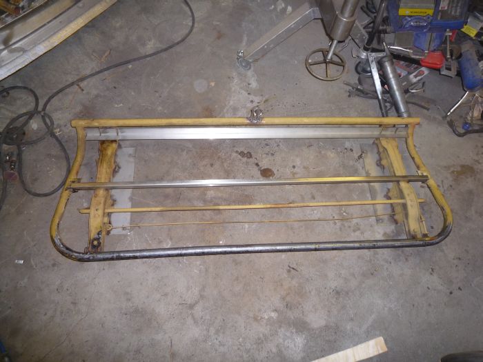

  18. Stefan T
    Joined: Sep 15, 2008
    Posts: 2,165
    Stefan T
    from Sweden
    When i talk with the interior shop and asked about the front seat.
    So he recomend to change the bad springs to foam insted
    I removed the springs
    And scarp them
    After removing the spring and the spring holders put i in a extra profile to hold the seat up and o will put in the L-iron to hold the plywood in the rear end
    /Stefan
  19. Stefan T
    Posts: 2,165
    Stefan T
    from Sweden
    I weld in the l-iron
    And i paint with primer.
    /Stefan
