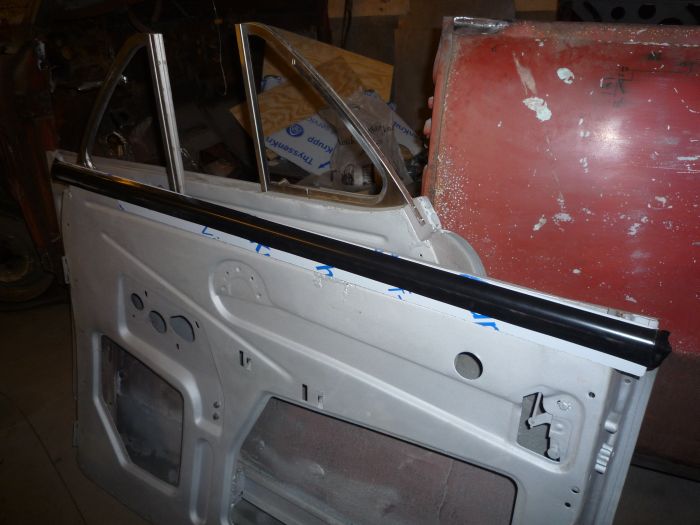

    I have made profiles for the rearend of the door windows
    Her's it monted in the door.
    /Stefan

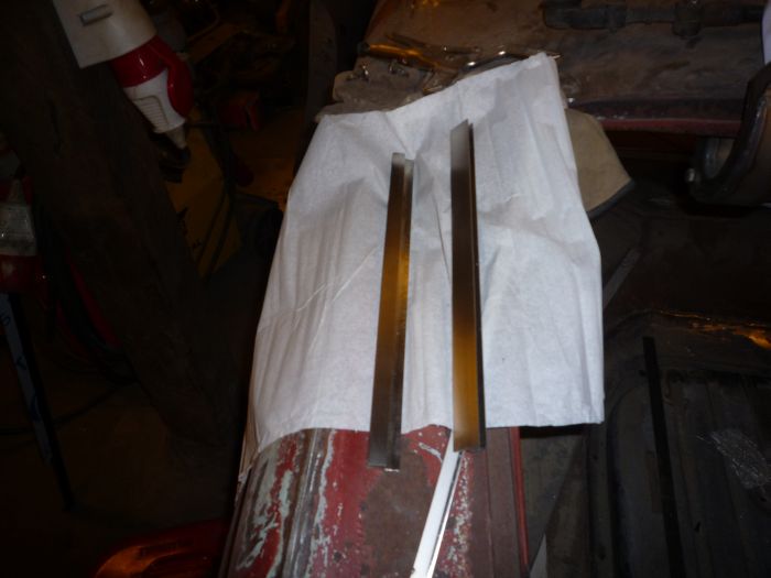

    I have fix some more parts
    Her's the start part for the door garnish modlings
    I will strech it in the front end so it fitt the rounding under the vent window.
    And after the strech will i weld in a plate so the undr edge will be stright
    This will be the weather srip hoder on the rear windows front edge
