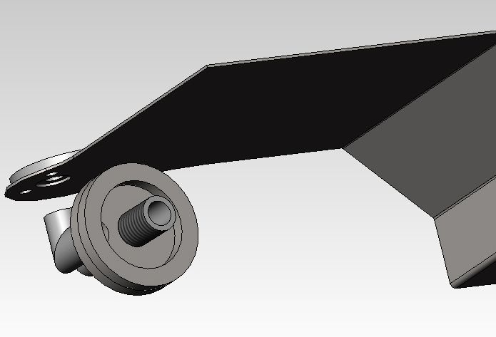

    I have made som parts to the oil filter system to the flathead
    The filter holder for the Honda Civic oilfilter
    The tread for the filter is M20x1.5.
    The filter is have a size of diameter 68mm and a legth of 85mm so it is easy to fit
    /Stefan

  30. Stefan T
    Joined: Sep 15, 2008
    Posts: 2,165
    Stefan T
    from Sweden
    The filter will be on the pressure side and it will go a pipe up to upper oil chanel.
