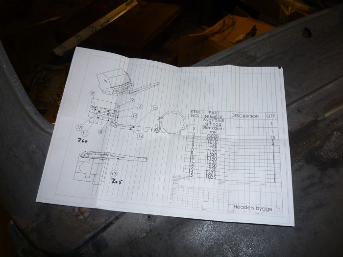

    I have drawn a header to the flathead
    Now it's time to begin to build
    /Stefan

    The drawing

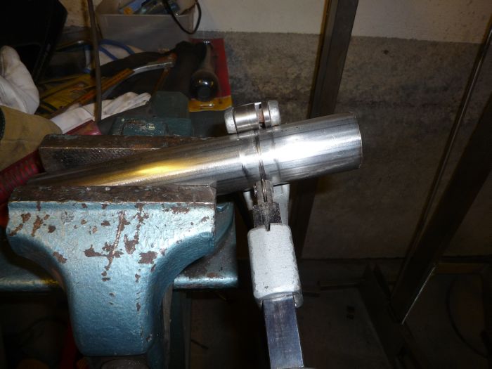

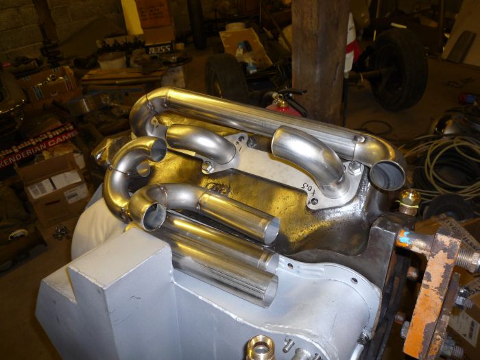

    then is time for cuting pipes
    I spot weld some of the pipe parts togther with a mig with ss wire in
    I shall tig weld them togther but don't have anny in the garage
    Now have i some more parts ready to weld togther.

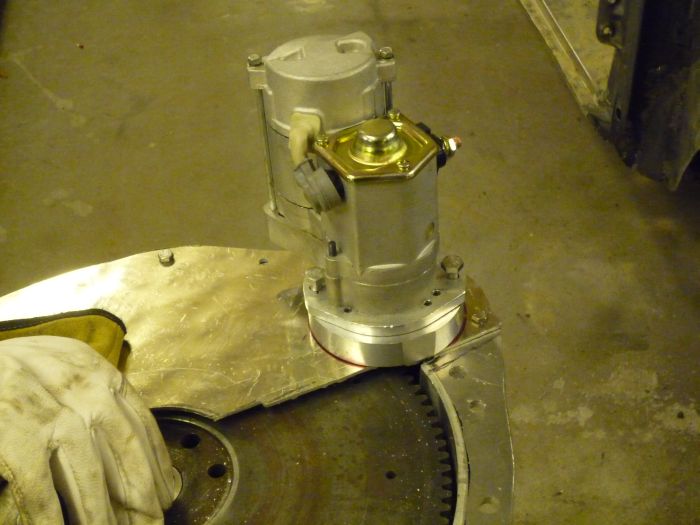

    I need a starterplate to the BMW gearbox (getrag 260) i shall use on shoebox togther with te flat head
    I cut out it in aluminium plate
    I have made hole for the ministarter i have
    I must put in some distances so i aline the starter to the flywheel
    /Stefan

    I have made a distance ring in aluminum to the mini starter
    the total hight is 23 mm of the starter plate
    /Stefan

    Nice progress and looks like you make really decent blueprints too..
    Which i dont do never

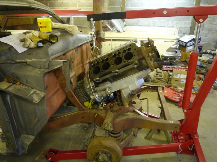

    Time for test of the modified oil pan
    and for see if work
    Down with engine
    There was a one toutch of the oil filter and R/P steering gear
    I must rotate oil filter so i get more room and not toutch the starter plate
    and one thoutch to the gease nipple on both side have to do some changes on the pane in this area
    /Stefan

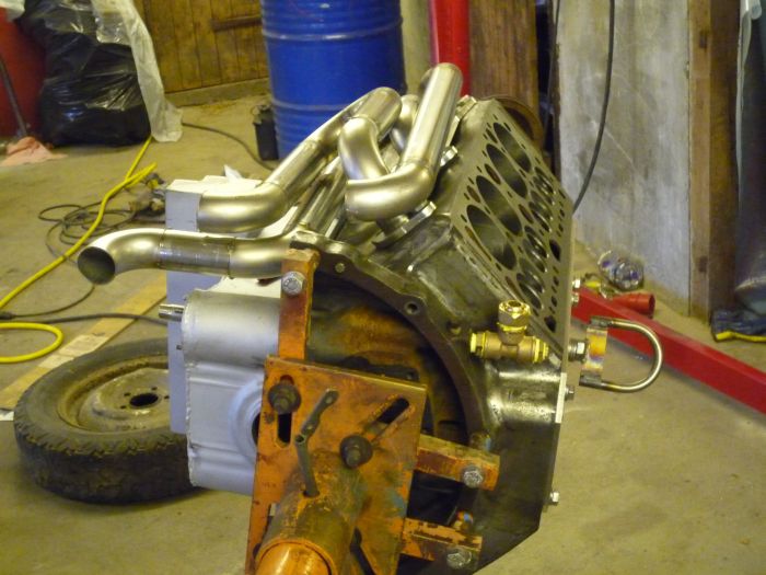

    I were out and worked today with the heades build
    ther's pretty tight to the stearing gear and the stearing shatft
    I have lift in and out the engine more than one time but with new engine lifter
    it's verry easy to do
    /Stefan

    I get limited internet connection and am only on here once in a couple months, so I maybe a little late to ask this question.
    What I am really wondering if that filter is going to impede the volume distributed. I have seen a teaspoon of oil make 80 psi on a gauge but we all know thats not enough to lube an engine. That said, almost every engine runs the filter after the pump anyway, probably a mute point.
    I know you already thought of this and am sure you are going to put the gauge after the filter.
    You always come up with these great ideas and get me thinking. Thanks for the exercise.
    Oh, and don't forget the engine movement under accel with composite mounting. Those tight clearances get even tighter......Once the new mounts settled, if I am in reverse and in a hurry the header will lay against the steering shaft. When I built it I had about 5/8" clearance....lol Now I have to put in some poly mounts or spacers or something..
    -Brant

    I don't know yet if the filter have enough flow but i shall have the oil pressure guade after the filter so that should be an isue
    i are trying to get so mutch clearance as posible for the headers
    /Stefan

    I have assemeble the BMW gearbox to flathead block
    i have made this for test of the starterplate
    Her's the new made starter plate of aluminium put on the gearbox
    The mini starter is tested on the starterplate and it fit like a glow
    Now can i begin to do heaers to this side too
    /Stefan

    I have begin to make headers to the passinger side
    And i must try the new them in the car for see if they fit
    It's not easy to put in the engine block and the gearbox in the car by my self
    I had to remove the steering gear to put in the engine and box
    In place
    I need to do some modificatons on the transmision meber
    now it's modifide i need to grind the welds and drill hole for the rubber buffers to the trans.
    /Stefan
