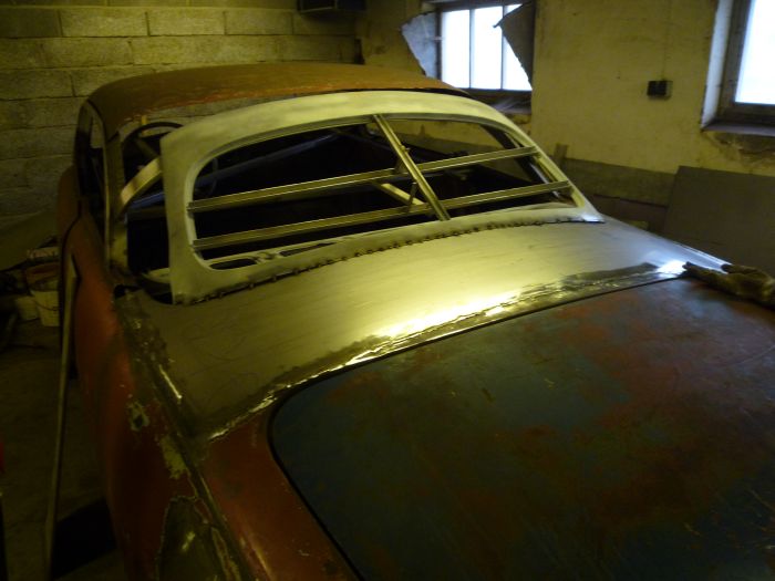

    I have work litle with my shoebox
    The trunk lid have get brakets thats move the threded hols 15 mm backwards so the lid moves forward and up
    I have grind the welds on the big sheet betwine the rear window and the trunk lid
    I screwed bak the trunklid to test of it were better fit
    and i was that but it need som adjustments
    next thing will be the rear window placement
    and maybe i it will be some more pics tomorrow
    thanks for coments and your time for look at my old Ford shoebox
    /Stefan

    Back to the rear window
    Now have i begin to weld the window frame
    This what happen today
    /Stefan

    After some welding it were time for grinding of the new weld in the backend of the rearwindow frame
    the gap betwine the plates were little to big for easy welding and grinding so i have to fill it with weld
    next thing will be to put on the roof on the frames
    I hope you want to see how i will do that.
    I seams not be more done on the until thursday after my job
    I have begin to think of the rear power windows and i have back door window lifters from a Volvo 850 that i will modifi to work on the shoebox.
    Thanks for your comnts
    /Stefan

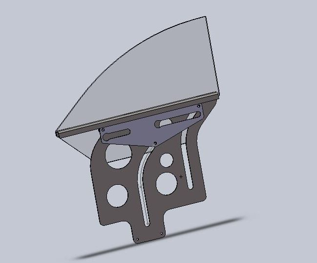

    I can show how i want do my rear side window lifter
    There is 3 plastic bushings thats slide to a guid rails
    The volvo 850 back door sax lifter will be atoutched to the sliderhols
    Do you think is good ide or not??
    /Stefan

    The only problem I can imagine is that the Volvo will have curved side gl*** and the window lifter will make a curve as it goes up. Or do you plan to remake the lifters?

    There is no problems with that volvo have curved glas the sax lifter lift stright up and not moving side ways
    i will not remake the lifter expt i have to grind litle in the end stopper for little higher lift

    Cool! I thought you probably had it all worked out!!:D

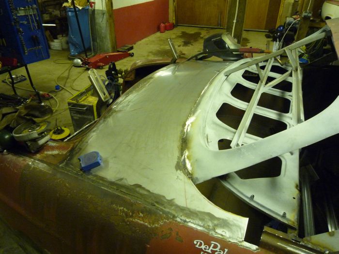

    The roof skin is off
    I cut up my roof skin in peices have it sand blasted and grund painted
    I have cut out 100mm [4"] right over the roof for made it shorter
    must i weld it together. I have a extra front mid part that is little bigger than the original part
    I have put up the roof skin for test.
    I will fillut the middle of the roof skin with a 25mm [1"] plate piece so it will be wider
    I are thinking to weld it down on the floor like the other welds on the roof skin

    I have put togther the halfs of the roof skin
    I will weld it tomorrow i need some help to hold when i do the first spots welds
    /Stefan

    I have begin to weld the roof together
    If it not want to be good i will do a new roof skin in the english wheel
    i have weld and corecting the welds but it have some waves in the roof skin but i'm not ready yet
    the shoebox without the roof skin
    I have spot weld som piceses on the sids to fit the roof skin easer to the roof bows

    The roof skin is up time for welding
    It is not perfect fit in the rear
    the roof skin is to low in the middel but i will high it up for fit
    her have i begin to weld it
    I have begin to fit in the roof skin to the rear window frame
    The front part is welded
    The rear end is now spot welded
    There is some welding and grinding left of the roof skin and window frame
    The next thing is to close the big hols in the pillars and the middle part of the front of the roof skin
