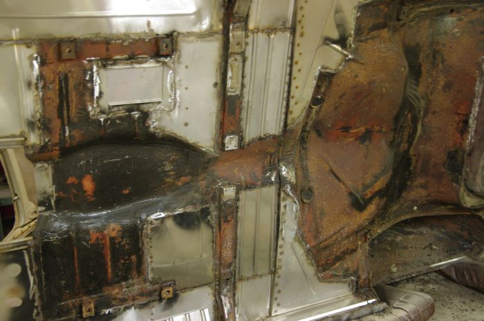

    Her's one of the new floor parts put in place for welding
    Her's both in place and spot welded there is left ready welding and grinding
    I will try to do it tomorrow

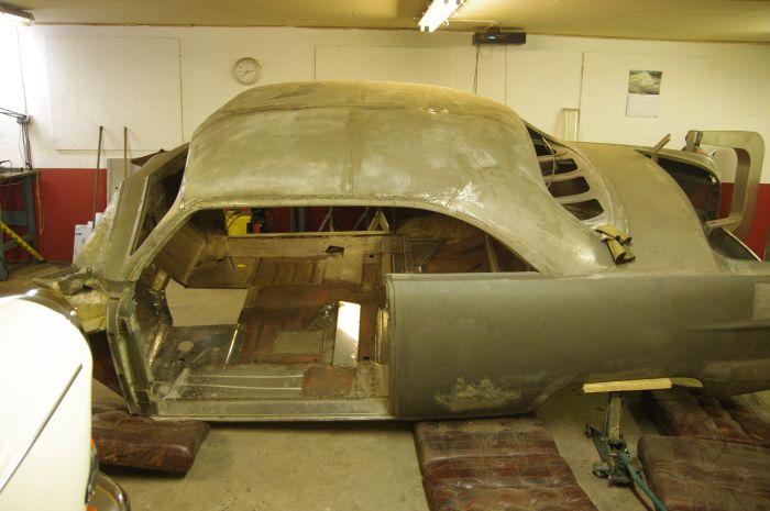

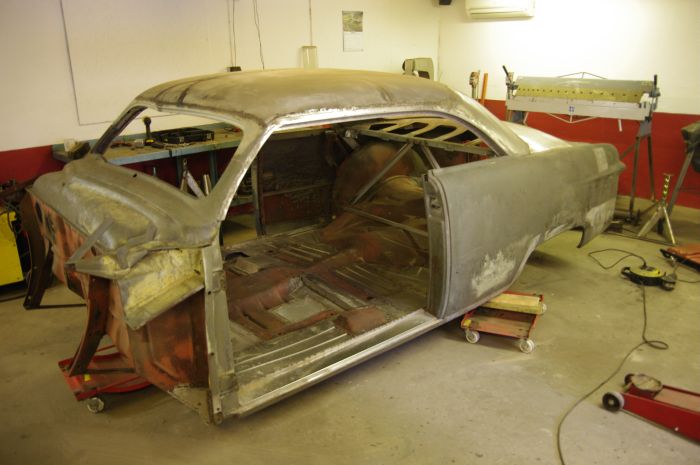

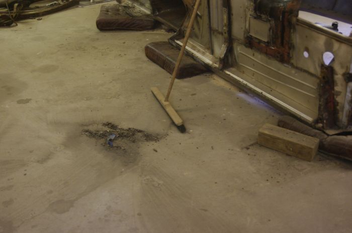

    Now was it time to roll the shoebox over other side
    Her's it down on the floor before it will rolled
    The new changed parts of the floor
    Pillows under the side of the ford 1950 body

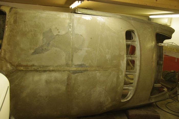

    the shoebox body is rised on high lifting jack on the p***enger side
    Now have i rolled it over to laing on the driver side
    I did by my self this time to and it was easy to do it

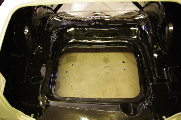

    Her's a view of the bottom of the body from the rear
    the big hole in the trunk is for the volvo 140 tank that are fitted in the trunk floor
    A roof view of the choped shoebox body
    /Stefan

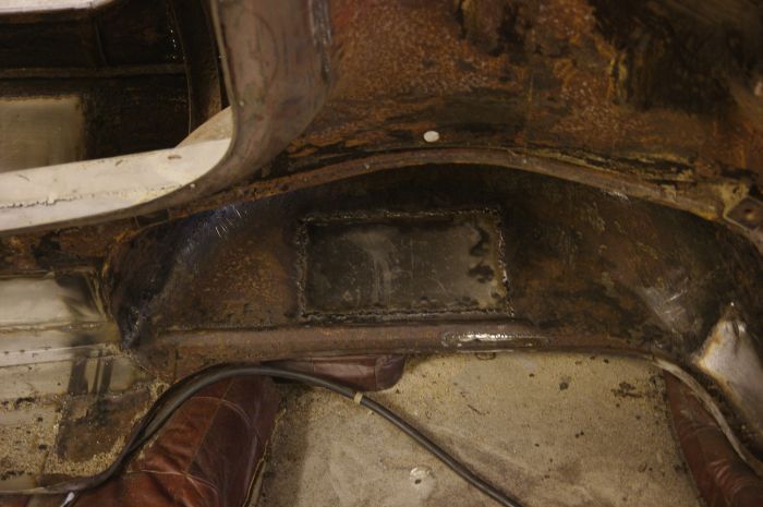

    I have some rost in the wheel house that need a ittle change of sheet metal
    And now it's filled up with new plate and welded and grinded
    /Stefan

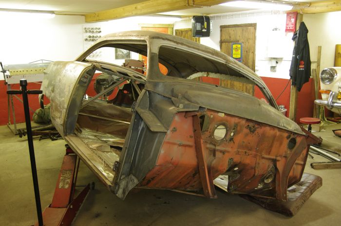

    Time agin for a update
    I had to weld little more on the floor so i need to lay the shoebox bod on the side so i can
    grind abd weld from the bottom
    Down on the floor agin
    I have grind little more on the welds on the side and the roof
    For the moment is the frame out doors on a old tractor wagon
    It shall be sent to sand blasting after the vacation period

    update
    the bottom of body is now painted in black
    /Stefan

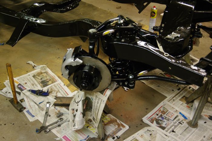

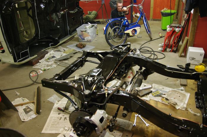

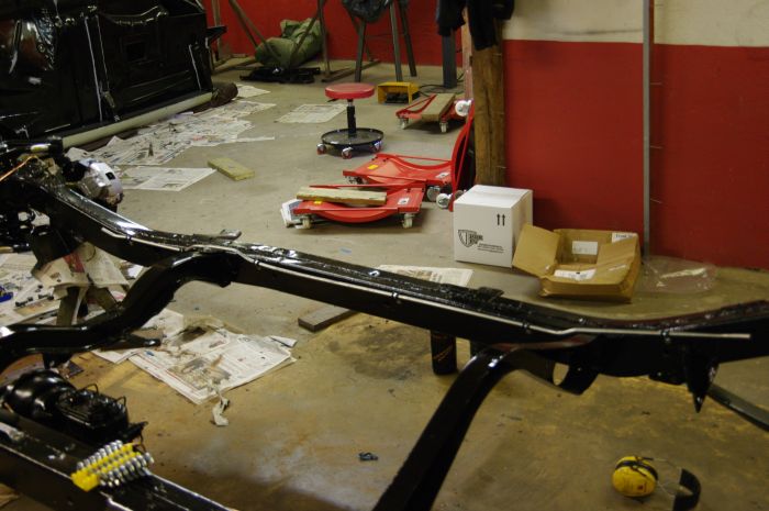

    Now is time for todays work on the shoebox
    the body floor is now dry and all the other things that was painted yesterday too
    the lower control arms from my jamco kit is screw to the frame
    the hard wear that was delverd with the kit was to short so i have to use longer screws
    the stabilations bar from the kit the screws to adpter pates was only 3pcs insted 6pcs
    so i have to use difrent screws to them to
    the long screw down to the a-ars are in shortes model so i shall cange them when i have fix 2
    longer ones insted of the ones yhat was in the kit
    my sister son Andreas is helping me with ***emble the front suspention
    to the upper arms there were not all screws to them
    so i have to use diffent screws here too
    The most of this front suspention will have metric screws insted of the UNF/UNC screws
    the front suspention on the frame
    The jamco kit looks nice but the hardwear that they deliverd was not right to it
    /Stefan

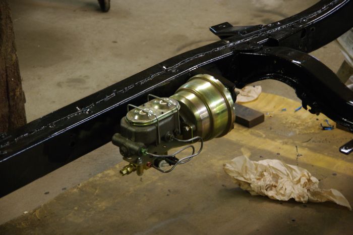

    Update
    The master cylnder and the brake servo is painted black
    now is time for brake pipes
    I have made complet new brake pipes to the shoebox
    The pipes is copper and all is now installed and clamped to the frame
    /Stefan

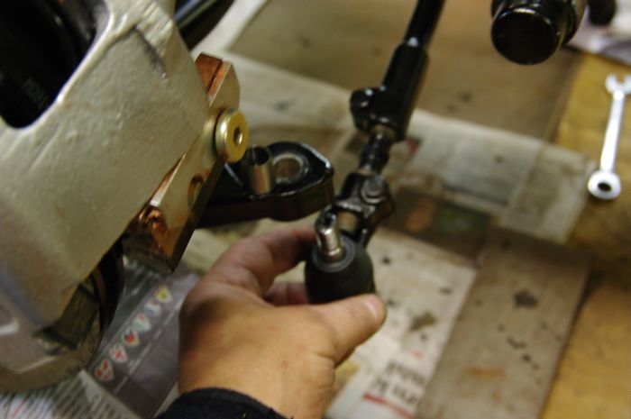

    I have let made som adpters to the steering joints so they fit to the Granda spindels without
    anny problems
    Her's the Saab R&P in place in on the frame
    The frame on is the wheels
    The old Volvo wheels is for drum brakes and don't fit without some fix
    I have grind little on the inside of the rims and put on 5 washers on each studs
    all for this sunday
