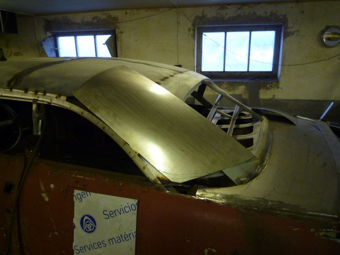

    I have rolled the plates in the english wheel
    Her was test of the plates
    I have to cut them for good fitting to the roof

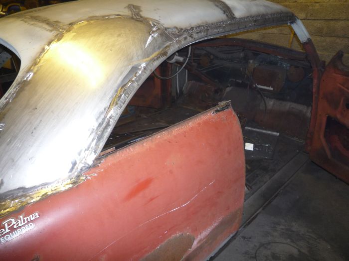

    The first side is ready to weld
    The fisrst side is welded and gringed and now is ther only side left to fill out

    I have weld in the other side now i have only the long weld over the window left to do on the roof

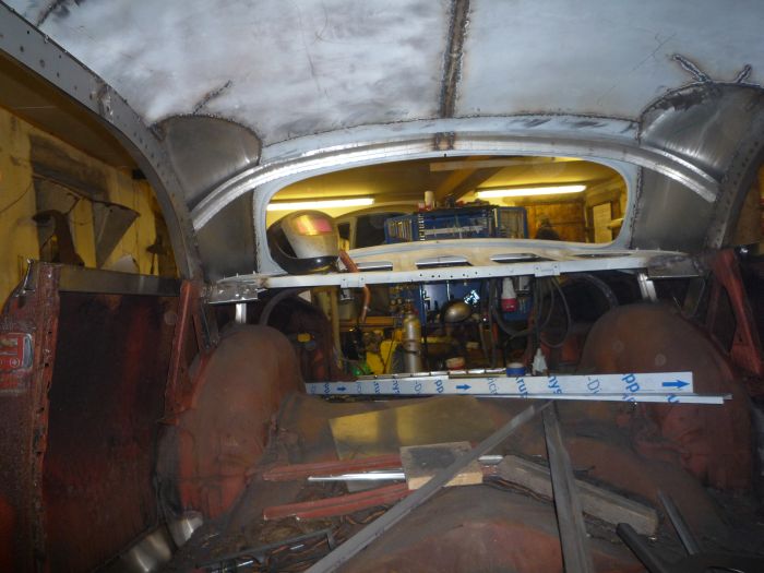

    Her can you see the car from right behind
    A view from the inside with out big holes

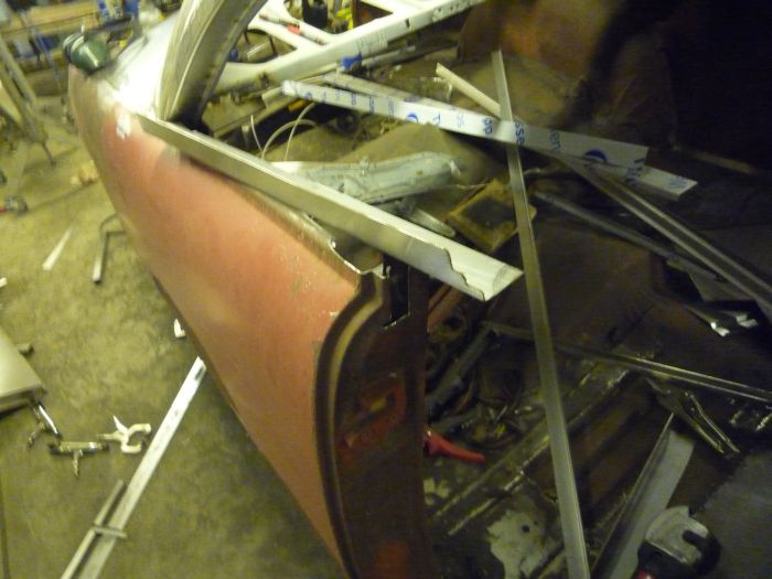

    I have weld the roof ready and now over to the rear side window holes
    I have cut out the edge thats comes up on the lower part of the holes
    Her's a pic of me and my shoebox object

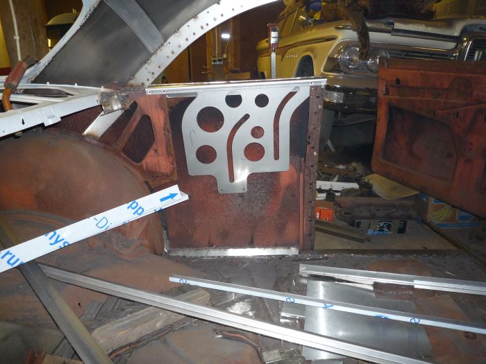

    I will repace the support on the lower part of the rear side window holes
    I have made cut outs for the windows
    The new profile is a 50mm [2"] x 35mm [1 1/2"] 1.5 mm L profile it is long enougt to be weld rear of the the roof supports to get good stabilty to the sides
    Next thing is weld them in

    I have begin to fix the rear side window holes and make place for the power window lifters
    Here have i test the window steering plate
    A test how it fit togther with the volvo saxlift

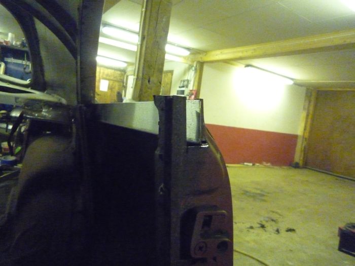

    I have weld in the support on the other side to
    And fill out the hole for the b-pillar
