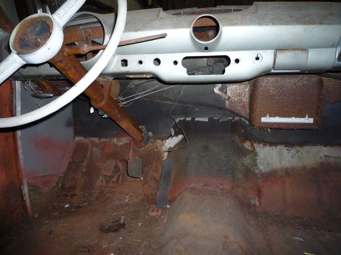

    I have taken some more pic of my floor in my car
    I have made all the plates in the floor including the rockers
    /Stefan

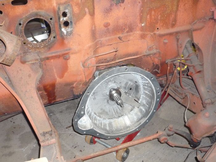

    The flahead together with getrag 260
    I tryed to put in the bmw gearbox to the shoebox
    I have to cut little in the floor to get room for the gearbox
    The gearbox is now in approx. in right position. I have only put it up on the crossmember without vibrations insulators so i must do somthing with crossmember so i can fitt the rubber insulators

    The clutch is a chevrolet with 10 splines and throwout bering is chevy too
    The mecano will be like the original ford , the support bering is a standard metric 12mm id bering

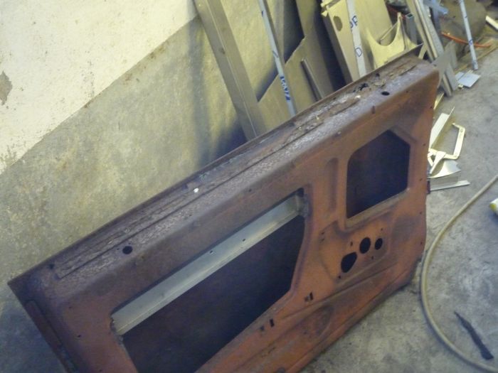

    I have begin with the bad bottoms of the doors
    I have cut out the bottoms on both doors and repare the supports
    I have taken chemical rost remover on the inside of the doors i have think to sand blast all the car to the sommer or spring when the whether is ok for doing that
    /Stefan
