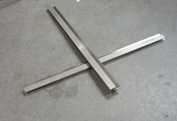

    When you do the steering, if you do not use the stock spindle tie rod location and you end up building another steering arm. The correct geometry is figured this way.
    Locate the plane intersecting the upper and lower ball joint. Do this on both sides. From here a line to the center of the rear of the car right above the rear axle. This will make a "V" that starts in the rear at that central location and intersects the Steering Access Inclination line or SAI, between the ball joints of both sides. The tie rod location should be in this "V", either in front of the ball joint plane or behind it. Obviously the rear intersection points will be narrower than the ones in front.
    Just my 2 cents. I love this project.

    Jaws i shall think of that you say. i shall maybe use shorter steering arms on the r&p with a part on the middle on r&p to move them out to not get bumpsteers

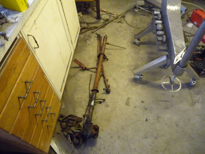

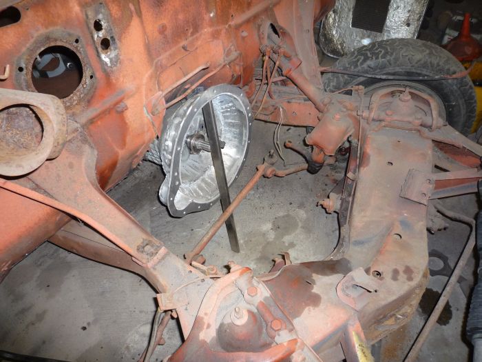

    I were out on the shop today and work little on my shoebox
    i have grind the gear box cover and begin to remove the old steering from the front suspention
    i will remove the old steering for see if the new fit in palce
    /Stefan

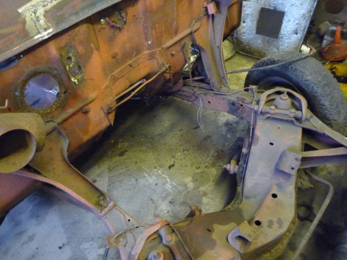

    I were out and work on my shoebox
    I have removed the colon and steringbox and linkage
    Now is the place for new stering system

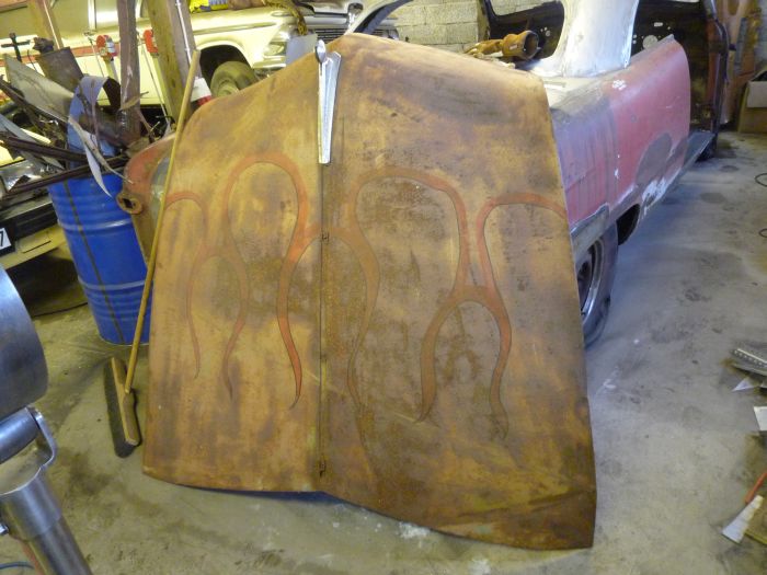

    My hood is not so good so it time to repair it
    It is from a 1949 ford not 50 as rest of the car
    There is some places that need change of sheet metal
    /Stefan

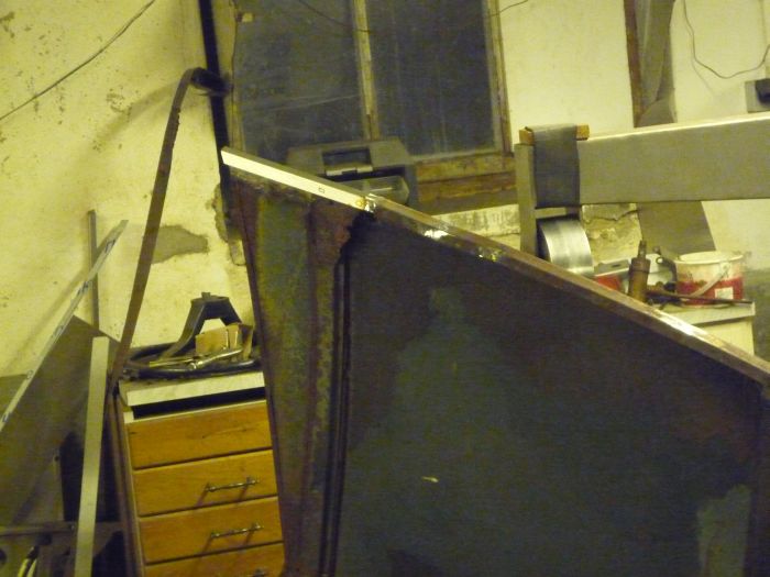

    I have begin to replace plate in the hood
    I have fix the frist bad corner of the hood
    /Stefan

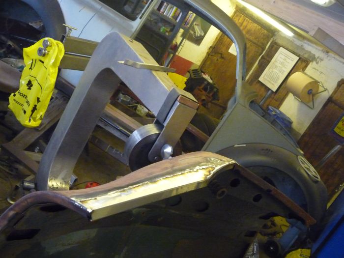

    I have layed little more work on my bad hood
    I have change the right front edge
    So it looks little better from in front end
    I begin to change the other bad corner in the rear end
    and made the parts in front of it after that
    /Stefan

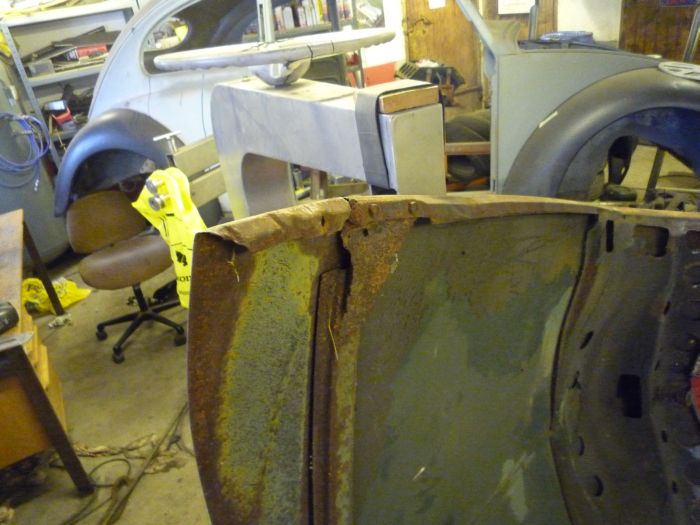

    I can't fix spelling right and wrigting nice
    I have fix the last hole in the hood
    /Stefan
