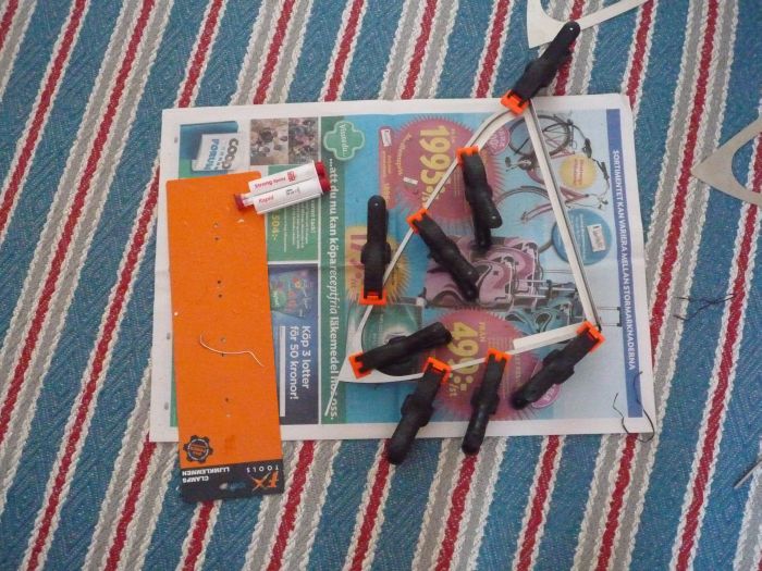

    Her's the parts i must glue togther
    I have to glue one part each time and let it dry
    her's outer bow on first drying
    And after 10 gluing sesions they are ready for newt step but they have to dry totaly berfor i grind and polish them ther will even be a canal to the side winwow grued to the outer bow

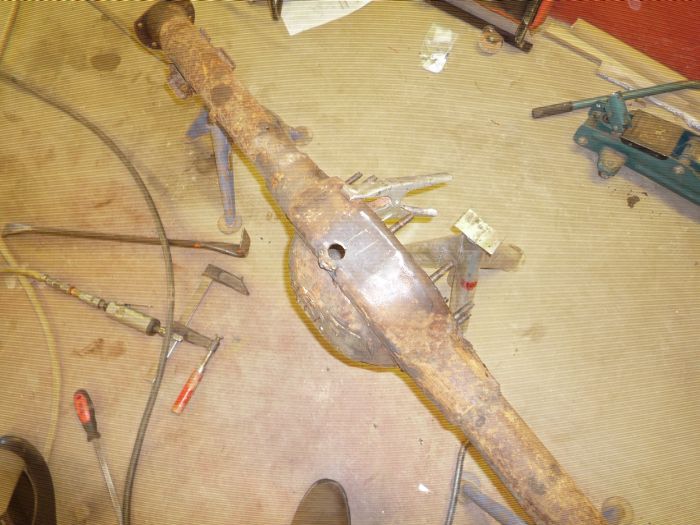

    I worked little with my Granda axle with puting in a abs sensor as speed sensor
    I have made a hole for the sensor ans weld up a bit for the screw to the sensor
    Her have i put in the sensor i use the cronegear as trigger
    I hope it work with a peugoet 206 abs sensor as speed sensor and i have adjust it right

    how many wires is that sensor, 3 or 2?
    Do you have access to an oscilloscope?
    What is the lowest pulse input that your speedo box will work with?

    I have a 2 wire sensor and it make some result on a voltmeter
    I shall test the box with it se if it works with it
    I didn't find my instument with puls counter i belve somewone have lend it to car sound bulding

    2 wire will be great. The AC pulses as long as they are far enough apart to count as a pulse should work fine..

    Can you explain a little about glueing the stainless parts together? I suppose it´s some kind of industrial strength glue?

    I have used transperent epoxy glue but it not the best strength and it have a tendency to lose
    i belve sandblaster the parts before glueing would make wonder
