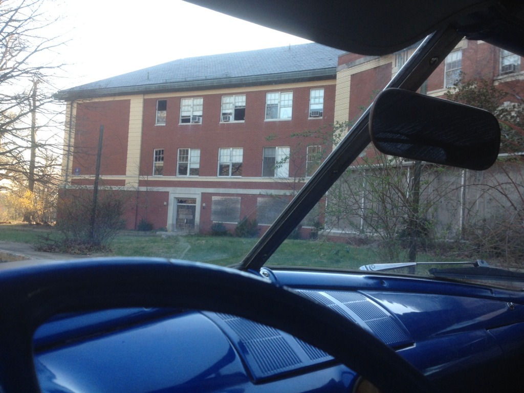

    Haven't posted in a while so here's a few shots.
    Asylum firehouse in North Jersey
    It's was 30 when I took these this morning on the way to work.

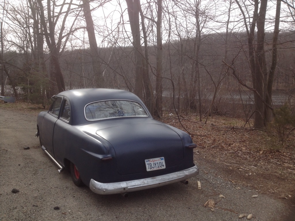

    On the way home a lake in Montville.
