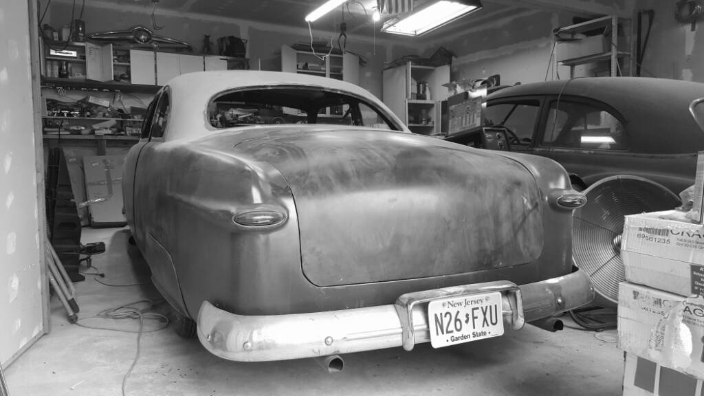

    Sneak peak decided scuff the whole car and spray the gallon of what I have and debating on doing a little flake on the roof
  16. Buddy Palumbo
    Joined: Mar 30, 2008
    Posts: 3,871
    Buddy Palumbo
    Ooh , ooh ... I like it !!

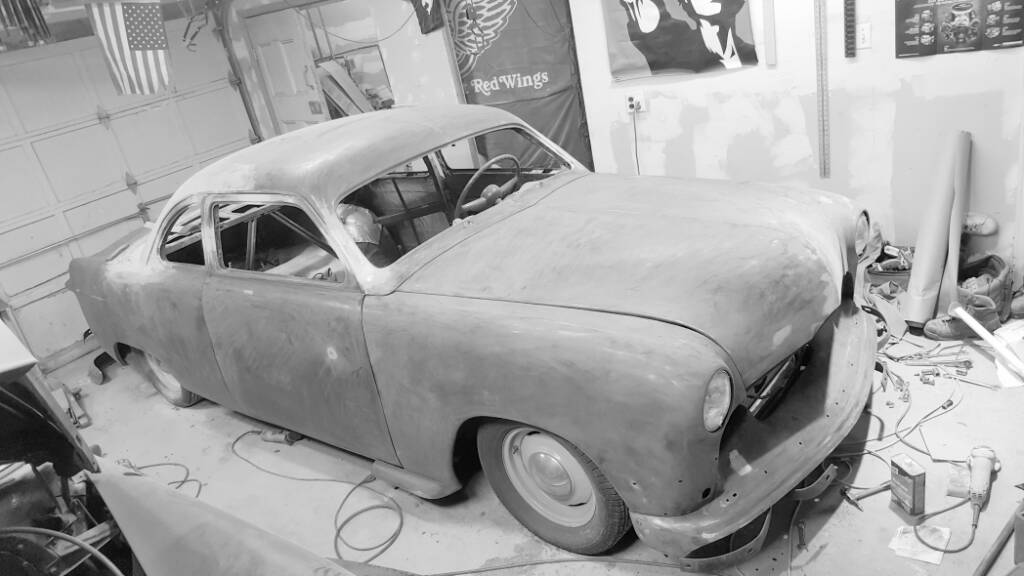

    One of the other side

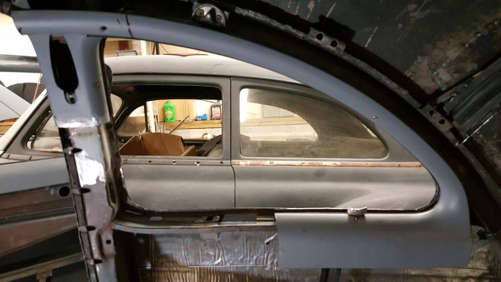

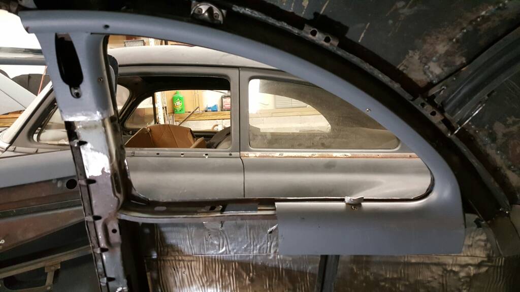

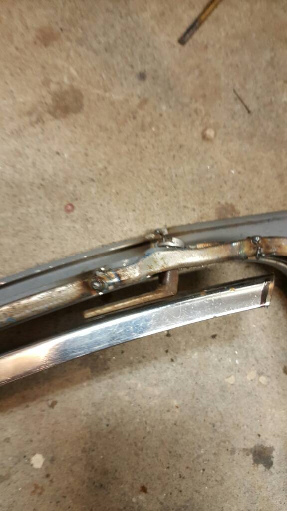

    Step one mark where to cut. Step two cut the top pivot loose. Step three remove seal channel split piece. Set into place to mark where to trim. Pieces trimmed ready to weld. I'll take pictures of doing the stainless tomorrow.

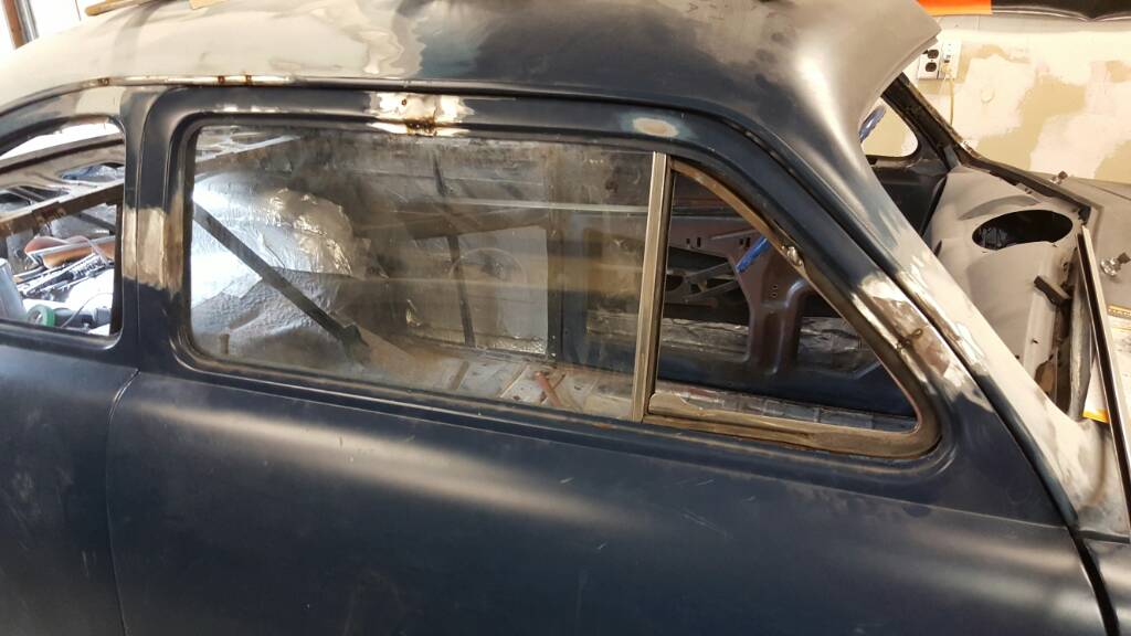

    I did the stationary windows that business coupes have but decided to use the club coupe windows instead. Why do it the easy way.

    You'll be glad you have the tilt out rear windows ...

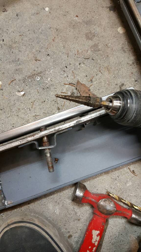

    First useful part I made in machinist cl***. Now I no longer have a squeaky belt when i first started it up!

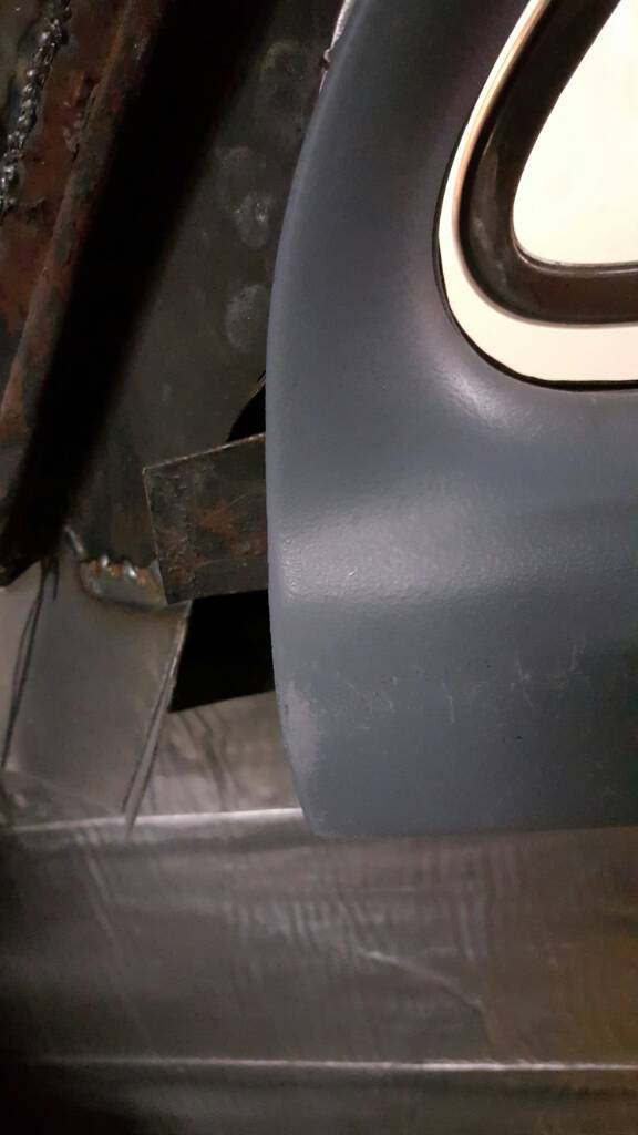

    Just noticed one thing.I guess you have to add some sheetmetal to the back corner,i am sure that there will be a small gap between the headliner and lower part of the garnish moulding without the extra stuff..

    On a coupe there is a little metal tab that sticks out on the back of the lower corner. I was going to just make the piece a little longer and so its closer to the package tray.

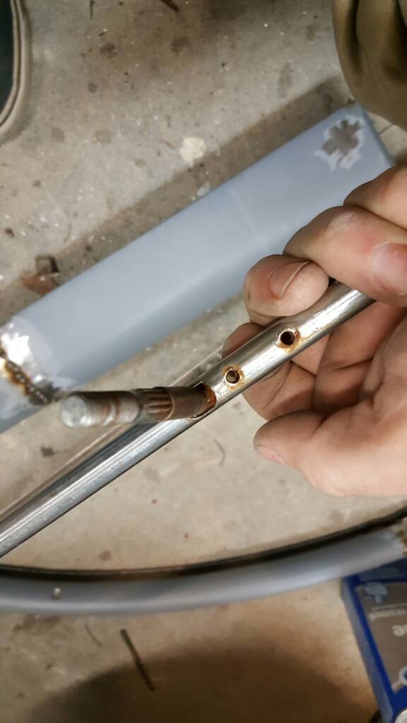

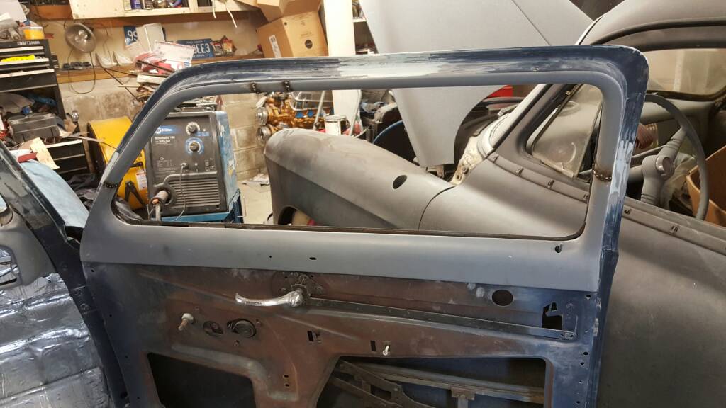

    Remove rivets to relocated upper and lower brackets. Club coupes are different than sedans fyi. Cut stainless to fit into frame. Drill hole for bottom bracket. The bracket slips in from outside up into hole. Reattach the top pivot to line up in both the car window opening. Put top bracket in and mark to drill hole. Open to see if it clears

    Finnrodder here is the tab coupes have to hold the headliner on the side by the window. Mine was a business coupe with stationary windows but they were missing when I bought it. It just had the smashed trim pieces in the trunk and a set or pop outs missing pieces. Guy said it had pop outs in it when he traded for it but it was missing the pieces to make them work and they were glues shut and in trunk too. Also the rear package tray was cut out and some random seat that was way to big for it out of a 70's something set in place. Someone gave me a 4 door seat so I modified it to make a club coupe seat since I couldn't find one. I'm barely over $5k including car so I am happy still. I do plan to blow it a part and have a nice paint job on it some day. Until then I'll use the paint that one of the workers of hot rod flatz gave me when I bought a gallon and it was not what was on the label and he gave me a few gallons of it at the ponoma swap meet. So the decision is midnight blue pearl or white or custom mix and make something from both till I blow it a part.
