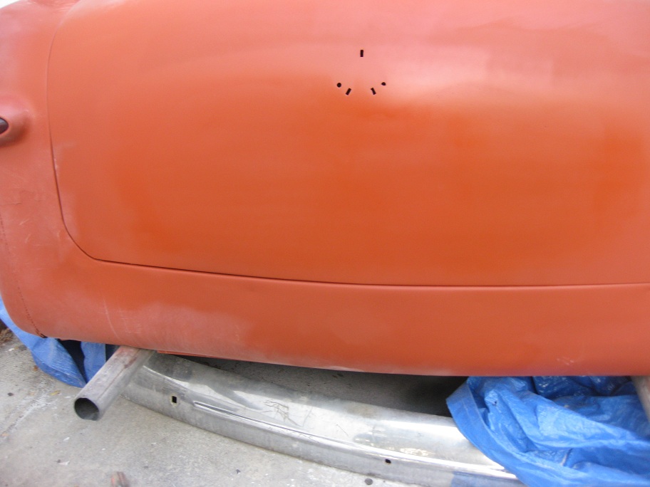

    Shaved the p***enger side door hand and lock also the side trim holes. I used the metal left over from the door I cut up for the patch on the driver side.
    Threw some primer on it because I picked up some side work for the next few days. Oddly enough doing doors just the wood kind.
    Threw some primer on her *** too. I am really starting to dig it without the bumper. I was thinking of lowering the bumper and mold in the exhaust with some round stock I have left over from a project before the lay off.
    Yes I have a garage but this car has been 100% built in the driveway like in the old days. I have the sunburn to prove it.

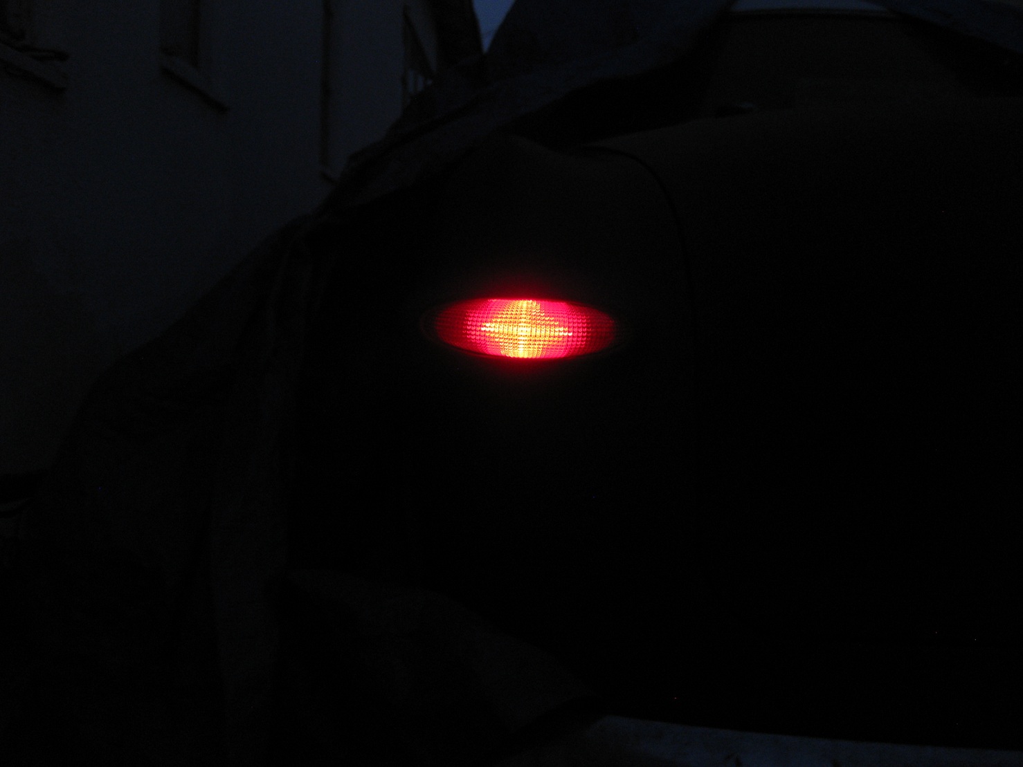

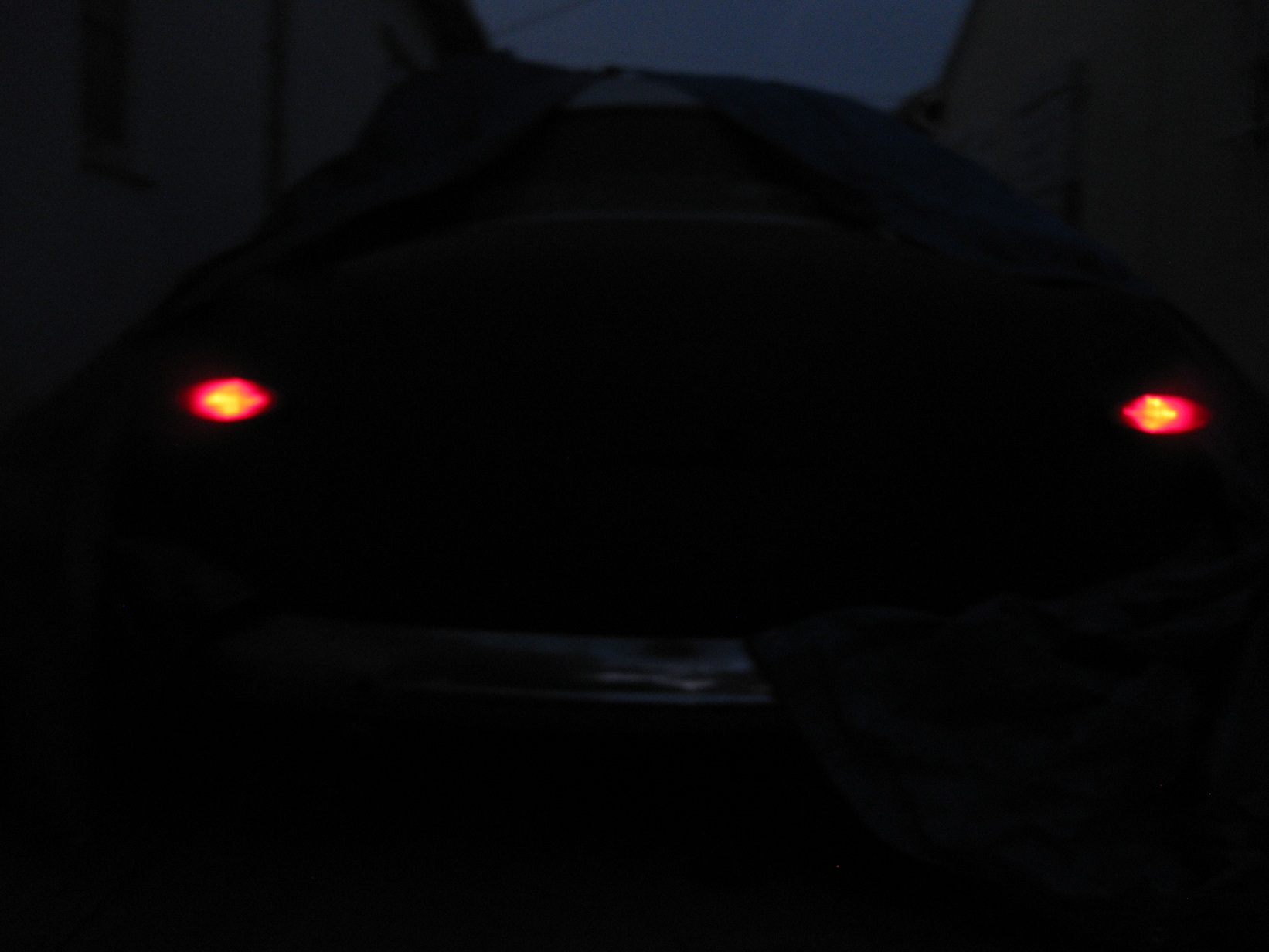

    I really dig the Bubble Lee tail lights.
    no not a lincoln symbol but yes I am running Lincoln hub caps.

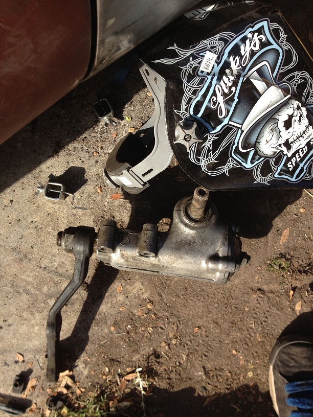

    Look what Santa Fed Ex brought me today. The Volvo 140 steering box everyone is always looking for! I can't buy the stock rebuild kit for what I paid thanks abc auto parts Inc in CO!

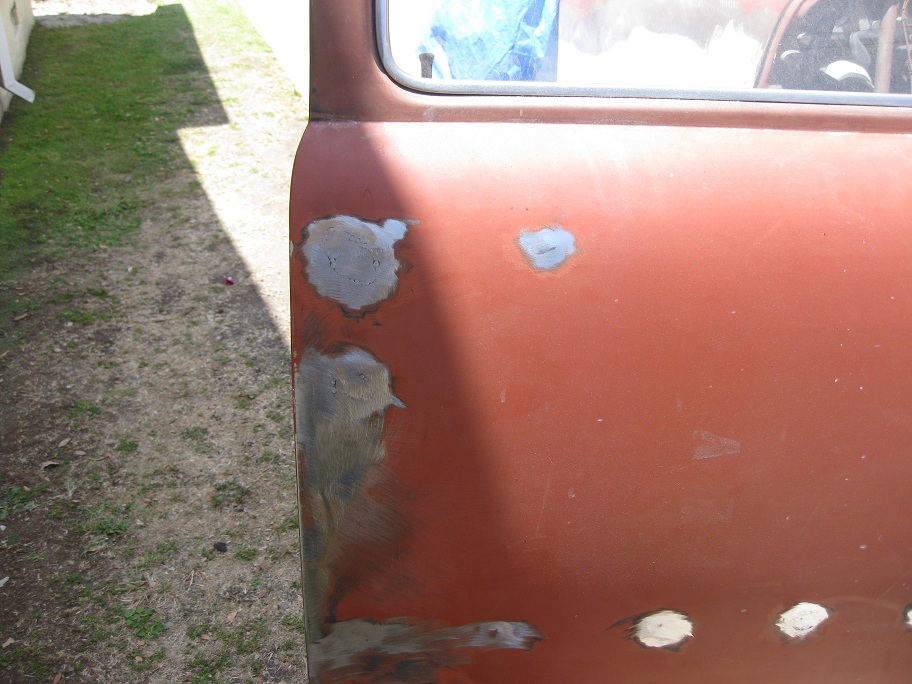

    Can't say I was happy to find a 1/2" of bondo in the lower part of the door
    This is how I make my rounded corners so if you don't buy TRC for Brad Masterson showing you so this way here is mine. I do mine in two pieces out of 18g. I bend the very top to match the bend right before the rain gutter.
    I do marks to line up the inner piece when I'm fitting them.
    Here's with the corner cut off. It's pretty easy to do I matched the top rear radius of the window of the door. One of the easiest Kustoms tricks to do.
    On a side note I do finally have the doors both fitting really nice. I am getting alot happier with the gaps. I refit the p***enger side and drivers side fenders and they look nice. Hood is getting there. I have to decide if I am doing stock 50 Ford grille? I do have a 51 hood that I was given that the person was trying to make a 49 or 50 hood and cut the piece off but luckily they saved that piece so I am going to weld it back on. I have the ultra rare Kaiser Allstate grille sitting in the 53 Henry J. I have one full grille plus a half of one I could do a 3 bar grille? And also a 51 HJ early 52 Vagabond grille.

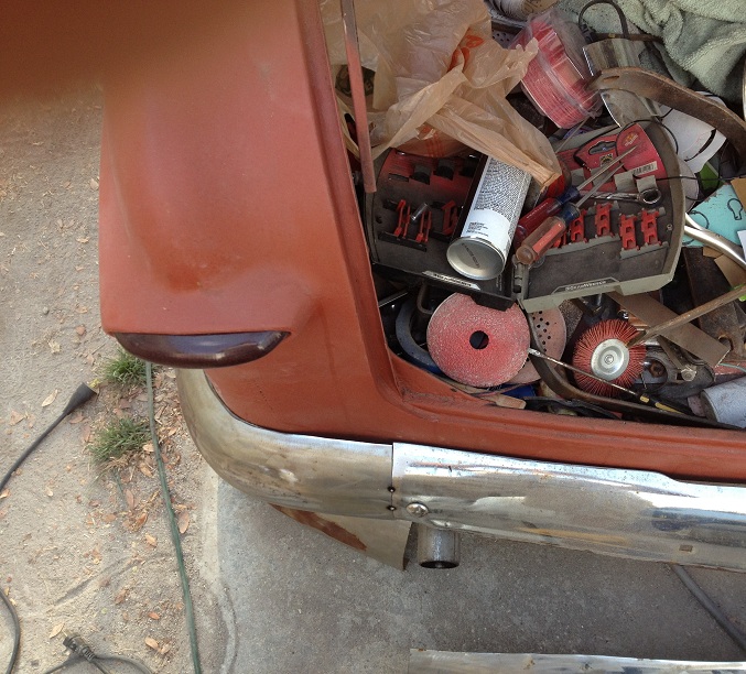

    So while it was rainning in LA. I know what the hell rain in LA. Anyways I was in the garage messing with the Kustom bumper I am thinking of using. This is it on the car between rain drops. Shoebox guys give me your thoughts since you know what the stock one looks like with the splash guard installed.

    Thats not a bad idea.I havent seen anyone done that kind of "wrap-around" bumper to shoebox.Its refreshing to see something new for a change.

    I'm on the fence with the flush bumper . I like the wrap-around style that contours to the body , but it almost seems like it needs a little separation and a small splash panel . Either way , kudos for style & execution .
  24. daddio211
    Joined: Aug 26, 2008
    Posts: 6,012
    daddio211
    I think I figured out what I dont like, I think its too close to the car. Just 3/4" would make all the difference in the world.
    Of course, this is only my opinion. I just think it being SO close its missing some personality.

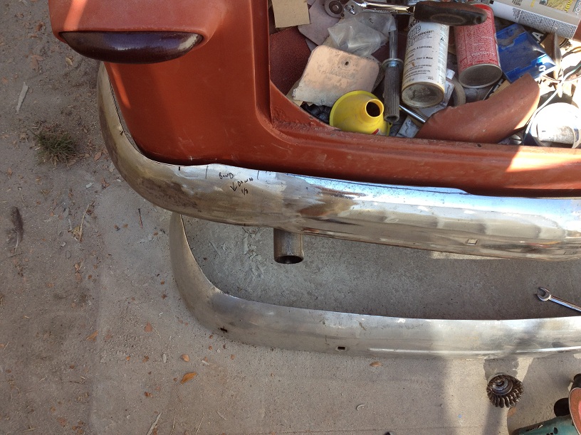

    It has about a 1/4-3/8" gap now. I was thinking of opening it maybe a little bit more. Here is the other side tacked in place still needs to be bent into shape and the bottom pie cut to match them together. I am thinking of removing the top middle part to be straight across. which would open the gap in the rear a bit too. It looks better in person than in pictures because of the rust on the bumper.
    What about lowering it an inch? I would have to cut the bracket and radius the bottom some for the exhaust.

    I wouldn't lower it any, it'll make the back of the car look way too tall.

    Here's how it looks from above. This is the peak. Also I forgot I traded the front bumper away and this is the rear. I am debating on cutting the little extra piee off the indent for the license plate or I am thinking of having the plate come up from below and slide back in at shows.
    This is it space out a bit more I think i might go this way I am liking it more way.

    It looks better sitting away from the car a bit , but being so much closer to the body than stock , the gap has to be PERFECT all the way across to pull it off . Keep tweaking it & you'll be good to go .
