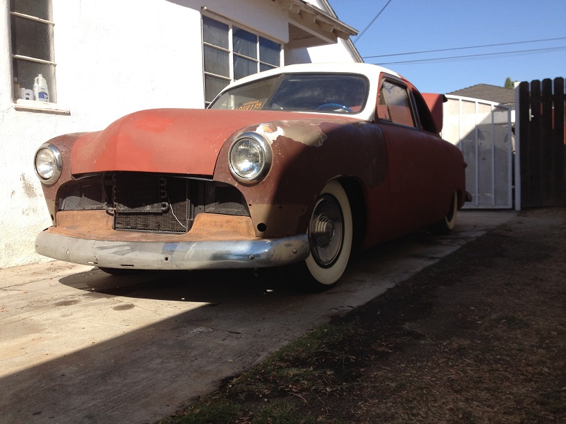

  3. Mr.Dickies
    Joined: Jan 23, 2007
    Posts: 664
    Mr.Dickies
    Hey Buddy how's this?

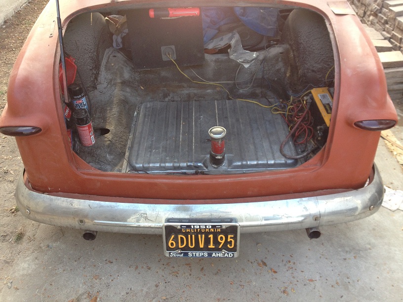

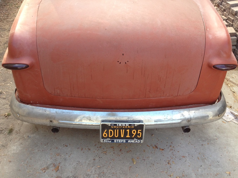

    Put the stock bumper back on got pulled over today becuase they couldn't see my license plate and I wasn't done with the 54. Cop got me in the parking lot of the auto parts store took my license and said he would be back in 15 minutes if I had a light on the back he wouldn't give me a ticket well long story short he never came back and brought it to my house 2 hours later. I waited for an hour there. Also a friend of mine past away and he said the last time we talked how much he hated the bumper so I have to decide what to do I might do his thought as a tribute.
    Moved the trunk latch to the bottom
    Made brackets to monut the stock latch on the trunk floor and ran a cable to release it. Non-power so if the battery dies I can get into the trunk to jump it and open the doors.

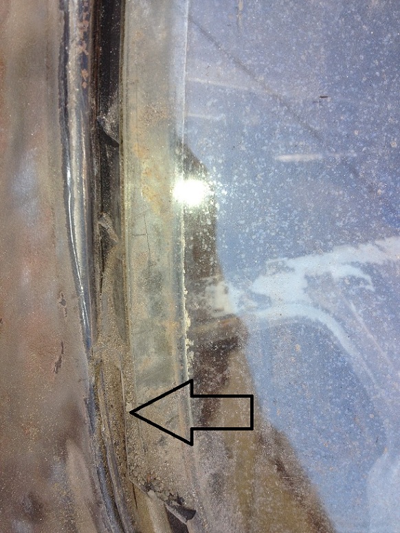

    SO I am about to tackle the roof work and find something that doesn't make me very happy. Who puts black tar and plumbers puddy in rust holes then puts a new gasket on?
    The whole window channel had dirt in it. No wonder it was so rusty.
    Started to cut it off hope this was the worst of it. Think again
    This is one hole that had black tar in it under the gasket.
    This just shows how much dirt was in the between gasket and window.

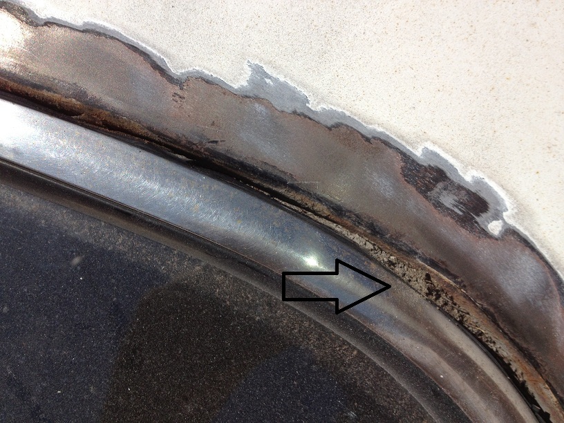

    That isn't white paint it missing metal. Not making me very happpy right now.

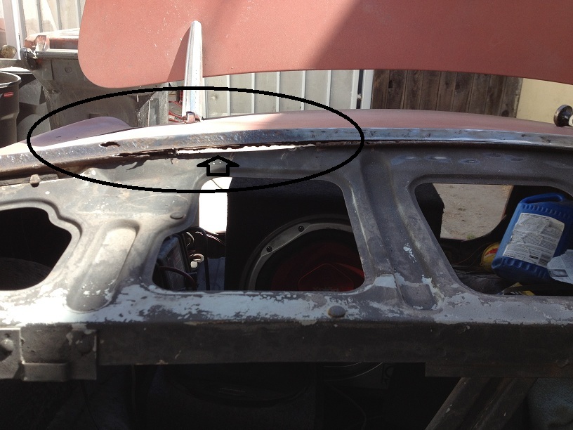

    Top is missing metal too!
    Another view.
    Does anyone ever feel like they bought a parts car sometimes? I did know it was a R@T RQD when I bought it and wanted to save it. I just feel like sometimes it is putting up a huge fight.

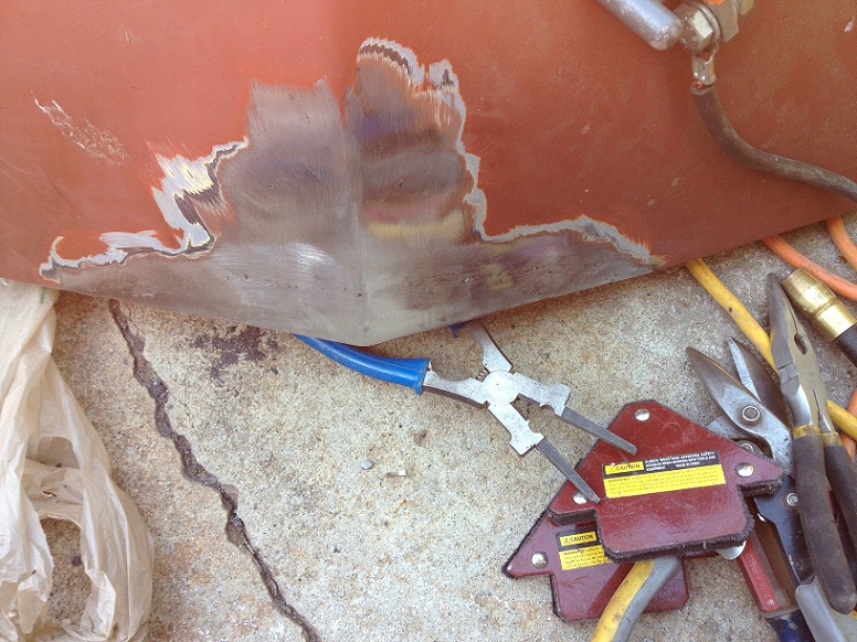

    Mr.Dickies
    All patched
    Patch piece
    Needs a tad bit of grinding. I am going to do it in sections.

    Mr.Dickies
    Repairing the upper window bend.
    First step cut strips. Used the left over door skin for it.
    Break the metal as tight as you can get it.
    Put it in the vice to close the gap to match the original
    And then bend over the top to a 45' or so. I just hammered it over the edge of the vice.
    I then used the stretcher to match the curve of the window
    Welded in
    Spots ground down to look factory
  14. S_Mazza

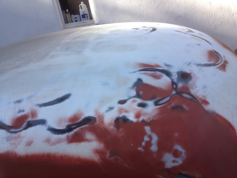

    So I removed the 8 layers of high build primer. I was starting to think maybe of blasting it but now that I am done. I am pretty happy. Neighbor came over called me a MF'er said he would show me what noise really is and that he would make me sorry. Cops show up 45-1hr later. It was Noon by the way no not midnight but NOON. So they asked me to continue doing what I was doing busted out a sound meter told me I can be 3/4 louder than I was being before I get in trouble. So I said all he would have had to do instead of cussing me out was ask me to keep it down. Instead of knocking off at 1pm like I had planned I continued to go until it was striped. So 2 hours later I almost have a car that is all the same color for the first time since that day after I bought it. Next Monday it is hammer and dolly time to remove all the dents out of the roof. The primer was hiding alot.
