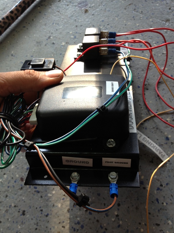

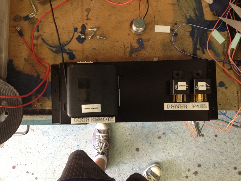

    Anyways bored to death I made this since I can't hold the dolly yet. It's the remote keyless entry bracket not exciting but kept me busy for 15 minutes.
    I am going to rewire the car while I am recovering. Outer stitches come out next week inner ones dissolve.

    So out of boredom I made the bracket for my keyless entry for my door solenoids and wired it up minus to the doors. I'll do that once I install my new wiring harness. I'll take a picture of what the wiring looks like before and after. It's a rats nest for sure. I am just biting the bullet and rewiring the whole car while I can't do***** with my hand.

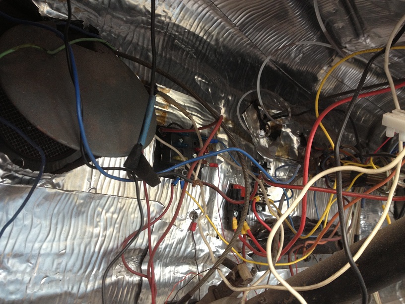

    Started to take a part the rats nest after getting my stitches taken out.
    From this
    Made the bracket so the harness doesn't sit right against the firewall and with 2 bolts can be taken off and seviced if needed.
    I'll take pictures along the way to help people out. Pulled the rear wires up the A pillar to the rear of the car. That wasn't fun before there were only two wires not the 8 it has in there now. Thought for an hour it wasn't going to make it. More tomorrow!

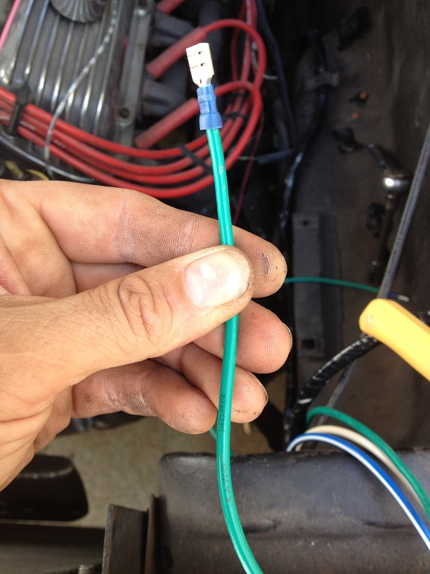

    The way I wire a car might not be the same way the internet experts that have never built anything say to do it but it works for me and the people I have showed. So here goes I'll post the pictures over the next couple days as stopping to take pictures slows up the process.
    I take each area at a time. First I pulled all the wires to the spots they go( front to front, rear to rear, Dome lights to middle, Dimmer switch to front floor,ect) After I get the areas pulled I split each branch to the side they belong (Left or Right).
    Starting up front I split the low beams to a left and right side I shrink tube them after I split it off over the connector. It looks like a "Y" Some harness' come with them pre split this one did not. But for $149 to the door I won't complain. The group that comes thru the firewall is front lights, coil, tach, battery, ingition, starter, alt.
    I plan to run a horn relay so I branch it out and run it back up to the firewall it will make more sense once I add the relay.
    Split each side into a branch
    This is the Driver/ left side branch. It is the high beams, low beams, parking lights and left turn signal
    This is the GM switch that plugs into most universal wiring harness. Don't ask the Pep boys workers questions just tell them it's for a 66 Chevy C10 less***** they have to say it's not in the computer about.
    For the 50 Ford the bump fits the dimmer and plug without having to cut the wires or change anything and you have a part that is $5.99 and should be in stock at all auto parts stores.
    I also ran the alternator wire to solenoid and solenoid to starter and battery wire to trunk and main power from solenoid to panel.

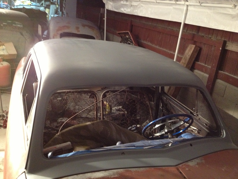

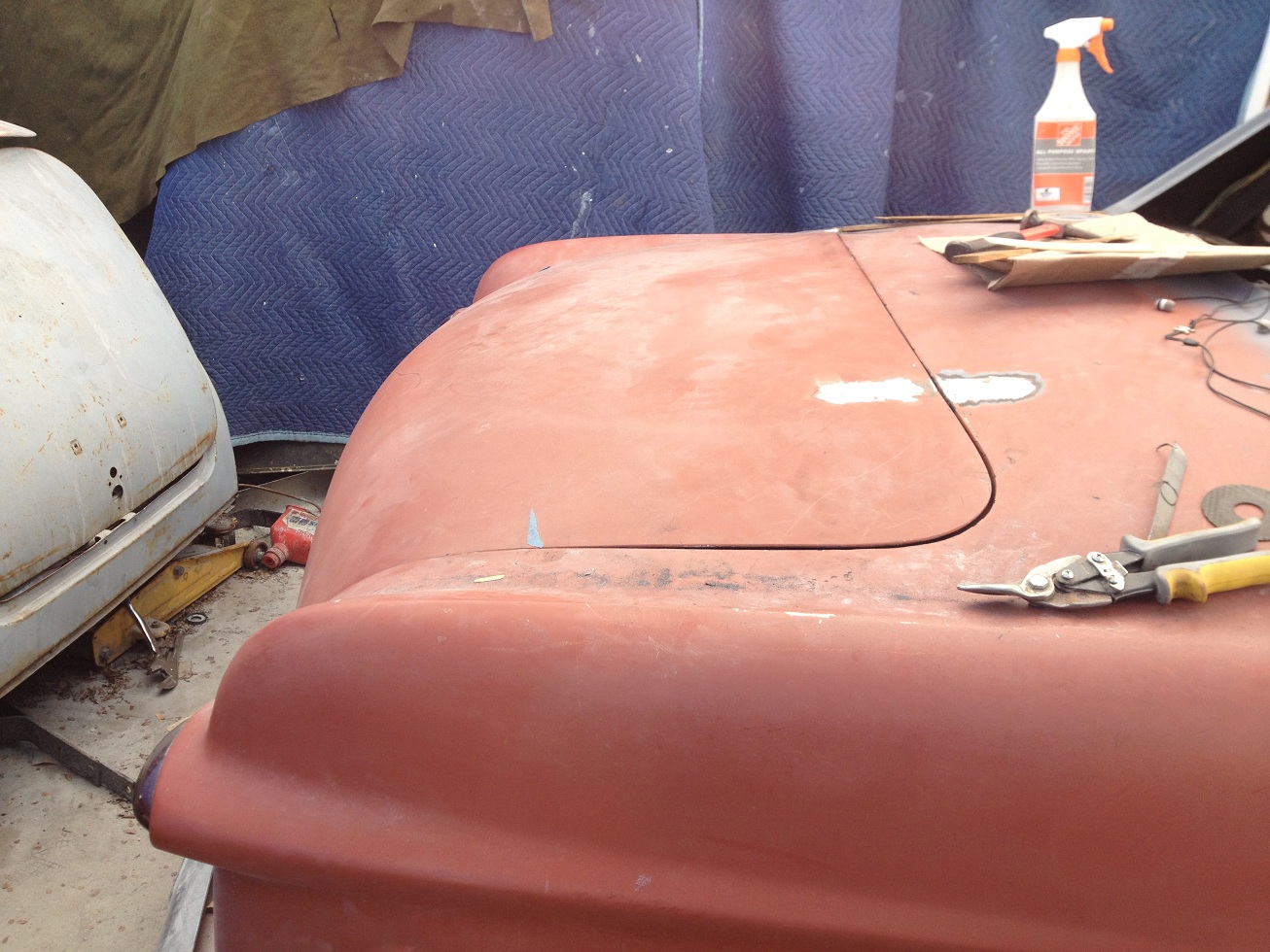

    Update today. Got the roof 70% bumped out. Used the replacement shrinking wheel of death and lived to tell about it. When I striped the roof it had spots that had 2" of bondo plus 8 layers of high build primer. It did look pretty straight minus one small dip in the center rear by the window. I had been dreading doing it as I wasn't sure if my hand could handle holding the dolly yet but I'm glad to report that I'm in a little pain but overall I'm great. When I was out with my hand injury I debated doing a roof swap/ chopped and was waiting for a sedan roof to come up on craigslist. It's funny after I decided to not chop one came up. I just want a mild Kustom.
    Cops were at my house twice today. Once when I was working and once when I was getting out of the shower. Got to love all this BS.

    Plugging away on the roof. Hammer and dollied it out. And used the shrinking disc of death and lived to tell about it. I am over all pretty happy with how it turned out and slapped some primer on it. I will block it and primer it again in a few days. Lots of cop visits. I decided to not press charges against my neghbor as they are felony charges he would lose his job. I think he might have a mental problem.
    Anyways
    Overall I am super happy I did it but wouldn't want to do this roof again. I really would have bought the sedan roof off craigslist and chopped this thing.

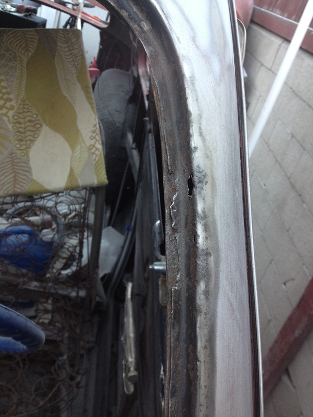

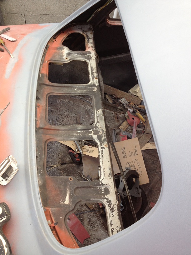

    It's a winter miracle! The car for the first time since I bought it has a package tray! all welded and like new! While doing it the fire department came and asked if I was welding and yup you guys guessed right Mr Douche called the fire department on me. Not that the cops aren't coming anymore he is trying really hard to get me in trouble. I did get big props from the fire crew for having a bucket of water, a charged hose and a welding blanket. I had the deck lid off at the time and was welding it in the driveway out in the open! They asked me to come take pictures at the fire station when it's done. Also neighbor should be getting a $201 bill for false alarm call.
    Had two real bad spots I had to fix on the front window opening so out came the windshield.
    Other spot that needed to be cut out and a new piece welded in.

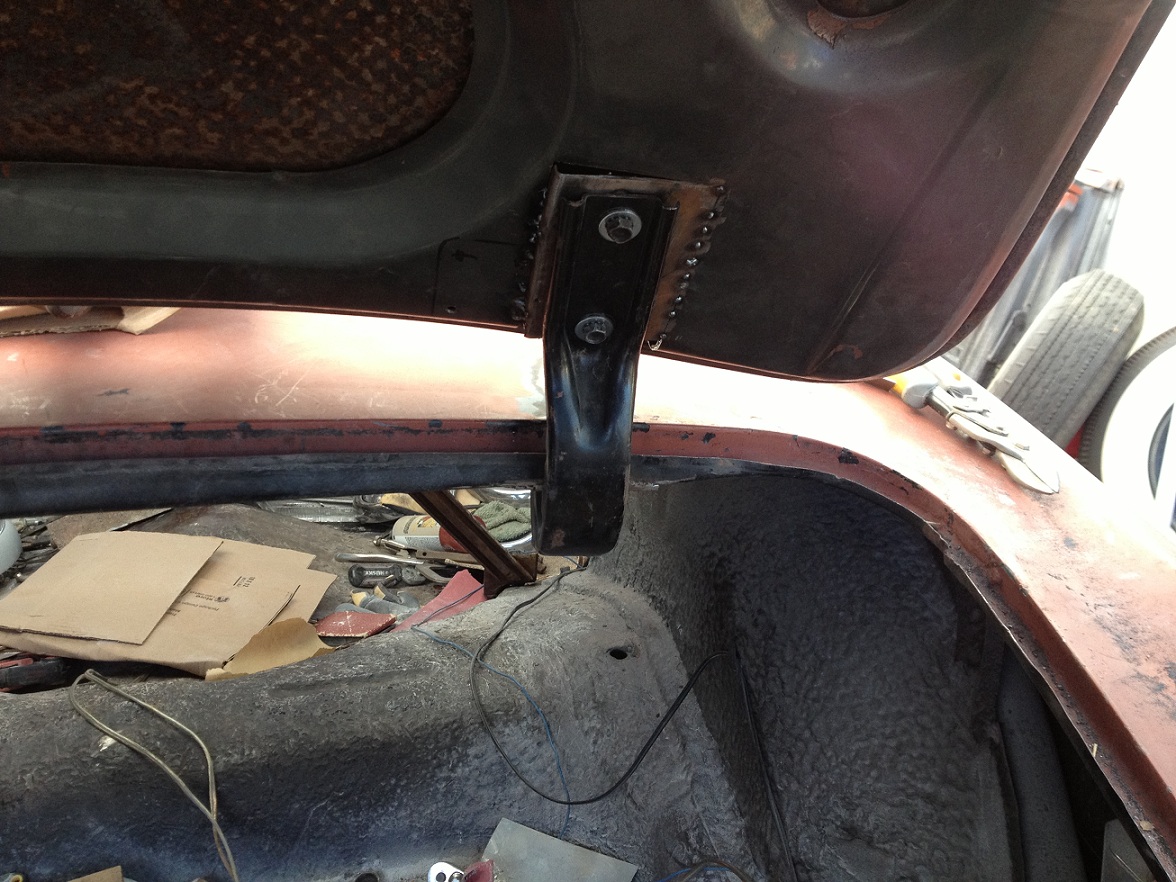

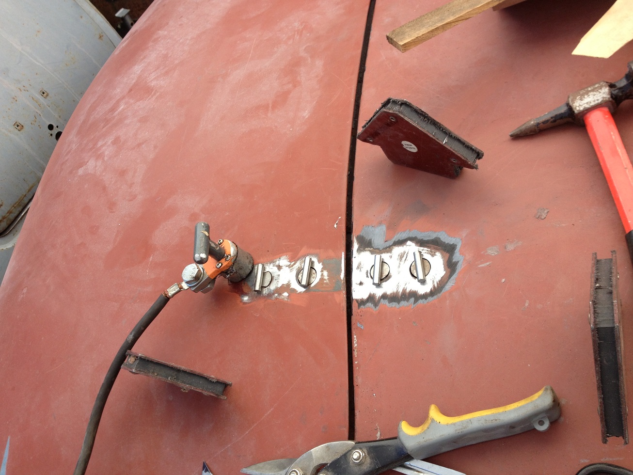

    50 deck lid hinge pocket cut out and new plates welded in! I took 1/8 flat stock I made a computer server bracket out of for the old job and welded nuts to the inside to mount the hinge to!
    THANKS LOSTN51!!!

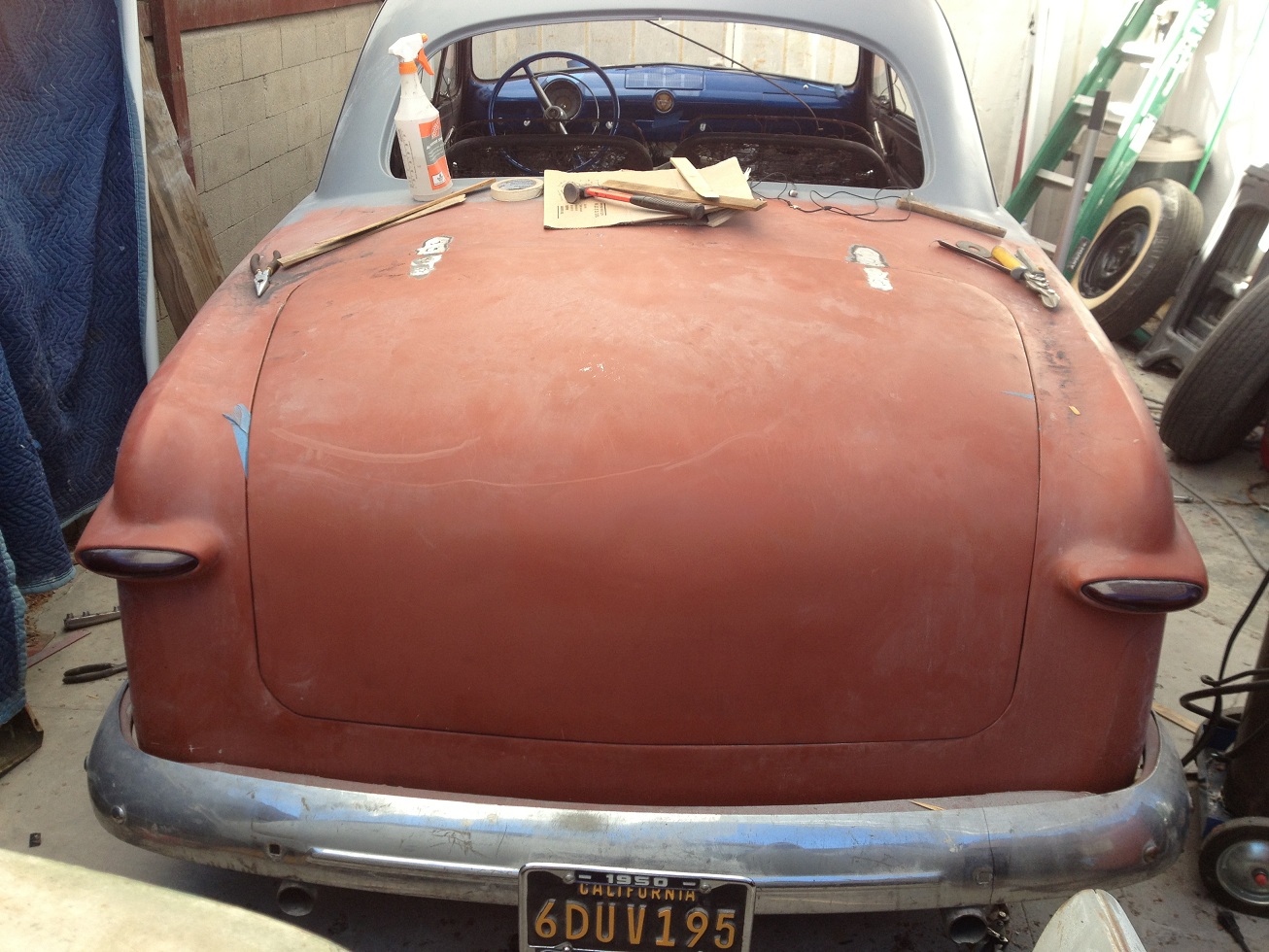

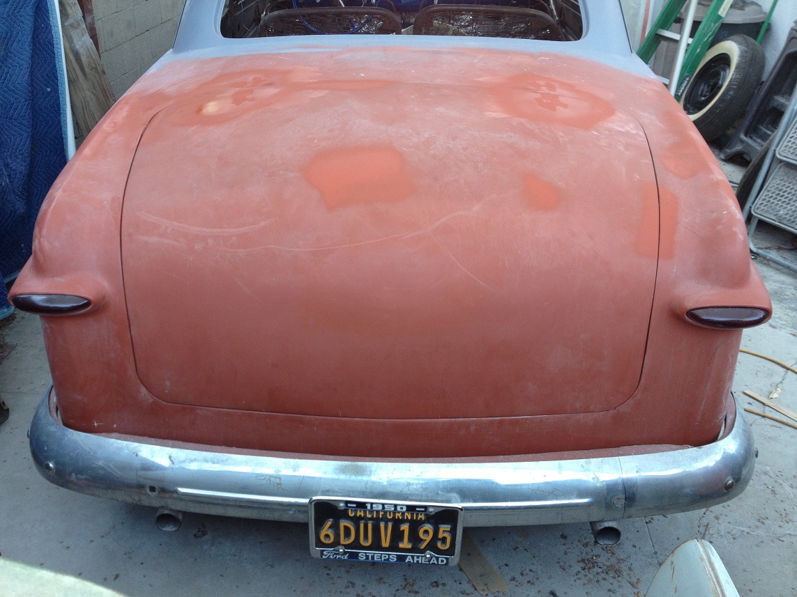

    Spot primed! Fit is really good minus the top middle. I think I have to push the rear of body up like the green bible shows with the jack. The rest of the lid fits super nice now. Trust me it was a lot of work to get a deck lid to fit on the car. I have to finish weld everything still. Overall very happy.
    Rear package tray looking happy and it's funny how much more solid the car feels.
