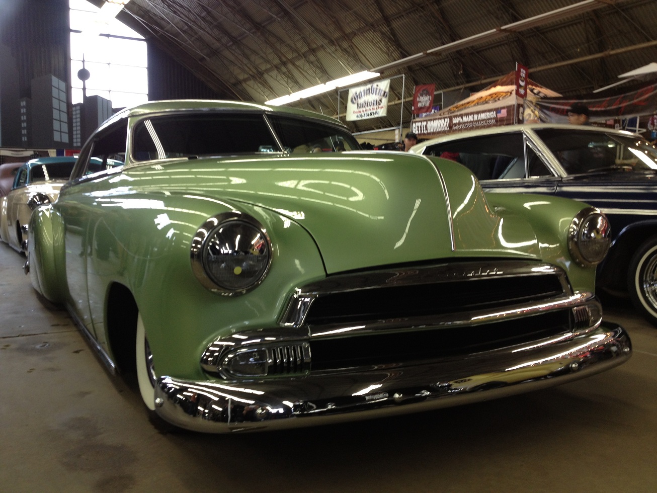

    My top picks of GNRS 2013!
    Tyler's pick! 59 El Co with This is not that kind of car please don't touch in the window but Mr Happy charmed his way into sitting in it!

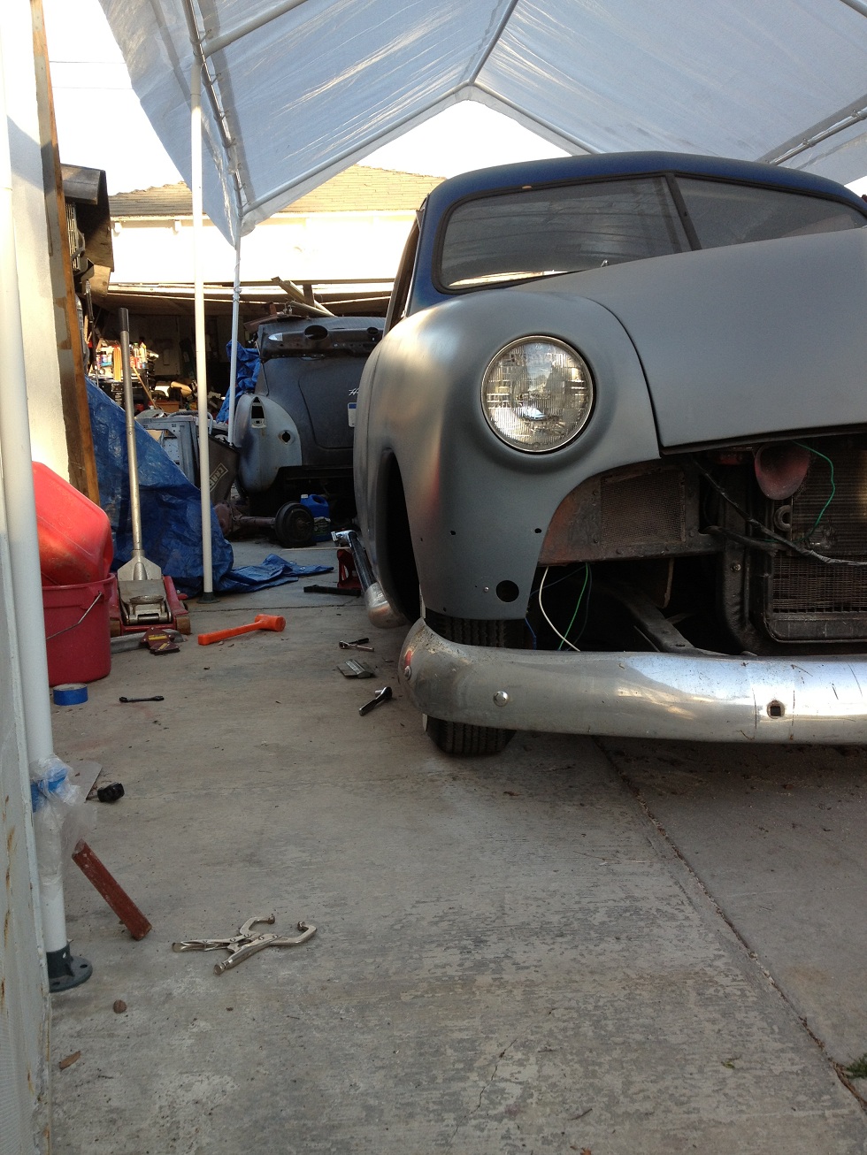

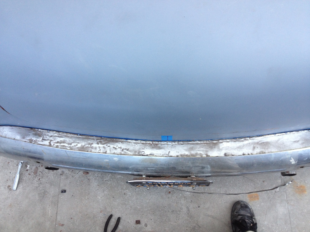

    Been plugging away on the little things while I wait for my mandrels to get here to mold in the side pipes. Stupid kid tried to steal my Zombies CC plaque off the back. Fixed the front spalsh pan what a pain in the ass. It never fit well so I hammered it out and now it fits so much nicer. Its funny how much different it fits now. I use to have to put all the bolts in and tighten everything down just for it to fit like crap. I'll primer it tomorrow since it's going to be 81' out in SOCAL!
    WHATS YOURS GUYS THOUGHTS ON MOLDING IN THE REAR SPLASH PAN?
    it has a roll pan on it now and the splash pan I had looked like it was beat with a rock. I have it fixed as much as I want to go before I decide if I want to mold it in or bolt it on.
    It's bolted on with three bolts but fits pretty well minus a few spots that need some work to make it fit a little better. This view made me decide to do the 49 chevy front license plate guard.
    Moved it up from the stock location also it has the seams shaved.

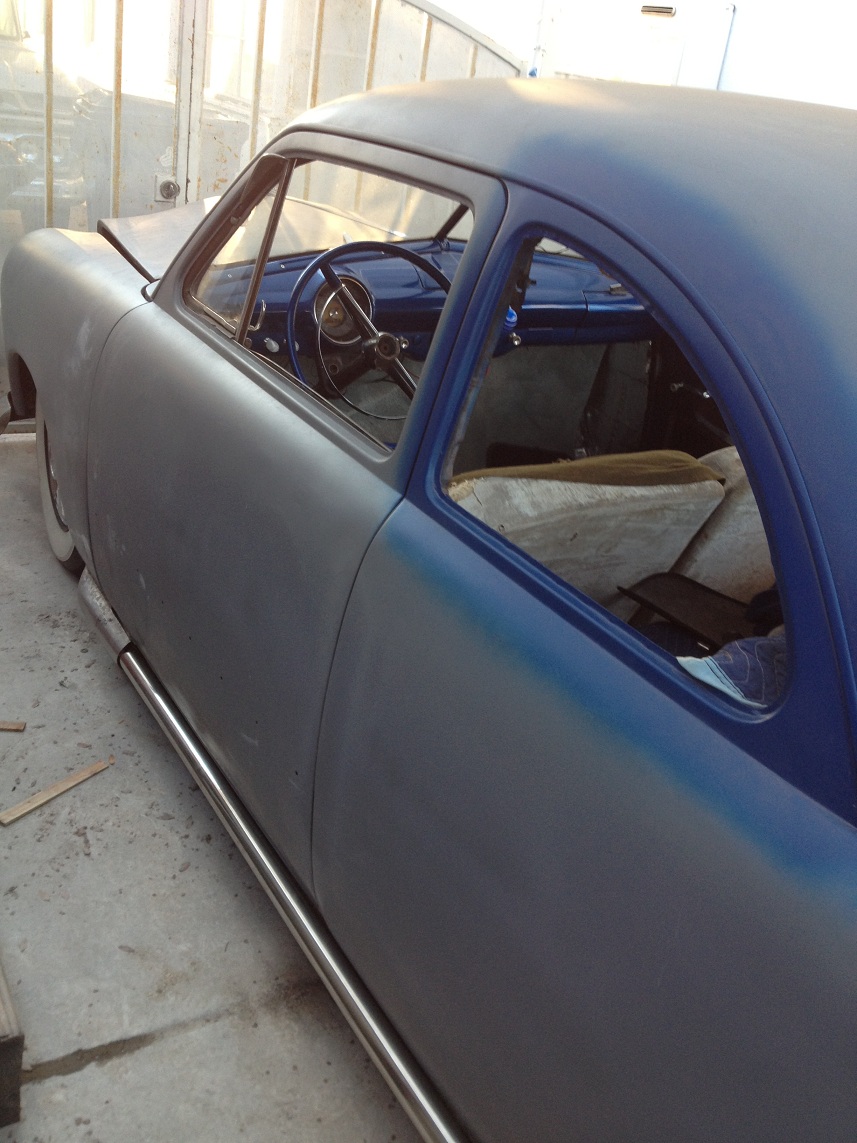

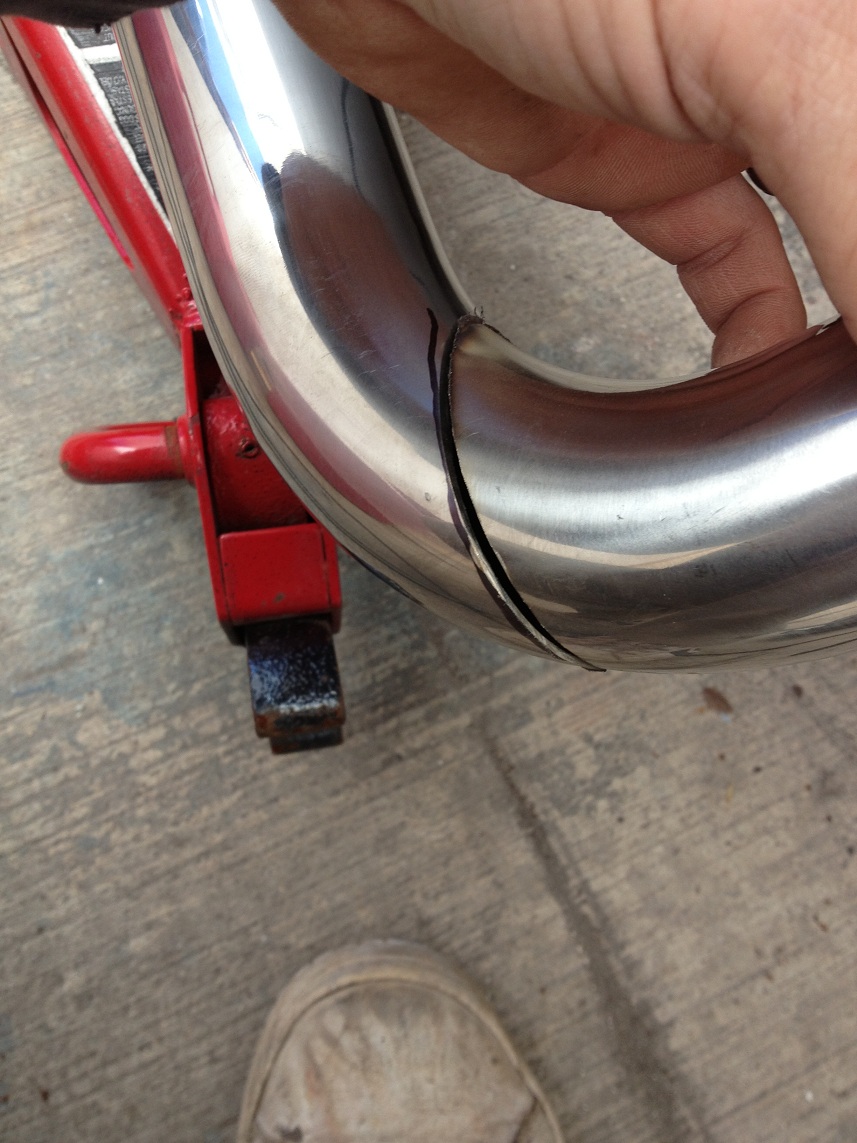

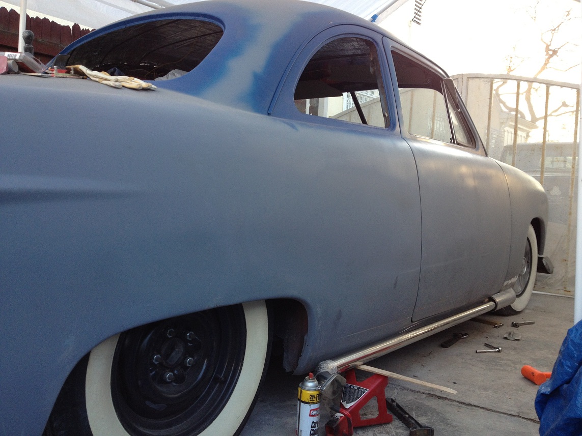

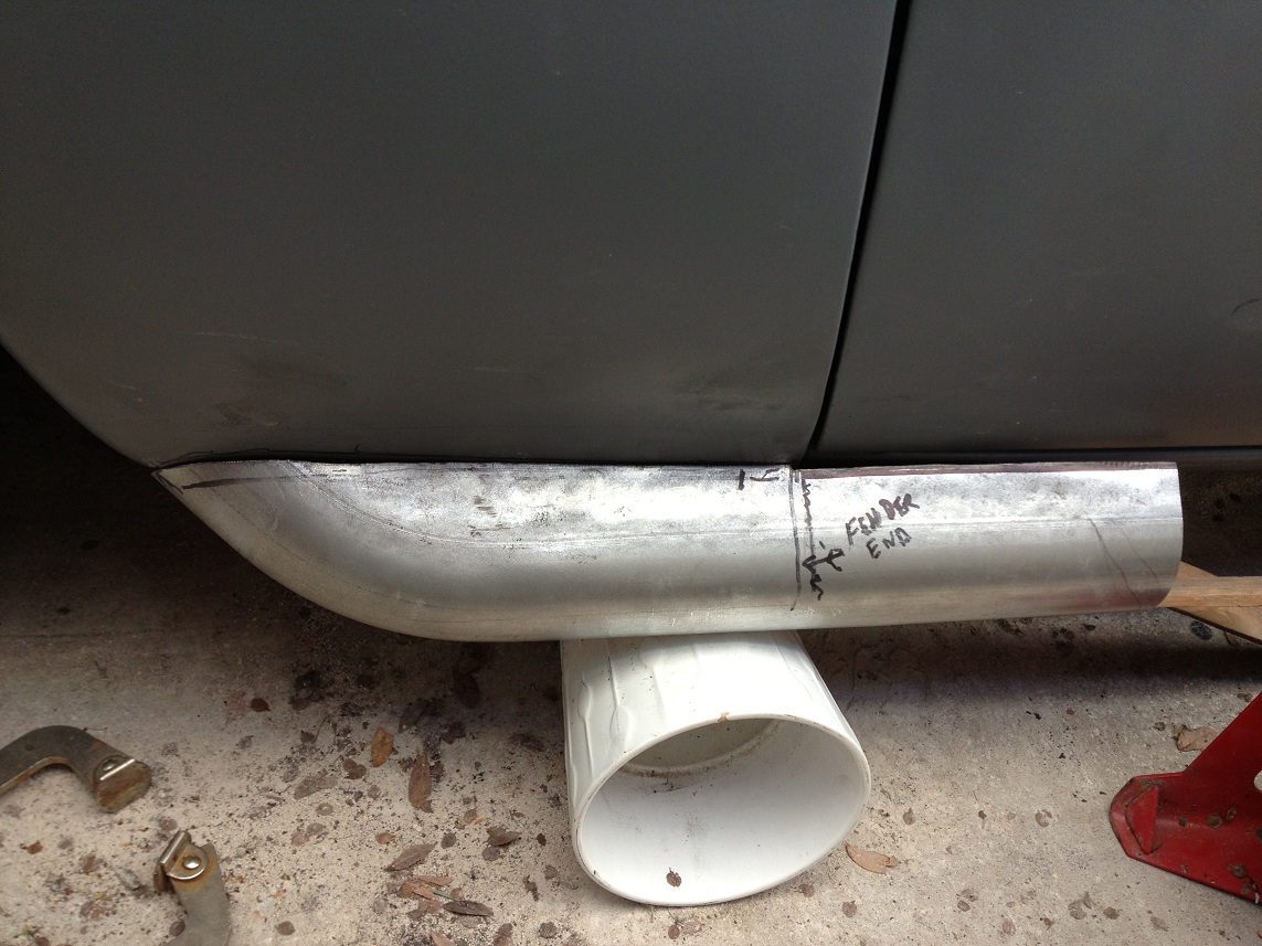

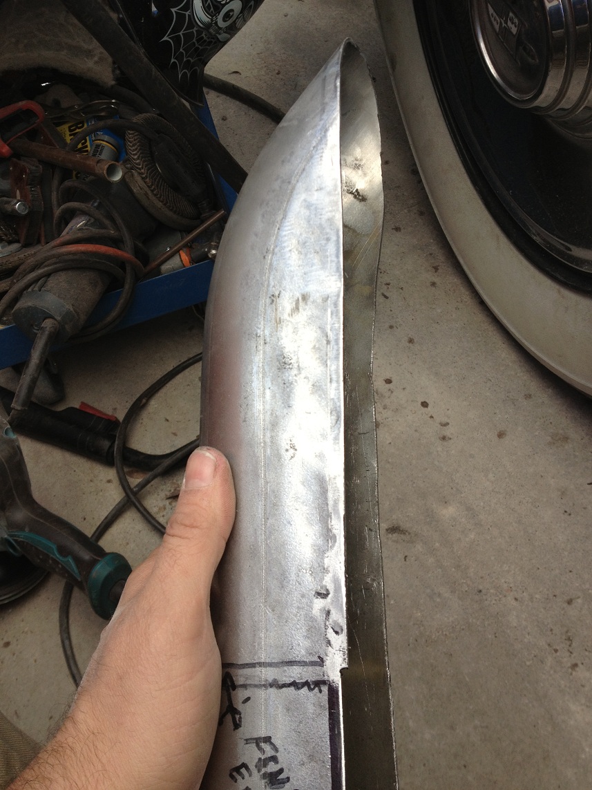

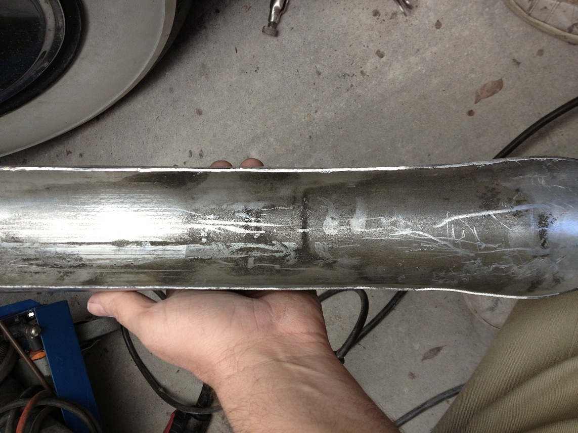

    3 inch 45 degree mandrels with 12 inch legs. I bought them a seller on ebay for $18 each.
    Lake pipe cut off.

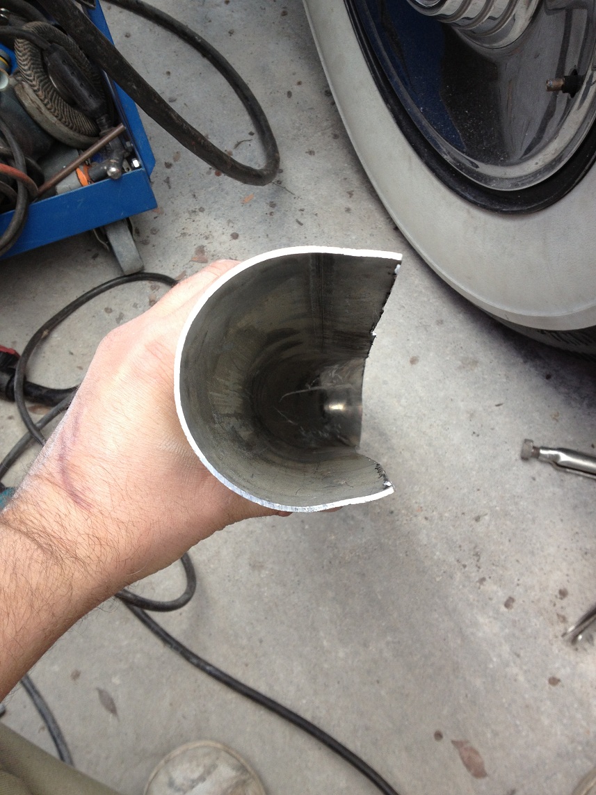

    Bend cut off and hammered flat where it will meet the fender and rocker
    Flower power mock up.
    inside shape after hammered flat.
    side view
    bottom is cut less than top for angle for fender.

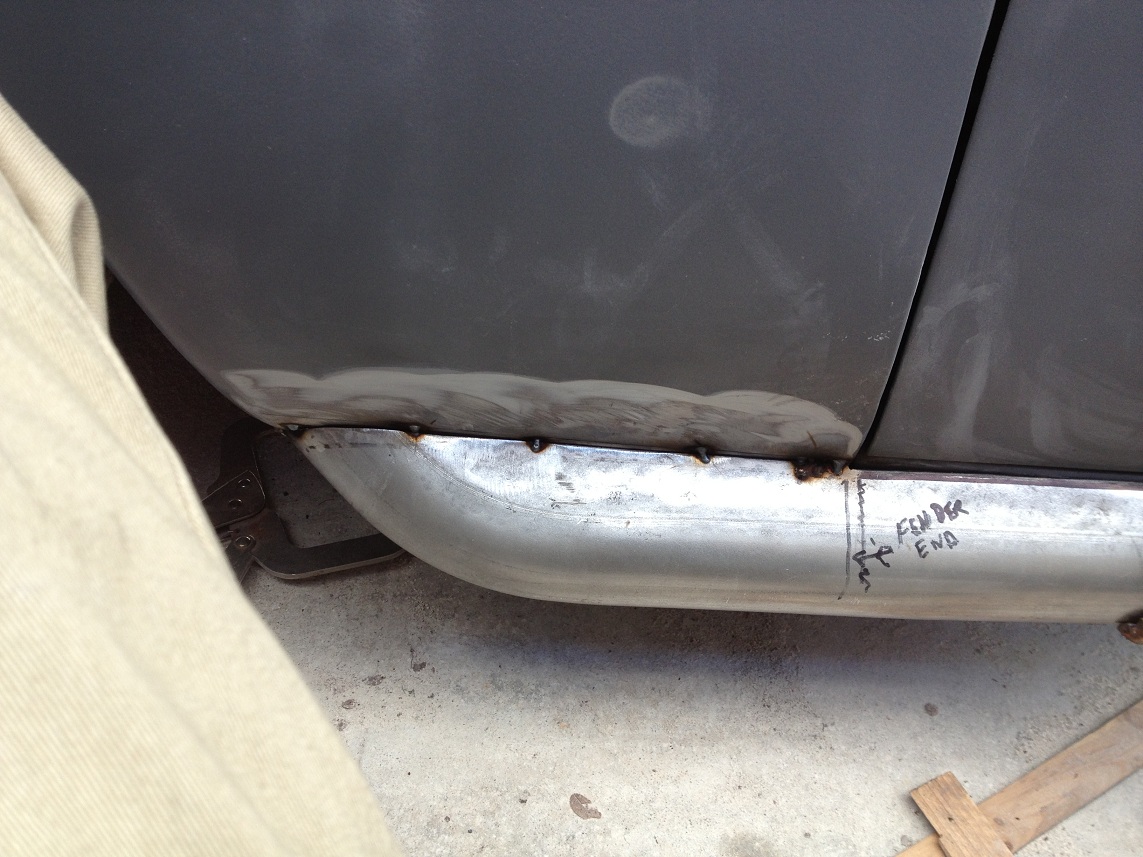

    Tack welded in.
    More welding.
    Front view.
    Rear view.
    Added a piece of metal where pipe is by rocker. Still have to figure out if I'll end it shapewise. either angled or round. Also if I am going to add round bar to end.

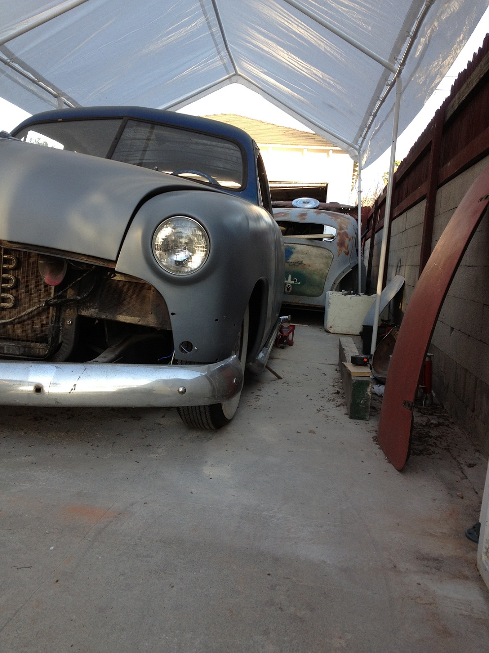

    Passenger side welded up.
    Rear view
    That one is a 52 Henry J in the back ground
    And this one is a 53 Henry J in the back ground
    I traced the door angle but I don't think I like it.
    Flat looks better to me.
    I tried holding round bar up and I'm just not crazy with round bar with it flat.
