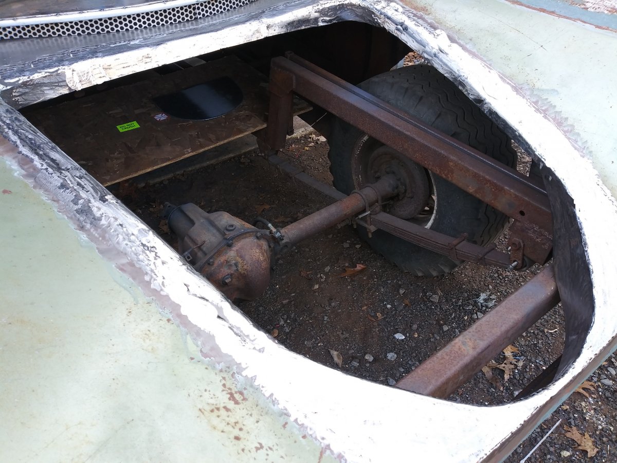

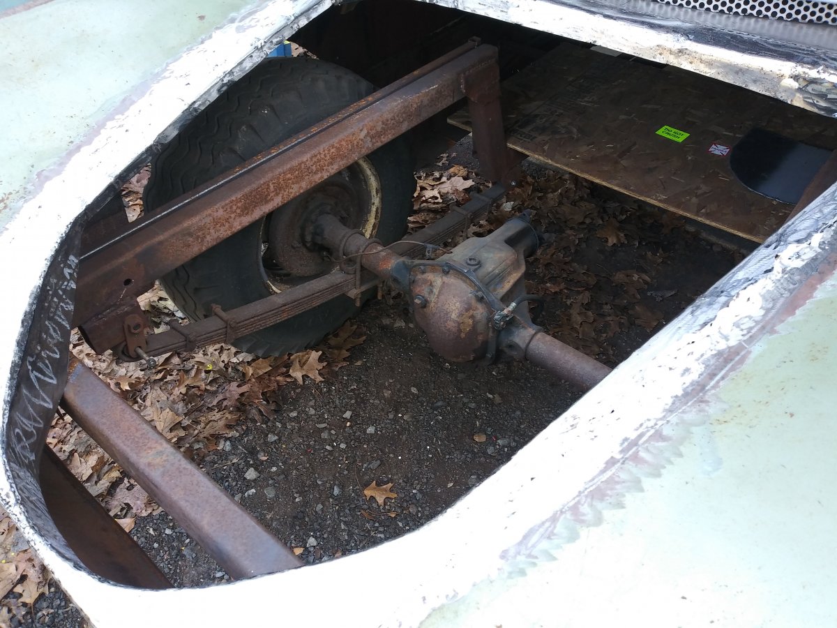

    As it is dec 25(as I have done for years) I figured I would post some shots of what I am up to on the car.I have been working on what was the trunk now the engine compartment I removed the trunk gutter area and what I would call a metal waterfall as the metal rolls over the side.If you look close you will see I have also been working on the top area for the bubble you will see more on that later as I prepare to blow the bubble.Hehe!!! 20201213_150221.jpg 20201213_150235.jpg

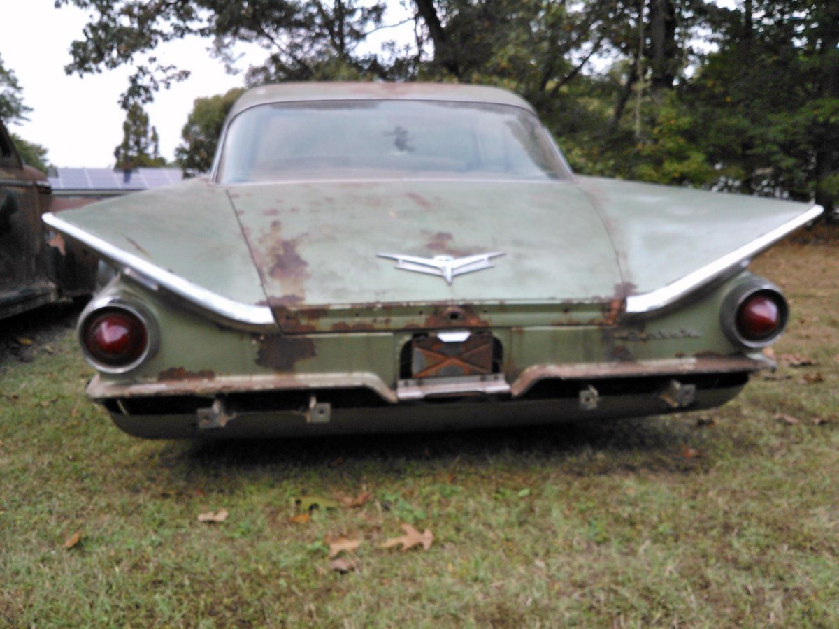

    I just realized Ihavent updated in a while I added 5 1/2 inches to the rear fins.more coming... 20200901_134819.jpg

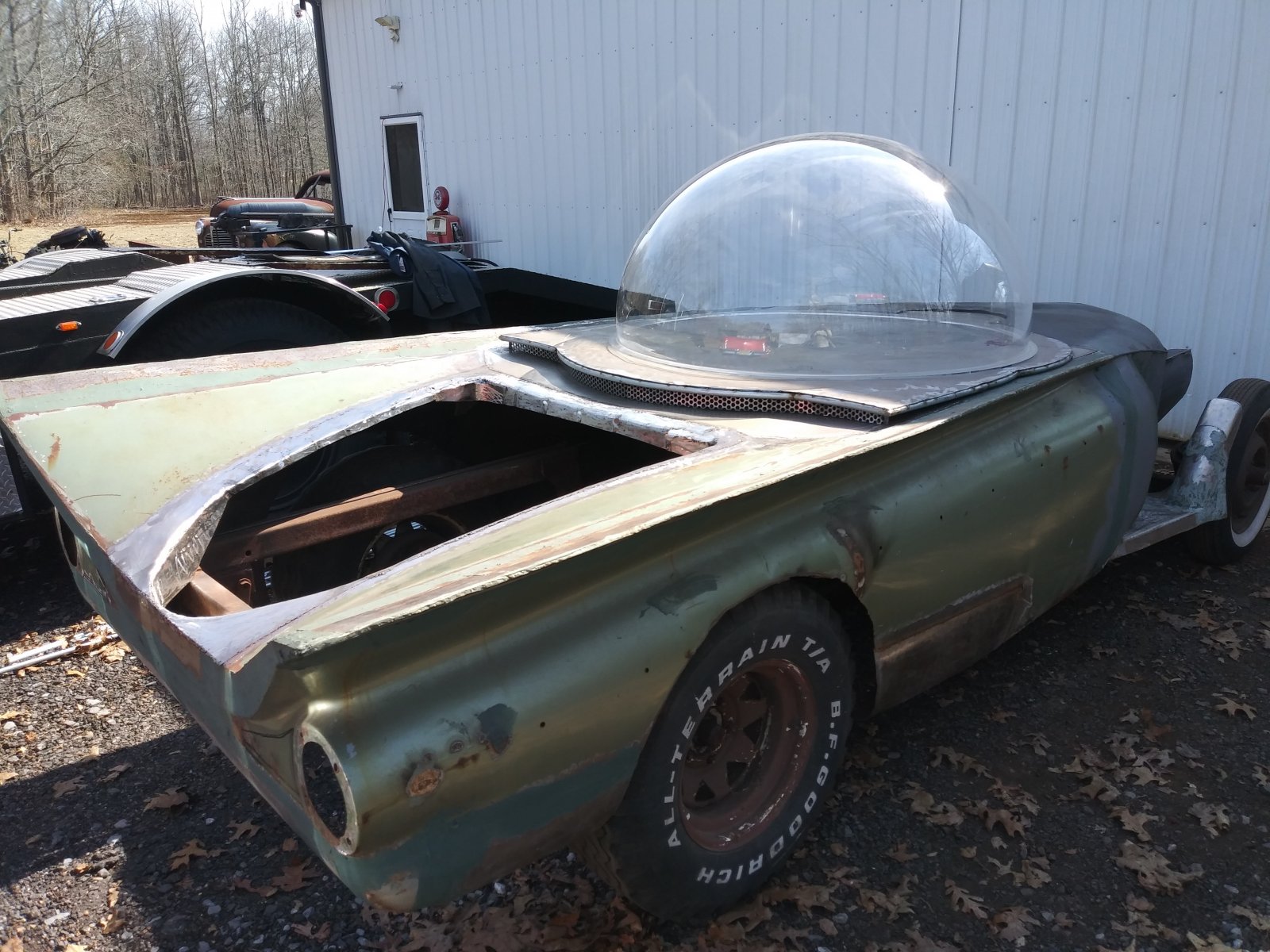

    Posts: 248
    THE KUSTOMIZER
    from south nj
    Well the bubble is blown!!!here it is set up on the base that I made.After seeing the what bad chad did on his tv show I thought that may be the easiest option for me I dont have pics of the blow up because I was there by myself and only had a short time to do it I started by calling the local powder coaters to see if I could rent there oven on a non busy day I found one that agreed to give me a call when he had down time.I used to 3/4 inch plywood cut my hole in one used a bedsheet in between with slices cut into it add an air fitting and ball valve and gauge and i am ready to go.Using 1/4 acrylic sheet.I got the call to come over after alittle trial and error I wont bore you with ..I got it where I wanted it..Heres a pic enjoy!!! 20210311_140034.jpg

  21. blowby
    Joined: Dec 27, 2012
    Posts: 8,664
    blowby
    from Nicasio Ca
    Wow great job! Car is going to be *****in'.
