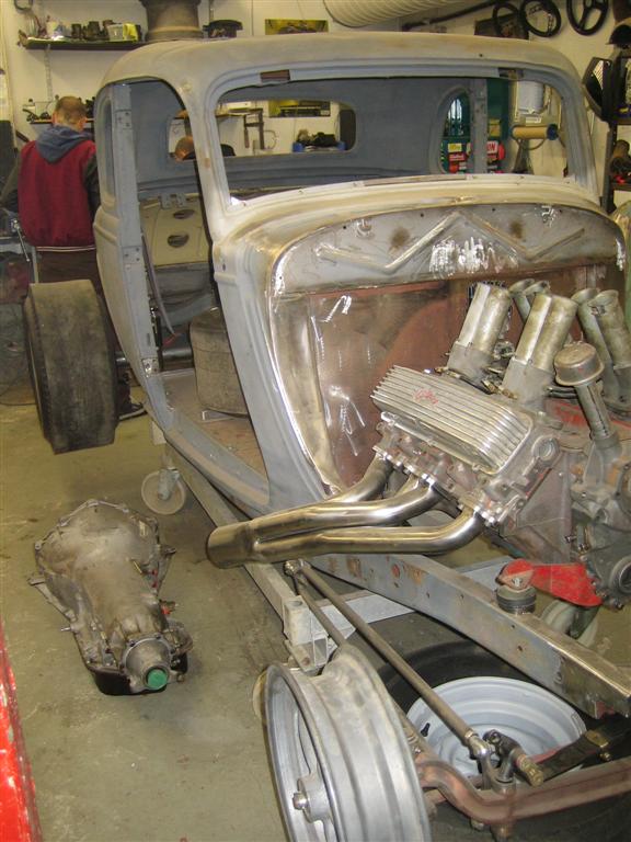

    so sold of 5 cars, selling of 2 more to finance the build of this car
    aswell as getting more stuff done on my 1930 coupe and 1928 pickup
    aswell as chop the top 4-5" + layback the front window a lil bit
    anyhow some ingredients
    the frame is an 1933 frame/***le and body is an 1934 body
    so skitzo as i am i might refer to the car as either wierdly enough
    394 olds rocket with edelbrock valve covers, gotha rockers,isky pushrods, scheifer clutch + flywheel, also got an 6x2 offy intake with 6 strombergs for it, its a clutch hydramatic, engine is bored 040
    16x11" magnesium american racings
    15x4" magnesium american racings early ford spindel mounts
    (any one wanna trade for 15x4" -15x4.5" 5.5 bolt pattern magnesium american racings?)
    1946 lincoln brakes with chromed backing plates
    1957 ford truck rearend with 31 splines and detroit locker
    1940 ford dash
    f1 steering column
    1951 pontiac taillights (no not 1950)
    early 16" superior steeringwheel
    studebaker gauges with km/h on speedo
    car is probally going to be dark brown metallic with frame black and everything that isnt chromed / polished will also be black except for all "sheet metal" that will be dark brown)
    black interior
    still alot of work to be done but its on its way.
    there is something quite "wild" going on on the grill/hood area that i do not want to disclose right now

    hehe yeah Scoob, i think i forgot to mention that i got an complete hilborn for the 394 aswell, but suppose the pictures told that story already :D, dist driven even :D no need to mess with frontcover and external water pump etc..

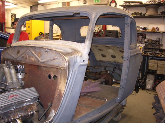

    RocketDaemon, Great work! I can't help but think that the firewall has been modified, has it? Hope you can share the frontend treatment? As this will put everything into perspective. Great details for sure, Thanks!

    VERY Nice. My favorites - 33-34 coupe, Olds engine. And Hilborn on top ! The trans tunnel & firewall work is very well done, can you share any info/pics ?

    a couple of more pics, and btw i don't want to take so much credit yet for this car... i "blame" it all on the previous owner.,.. i will finish it all though
