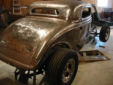

    Some of you may remember awhile back I posted a story about my friend who found out he has an in-operable brain tumor.
    Anyway, if you don't, he has this 34 Ford that was "being worked on" at this shop. The guy wasn't doing **** to the car so I decided to go start working on it myself. (No help from the shop owner of course) Well, I finally got sick of driving to this shop so Sunday we brought the car here. I'm trying to get it into shape for this guy since he's hanging on by a thread and the 34 is all he cares about.

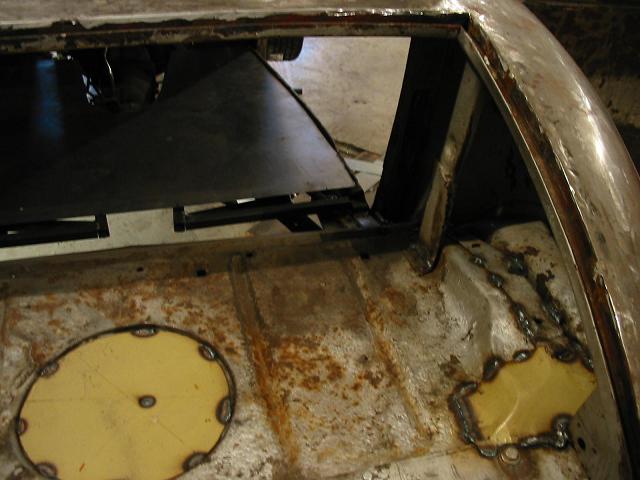

    So, here's some pictures of the car as of right now. It's in need of alot of sheetmetal work as far as the under structure goes. The decklid had over 200 drilled holes in it where someone had tried pulling dents out. I filled those which took forever and flush mounted a Hagan filler door in the deck. The previous shop had put it above the wheelwell, just about level with the top of the tank. (Never get gas in it that way)

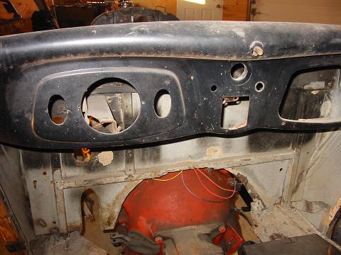

    I built a square tube structure under the floor to support the pan. I think tonight I'm going to start on the transmission tunnel. I still need to figure out what to do for pedals as the owner hadn't planned that out yet. It's a 4-speed to boot.
    After the main tunnel is finished I need to figure out what seat is going in it so I can plan for the driveshaft tunnel. I suppose buckets would be easiest as far as the tunnel but a bench will mount to the tube structure underneath alot easier.
    I'm pretty proficient at fabbing/welding but this is the first Rod I've gotten to work on so I'm kind of at a loss on what stuff to use/not to use. Any suggestions or comments are welcome. I just want to get this car together so my friend can check it out.

    whats that tank look like with the deck lid open? dont recall ever seeing a filler in the actual lid

    Well, the decklid is getting welded shut so the tube will just go straight into the tank. It's just a car tank out of some 70's chevy. I have no idea what it is. But anyway, the neck just goes straight down into it.
    Personally, I'd like to have a big knarly spinner type fill on it but it ain't my car so Hagan it is.

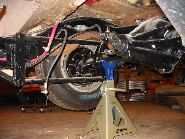

    its really great what you are doing for your friend . judging by the pics its going good . the only thing i can suggest is you should probably put some bead rolls or alot of welds in the floor pan to keep it from making nois under your feet. looking at the rest of the project i would say you already know this :D

    It'll be sandwiching rubber between the frame and the pan. I think once the tunnel is in place it will get pretty rigid as well. Thanks man...
