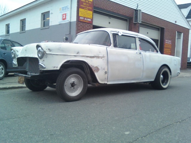

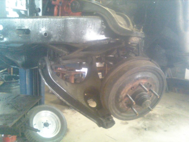

    now that the valvetrain is straightened out some tuning issues need to be resolved. hesitation & stumble along with a terrible idle need to be worked out.
    i also replaced the lower balljoints this weekend. while i was at it i added the ball joint & spring spacers i had sitting under the bench for the past year. the spacers really let those too tall front springs work!

  26. 8FLEET9
    Joined: Feb 9, 2009
    Posts: 733
    8FLEET9
    from MASS.
    here's a lil before & after on the rake.
    gained about an inch with the spring spacers. i dig it.

  28. Johnny Gee
    Joined: Dec 3, 2009
    Posts: 14,998
    Johnny Gee
    from Downey, Ca
    Look'n good. Could not tell from photo. Did you remove the lower bump stop brackets from the frame so spacer does not touch.
  29. 8FLEET9
    Joined: Feb 9, 2009
    Posts: 733
    8FLEET9
    from MASS.
    thanks man, is your car outta the snow bank yet?
    yeah, there was no way the b.j. spacer would fit without removing that bracket. i took the air chisel to the bump-stop bracket, popped it right off. the biggest pain in the *** was getting the springs back in the pocket & the a-arm to compress it by myself. i had an inside style spring compressor that helped but i could only go so far with it before it hit the top of the pocket.
    there were many curse words in that 4 hour span.
  30. Johnny Gee
    Joined: Dec 3, 2009
    Posts: 14,998
    Johnny Gee
    from Downey, Ca
    Ya, tall springs are a pain with out that compresser. You can put an elephant on the fender and still not get the stud to the spindle.
