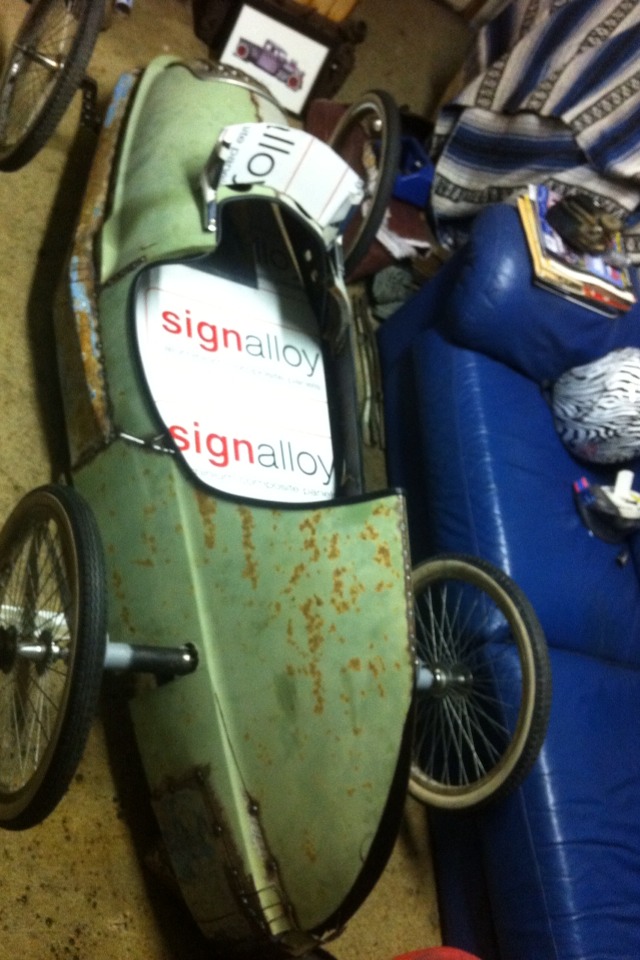

  11. Starting the floor. Using a product called sign alloy, it about 3mm / 1/8 thick. Which is a thin layer of alloy front and back with black plastic in the middle. Had to make a recess for my massive clown feet to fit in too,
  12. Pics

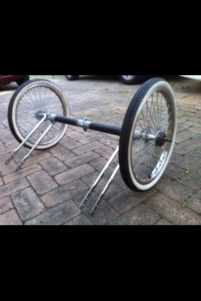

  14. Rear axel. Well that's made up from an old steel bull bar I had lying around. I made it out of 2 pieces so I can use all my socket extension to bolt on the wheels, then join the 2 halves together. Also wanted a parallel 4 link type set up, so for that I used a couple of old low rider bike sissy bars. Cut and welded on some plates to mount to 4 link, even used a level and square to "try" get them true as possible. I didn't want a fake 4 link, so I got on egay and ordered some rear mountain bike shock/coil over thingys, then cut and welded on some tabs.
  15. Thanks Santa for getting me the closest thing to dirt track racer tread bmx tires.

    Looks like you will need a panhard bar, the 4linkdoesn't look stout for side to side movement. That looks wery well thought out and engineered considering I have never seen a soapbox derby car with suspension. Very cool!

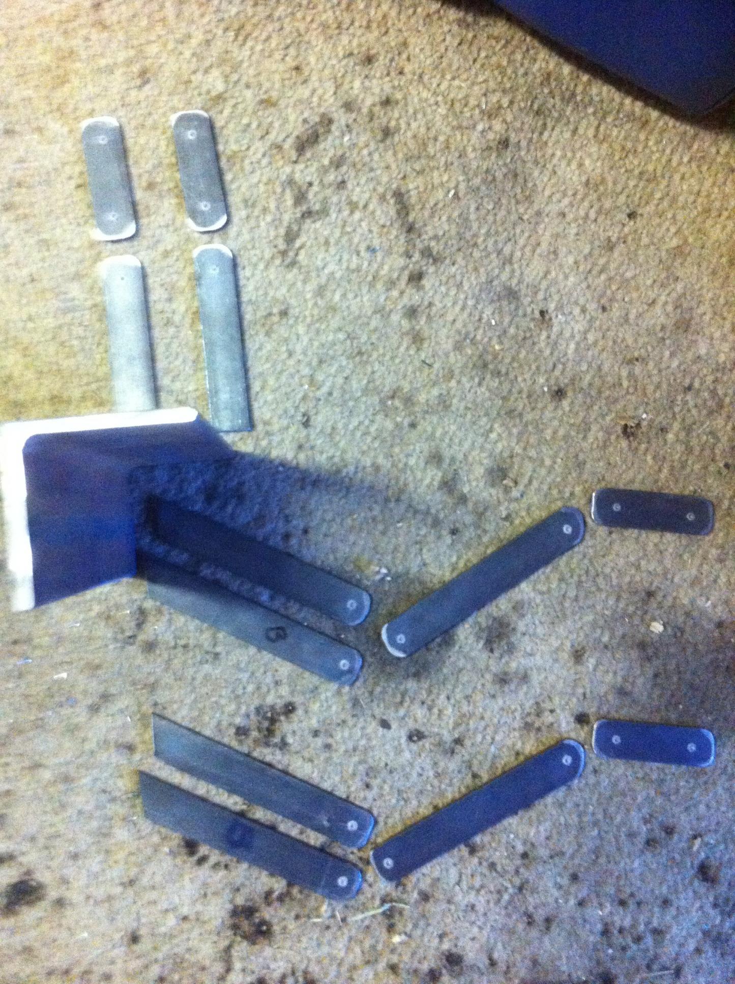

  28. Starting the brake, flindstones style. Brought some 25x5mm flat bar for a kind of scissor arm set up x2. Using some 75mm angle for a brake pad that will eventually have a rubber base. All the flat bar has been center punched ready to take to work tomorrow so I can use the drill press. It will be cable operated that connects to a leaver on the outside. Still need to find some springs to pull the brake pad back up.
  29. Pics.
  30. Hopefully it will all make sense (and function properly) in the next day or 2. Here's my brake leaver, Foxcraft. Not too sure what its off but it'll do.
