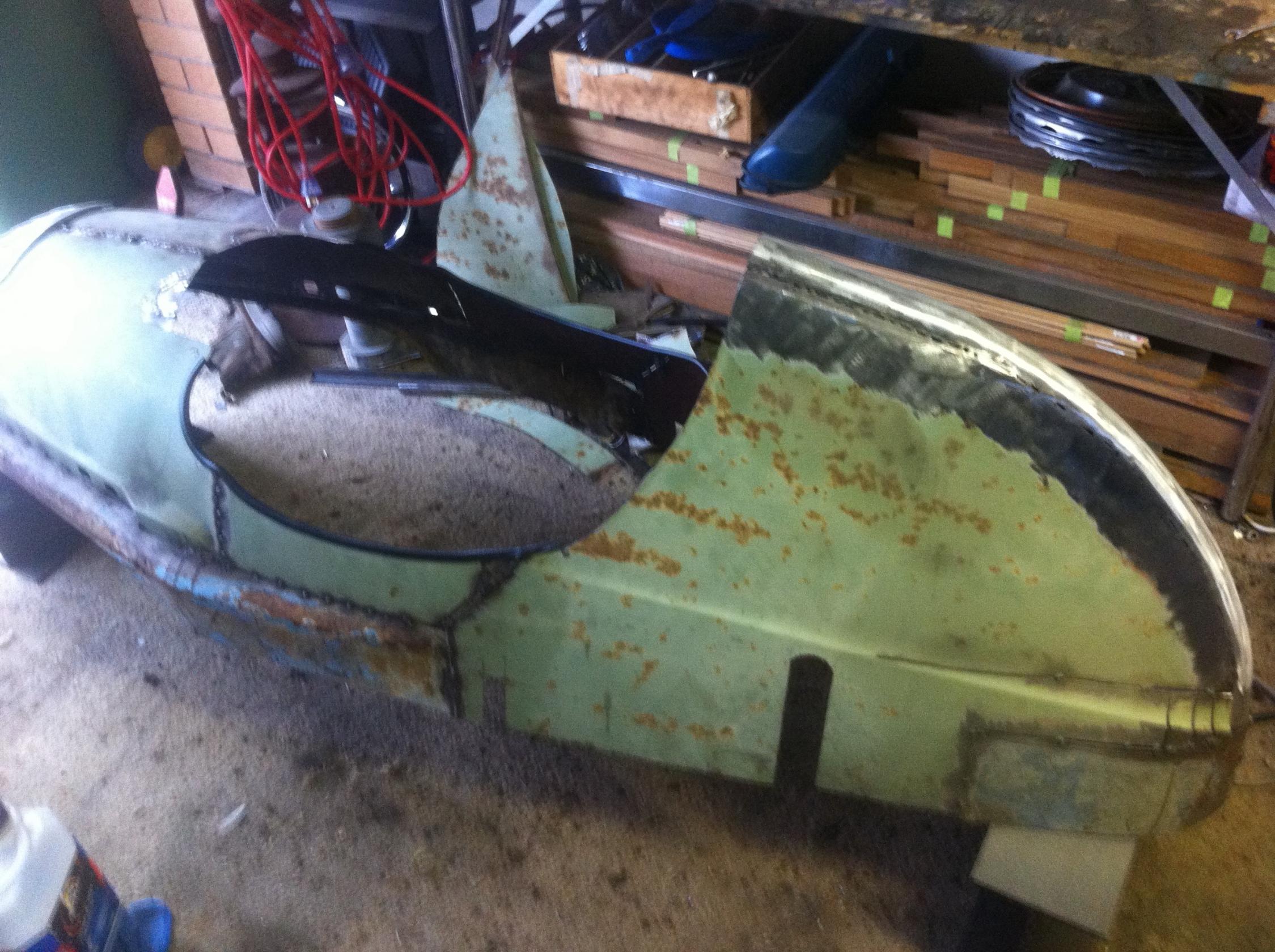

  3. Didn't really go to plan, bottom arms are too short and wrong angle so I didn't bother taking on the trailing arm style set up on. Back to the drawing board.

    60galaxieJJ

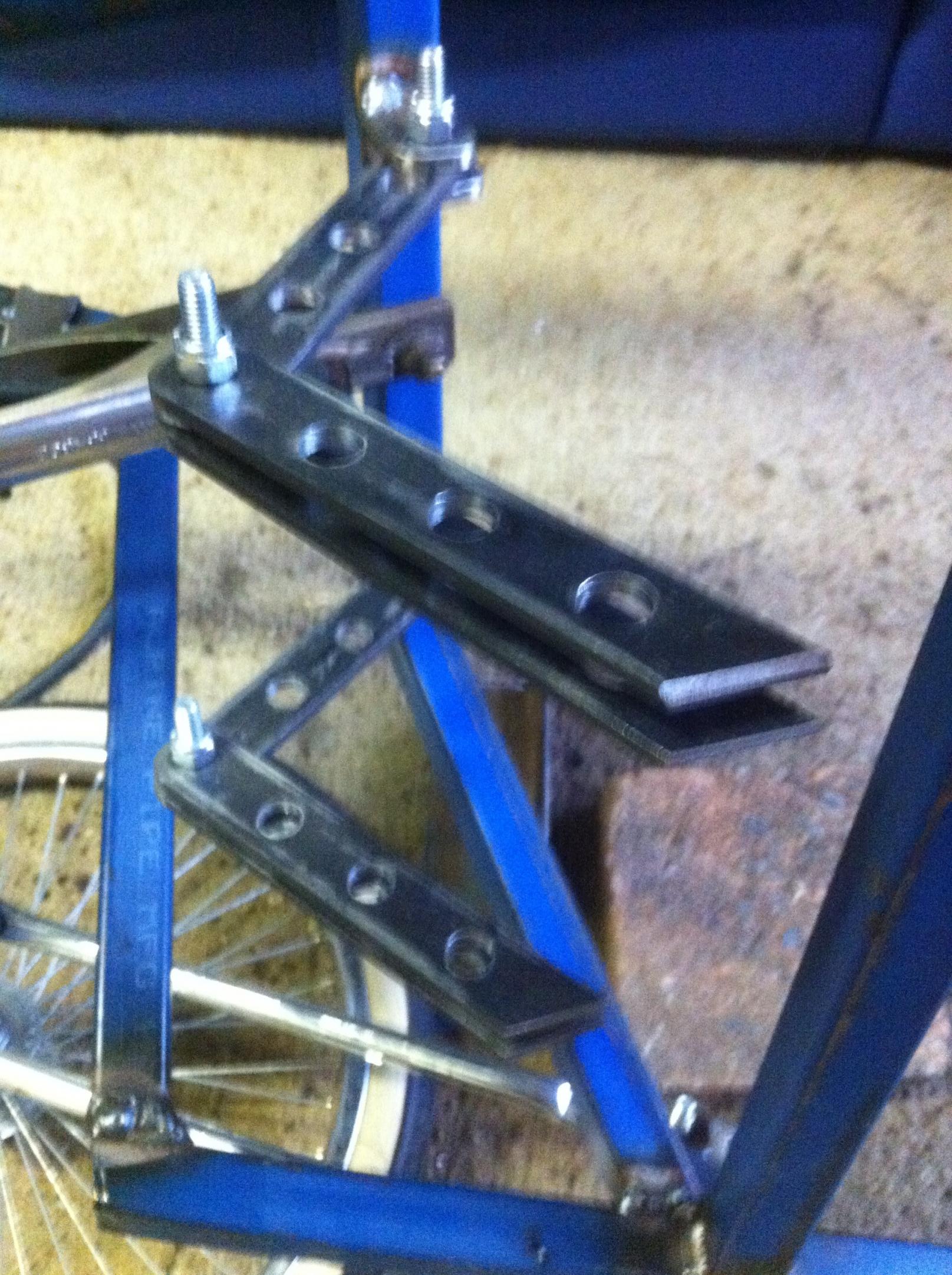

    Shopking
    from central Pa

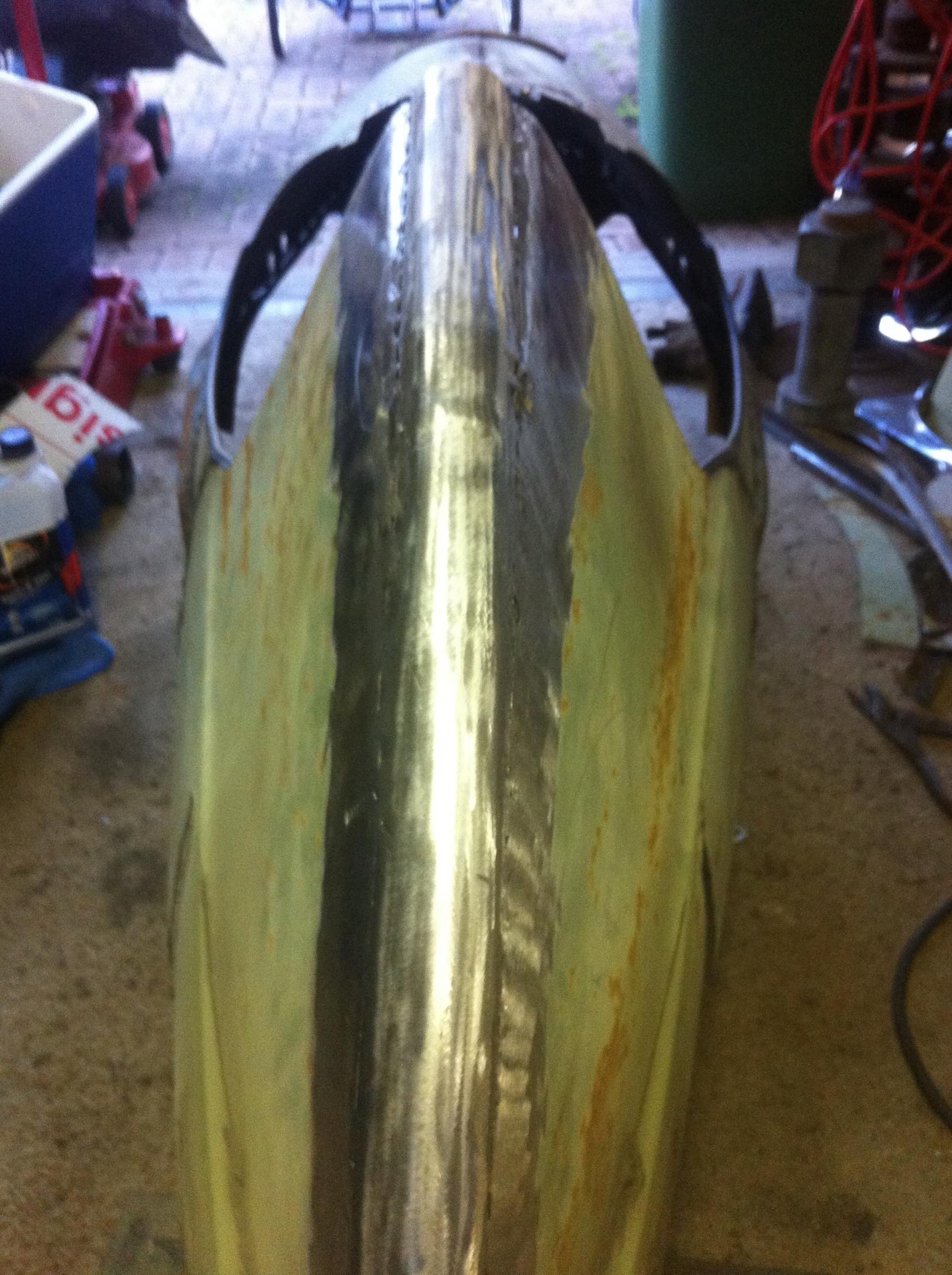

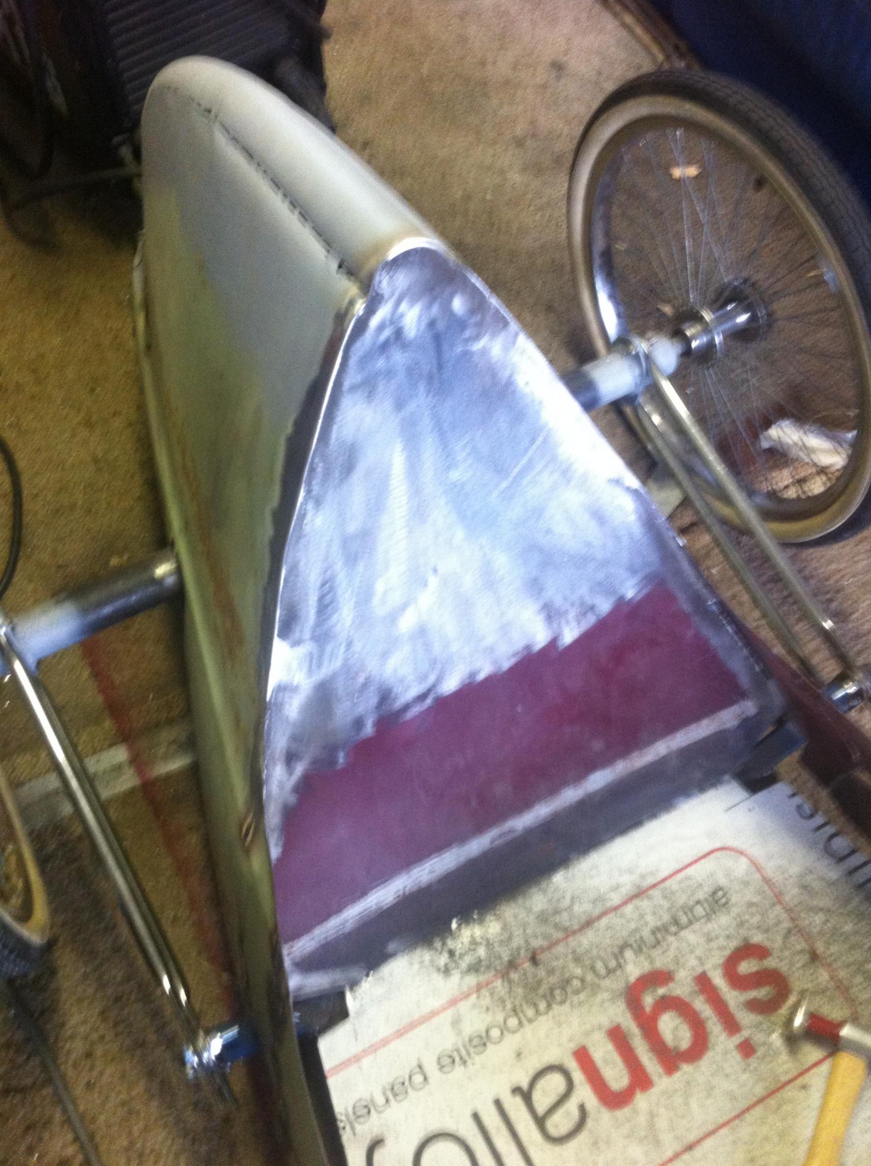

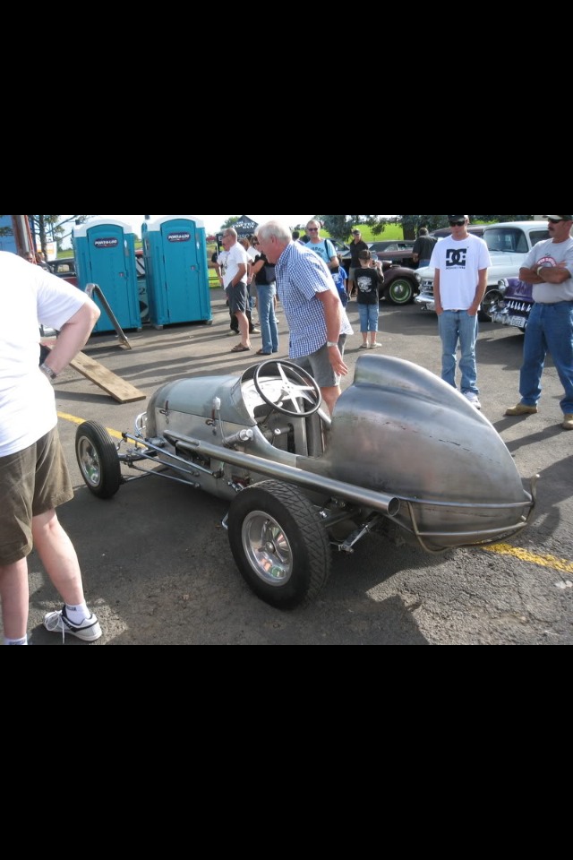

    That looks like a lot of fun.There has not been any soapbox events in my area for a number of years.
  7. Now that looks like fun!
  8. That's way too cool! Nicely done. I think I need to do one now, with the kids. Subscribed.

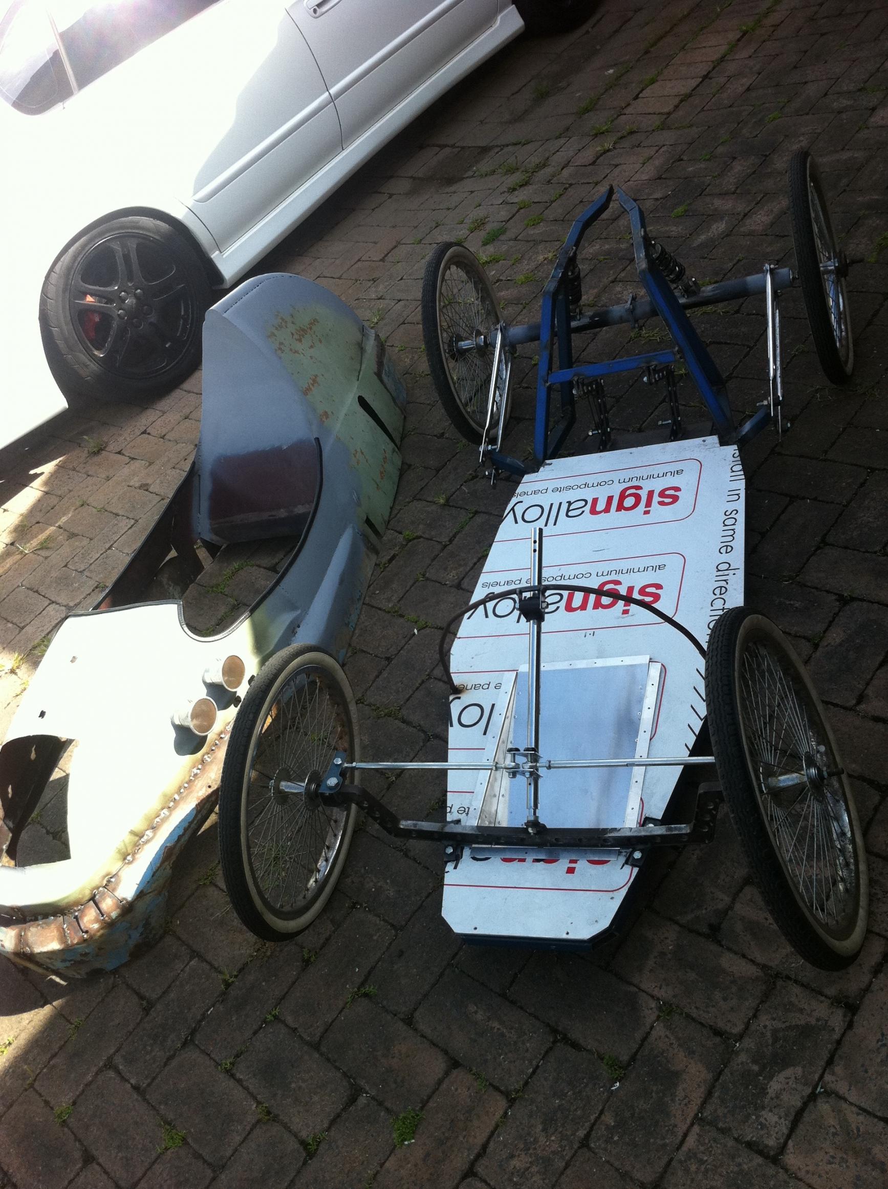

    Ryan

  13. Phase II brakes.

    This is fun! ...and my intent is certainly not to play the spoiler, but a thought occurs. The old SBers for the most part had no suspension, and thus used drag brakes to good effect, I'm just wondering whether with your rear 4-link you aren't going to lift yourself before you drag yourself? I guess it may come down to your gross weight vs strength/leverage ratio & being judicious in your application. I'm guessing you're planning to use some manner of 'shoe' [old car tire tread remnant perhaps] on the drag? Well, keep on keepin' on, & I'll keep watchin', this is a Hoot!
  24. Done a bit more on the brakes, not overly happy or confident with them. Need to find the right length and tension springs to pull the pad back up.

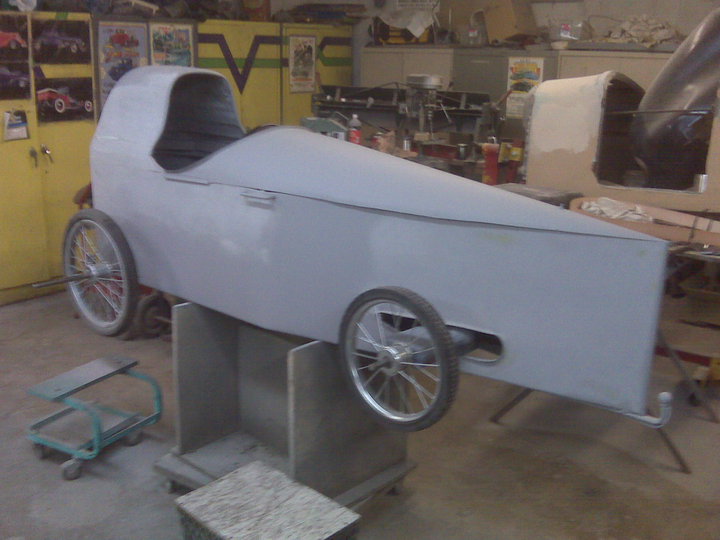

  25. Bit over the brakes, so back onto the body. I get some exhaust pipe bent (they did a ****ty job of it) to finish off the rear section. The first pic is what I was going for with the little kind of peak behind the drivers head.
  26. Bit more progress.
  27. Weld, grind, repeat X 1000. My least favorite part, well just the grinding.
