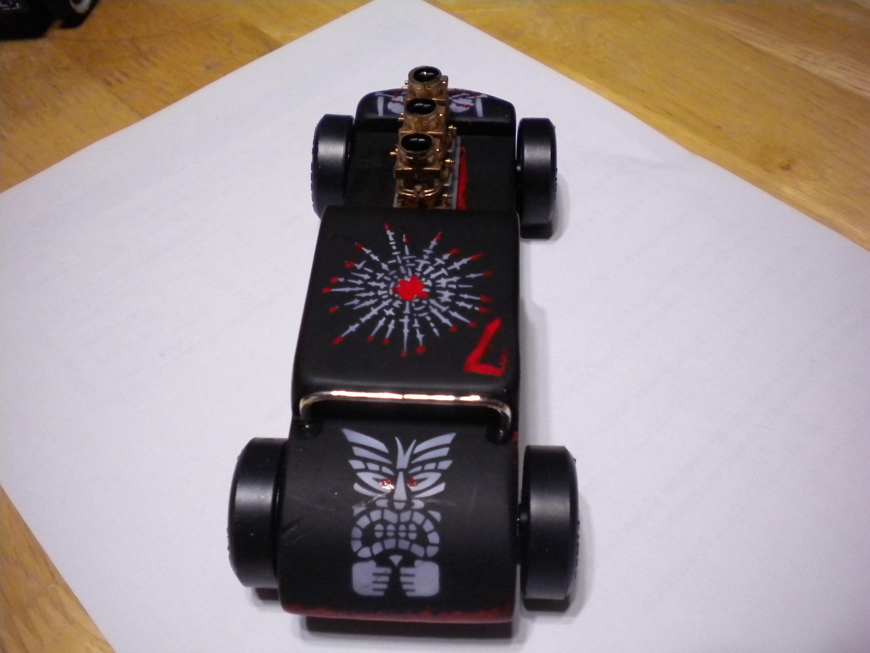

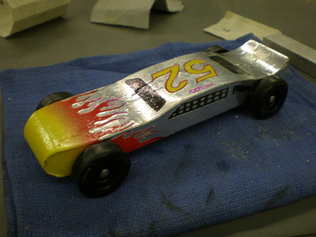

  14. here are the ones we did this year.
