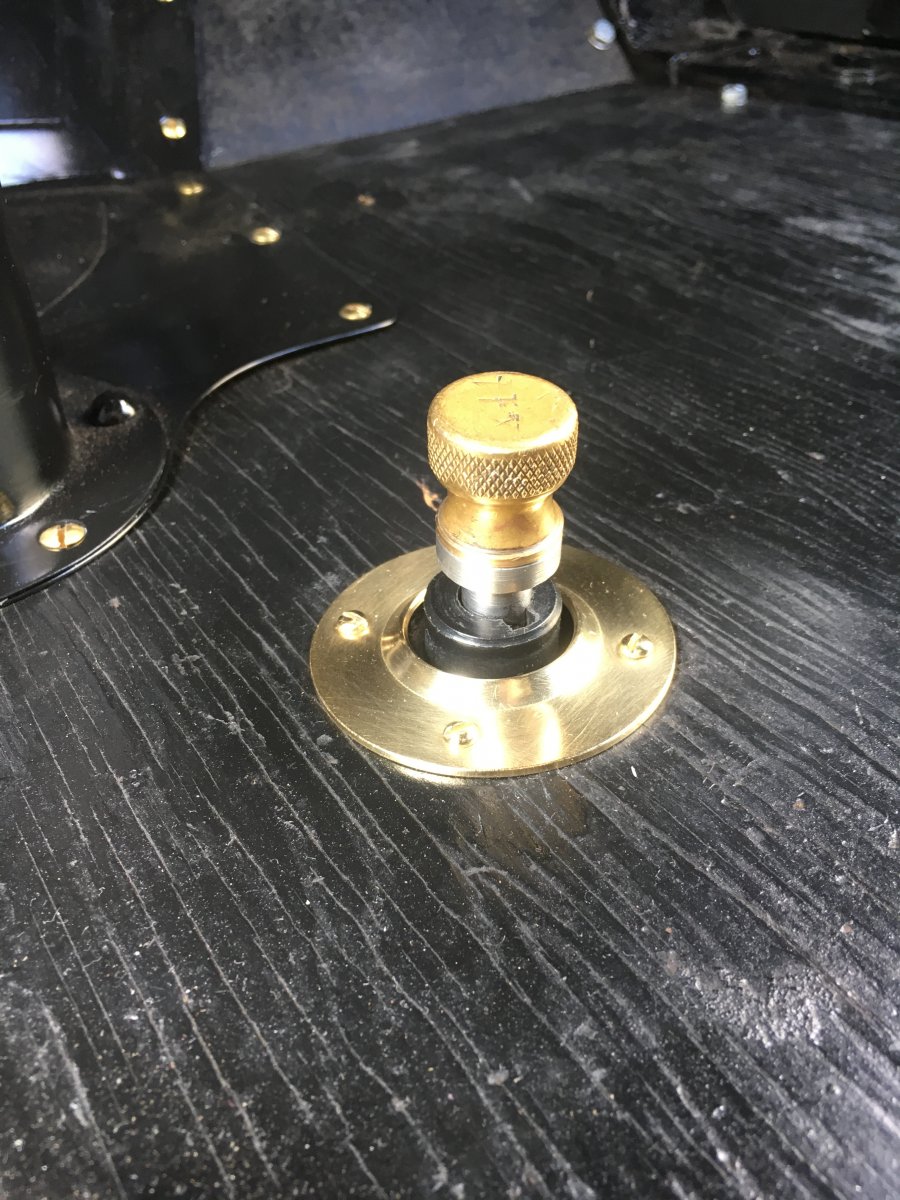

    What is this for? image.jpeg The detail on this rod is absolutely tops!
  11. nutrocker
    Joined: Jan 12, 2007
    Posts: 444
    nutrocker
    That is a battery isolator. I didn't like the big red key you normally get so made my own.

    Do you have a photo of the switch before installation, may have to do something like that on my ride.
  16. nutrocker
    Posts: 444
    nutrocker
    Just like this one.
