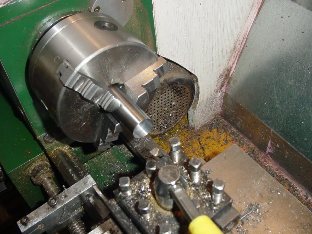

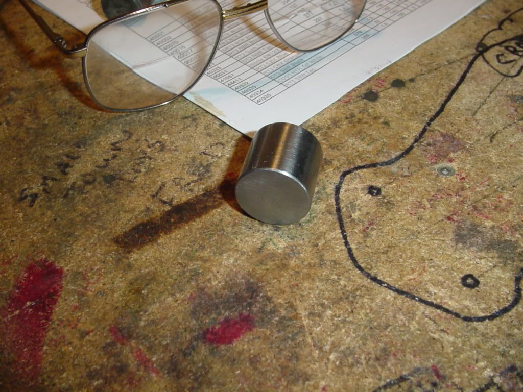

  10. Okay Paul---Here is your extension:eek::eek:---well, the beginning of it anyways. I hunted around in my scrap bin untill I found a peice of 1" dia. steel that was left over from building a crankshaft for a model steam engine. I'm heading into my lathe room as soon as I have posted this.---Brian

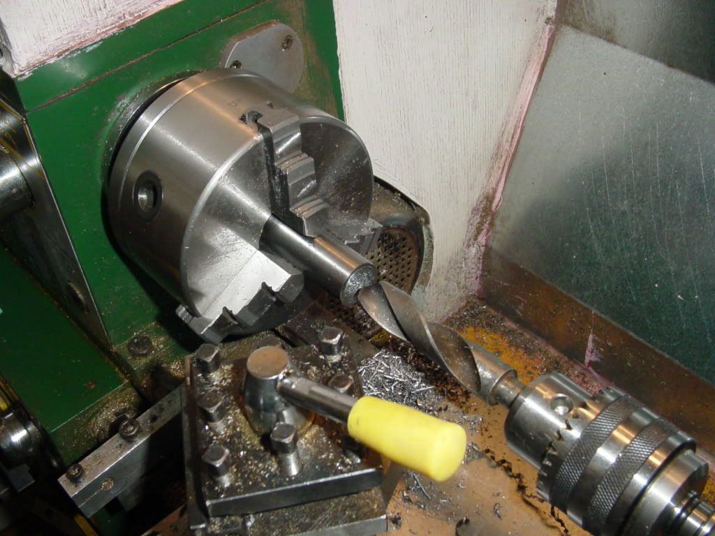

  11. Here it is with one end driled out to 3/4" dia.---Now I will use a boring tool to open it out to 0.878" dia. x 3/8" deep.

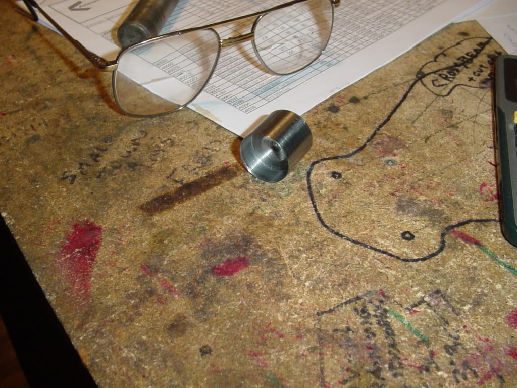

  13. Here we are bored to 0.878" inside dia.

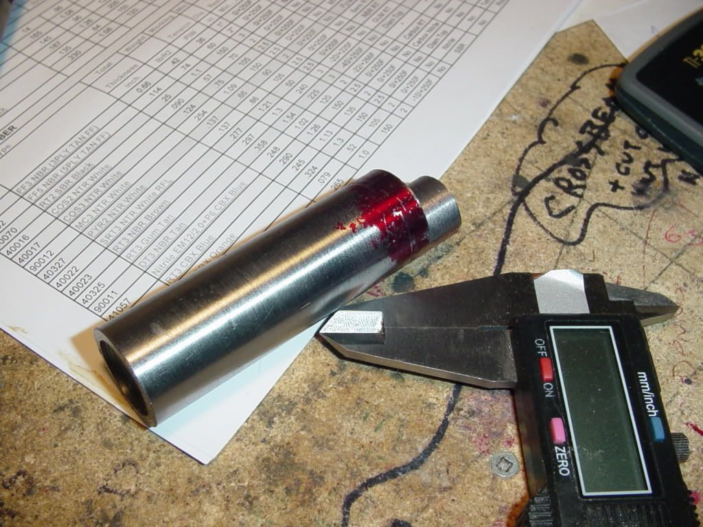

  15. And here we are using the parting off tool to cut the end off--
