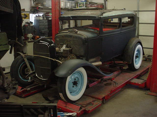

    heres a little update: got some stuff done, lost of welding on the chop done, got the f1 steering mounted, got the wheels bolted on, putsed on the fenders today.

    Wow! I'm out of town for the weekend with my wife and am just now seeing the pics with the wheels and fenders in place. I'm choked up. Just wow! :)
    Jeff, I'll be swinging by your place on the way home tomorrow. I just have to see my baby in person! :)

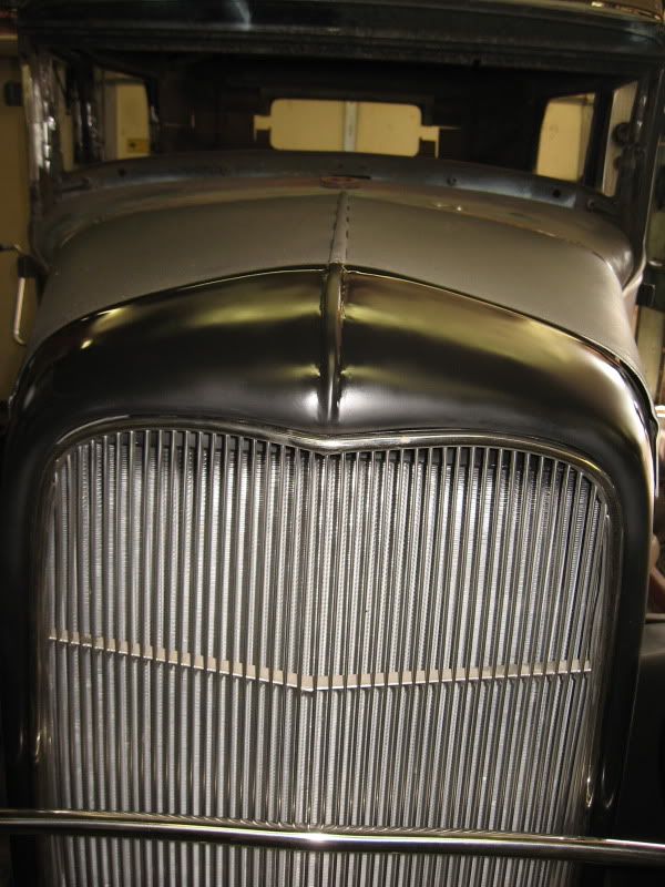

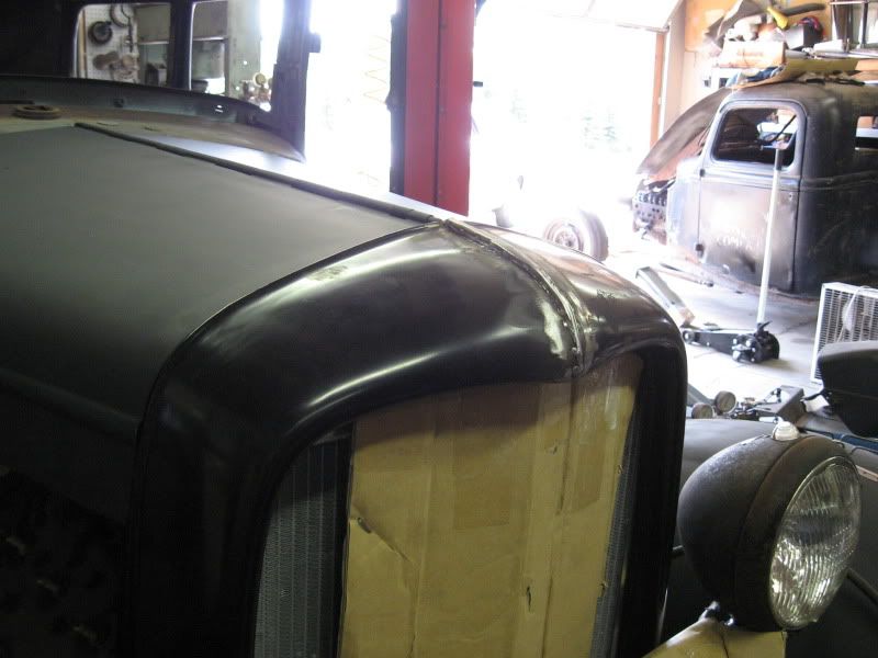

    First we tackled the dropped headlight bar. I had found a cheap polished stainless bar on eBay for the 30-31 A. Since Jeff convinced me to go with the Deuce shell (to cover up my "ugly" aluminum radiator ;)) the bar had to be bent to clear the V in the grille insert. We used Jeff's press at first but found that brute force, a vice and some steel plate got us the desired results. Here's the headlight bar in place with the BLC 904's I picked up at a local swap meet. I had originally set out after some Guide's but dig the smaller BLCs here a bit more.
    With the grille and hood in place, Jeff and I talked about peaking the grille shell to to match the height of the hood hinge. Before I knew it Jeff had a piece of roundbar in the vice and was going to town with a grinder creating a tapered piece for the nose of the shell. Here it is tacked in place.
    Then Jeff got busy filling in the gaps by tack welding along the length of the roundbar on both sides.
    More grinding and filing.
    And there you have it . . . we "ruined" a completely good Deuce shell!
    A little magic with some filler and she'll be perfect. We're thinking of continuing the peak onto the cowl top as well but that will wait for another day.
