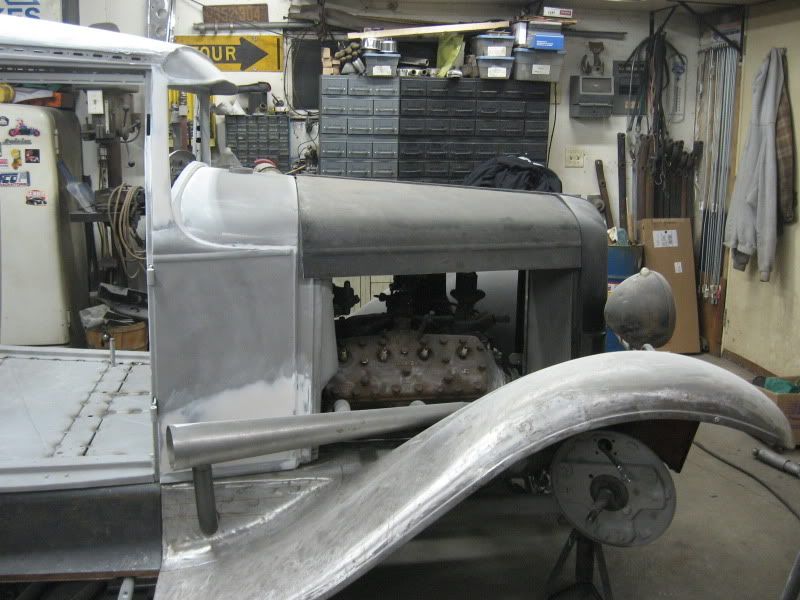

    Ask and you shall receive. Updates from Titus:
    Titus made some downtubes off the headers (Headers built by saltflatmatt www.lakeheaders.com) through the splash aprons. I didn't want a flange on the bottom of the headers or before the apron, so the tubes are welded to the bottom of the header cone and the coupler will be under the apron for a smooth look.
    Right side is looking good thanks to the mudslinger aka thirty two!

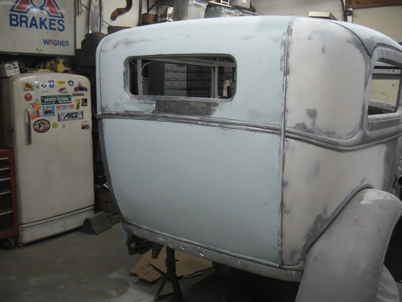

    More progress.
    Floors stitched in:
    Header downtubes done:
    Right side bodywork complete (except fenders and running boards):
    Lots of grinding, shrinking, stretching, beating and mudding on the back panel:
    Good progress. More to come!

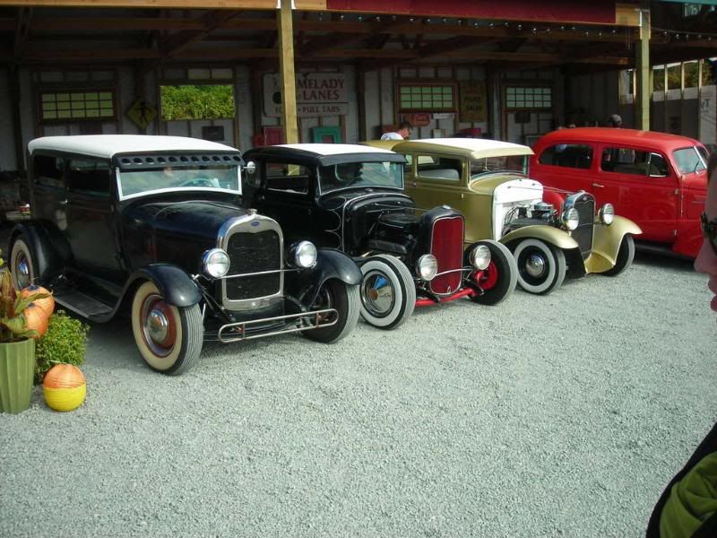

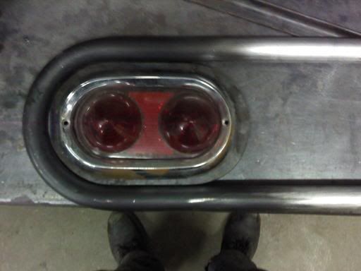

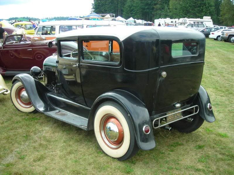

    Initial mock-up of the nerf bar rear bumper and taillights. I've always dug 50's hot rods with nerfs and thought this was the perfect car for it.
    Playing around with adding another curved piece of tubing to create an oval around the taillights.
    Plate added to mount taillights.
    Mock-up. My thought is to skip the second piece of curved tubing around the lights and just add a straight vertical piece of tubing centered between the license plate and tailights, add some tabs to mount the license plate and call it done. It will get powdercoated white. Should look nice with the white headers, white tuck & roll running boards and top and WWW.
    I'm looking for more pics/ideas for the nerfs. Here's a car that's been inspirational in my build complete with nerfs.
