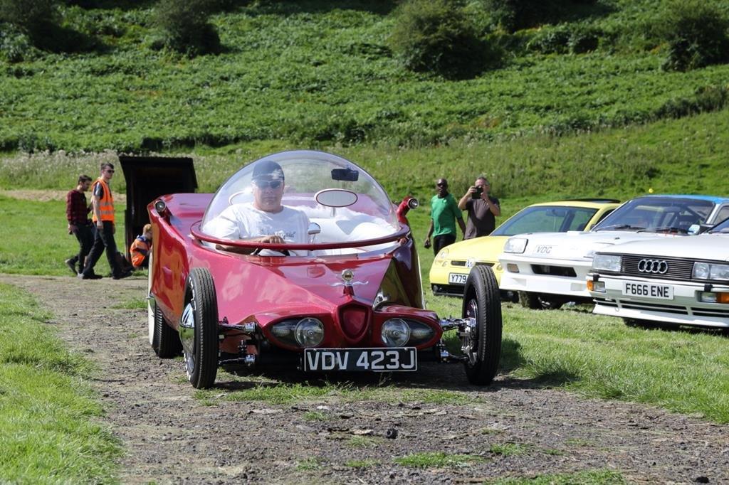

    Built an Ed Roth inspired rod while you were away.
    We must come and visit one day, give you a hand with that Mk2.

  3. belair
    Joined: Jul 10, 2006
    Posts: 9,036
    belair
    Great choice on the colors. They really complement each other. And that Consol(?) is just a great looking little car. The scallops make it even better.

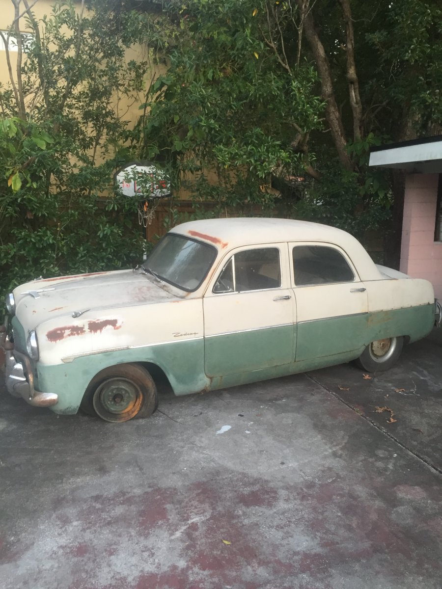

    It still looks solid for a NY car, not many left over here now due to our climate , like you these cars seemed huge when I was a kid
    I always liked Zephyrs/Zodiacs MK 1 -2 and 3s, and Vauxhall Cresta`s E type - PA -PB And PC , I have owned all of these and still have a PB DSC07536.JPG

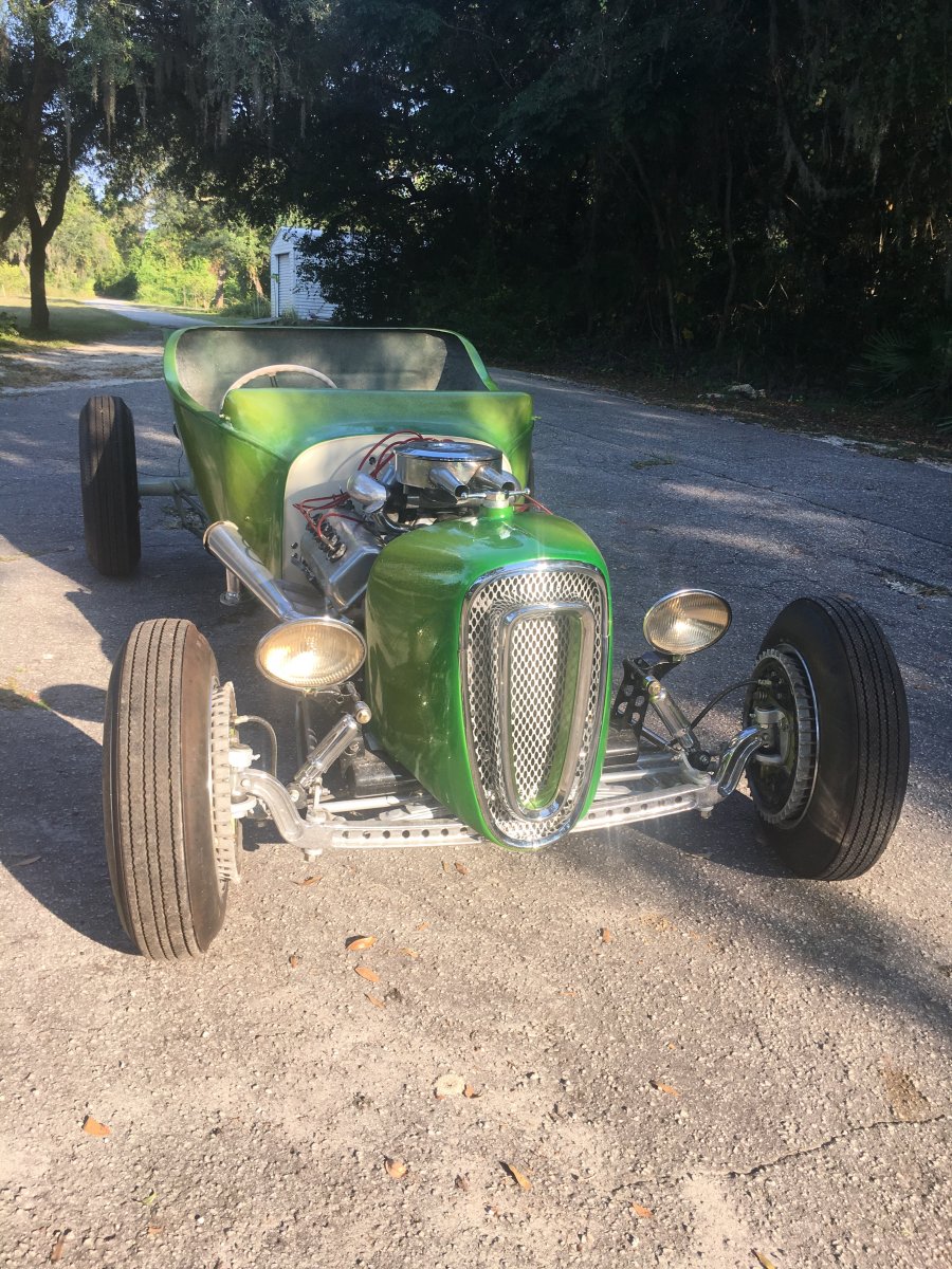

    Great choice with the Edsel grill shell. The rest of the build is out of the box great as well, but that grill shell is KILLER.

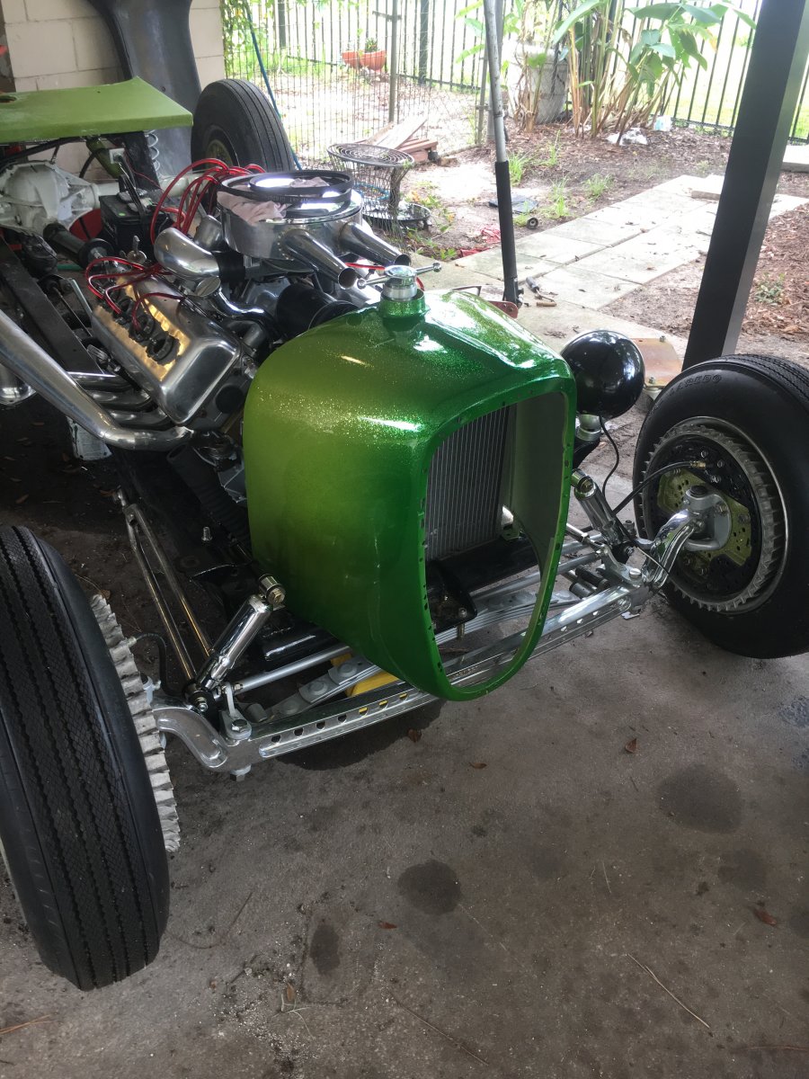

    Maybe shout the old girl a new oil pump and go easy on the revs . These engines have very narrow rod bearings and lack the thrashability factor .Triumph stags had a similar design fault .

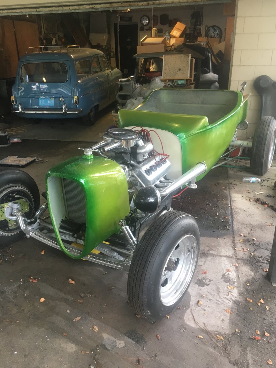

    I love where this is going however I'd include a frame K- member to minimise any torsional twisting and upgrade that brake pedal rod to something more substantial than what's there now.

    Interesting project especially the engine it was designed by Edward Turner same guy that designed the Triumph 650 twin motorcycle. The pistons in the baby hemi are exactly the same as the Triumph 650 Bonneville. Like what you've done with the Edsel grille looking forward to seeing the finished car.

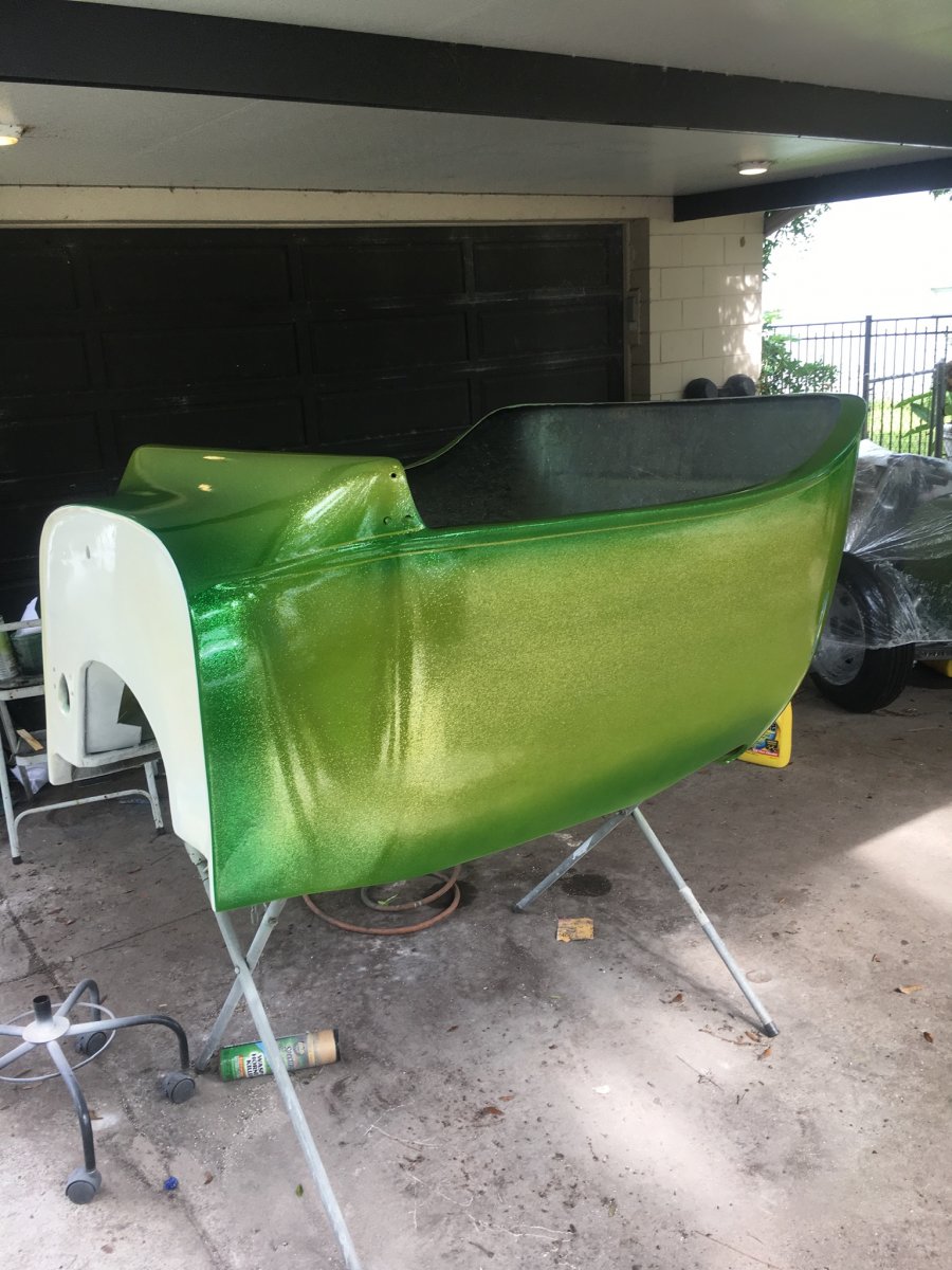

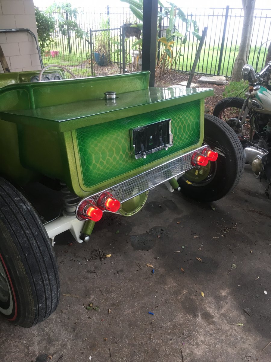

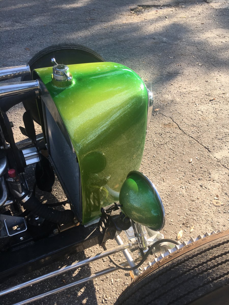

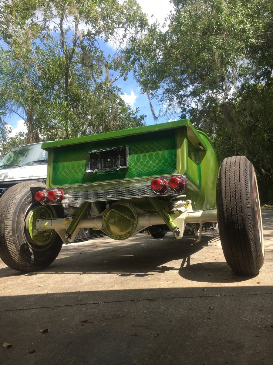

    I talked to Gene Winfield about the paint when he was down here for a cl*** a few months ago and showed him the pics. The comparison to The Reactor is uncanny but that was not my intention or even a thought in my mind at the time I painted it. It’s just how it worked out. AD541419-6147-46C6-979B-F75428312FCD.jpeg 6DF1A065-F363-443C-AF4D-38EDD873272A.jpeg E334586E-B3B0-47EC-A47B-1E7D59218EF9.jpeg 66768DBF-28F4-41F5-A550-D61288000EB2.jpeg

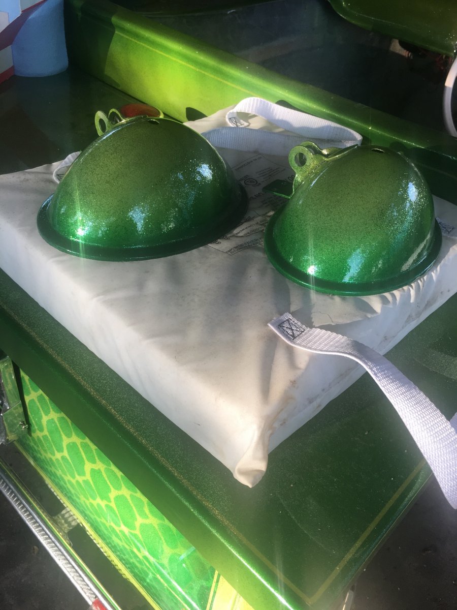

    I found these S & M oval lights that are from the 30s, I think. They aren’t era correct for this 60s style build but I think they look pretty cool. I put LED bulbs in them and they are bright. You can’t see the modern innards 759175FC-691C-4236-AE55-4F9F991B7DD5.jpeg 742EAEC3-7A80-455D-BA7C-CA48F23BE793.jpeg C2E55321-8EB6-4880-B7AE-125B58574921.jpeg

    Not sure of where I was headed with this build, I just sorta winged it and it came out like this.

    I think the headlights work with the overall theme of the car. They may not be " '60's correct" but they look "right". I love the paint - it really pops! I also love the ch***is detail with the painted backing plates, shocks, and differential cover.

    Hi Nads, good to see you posting. I dig the hell out of that little car, you did a hell of a job. Could I talk you into doubling the diameter of the brake push rod? It is a bit dinky for the length and the force required to actuate the master cylinder.

    Also, your advice is taken on the push rod, I can easily make it larger in diameter.
