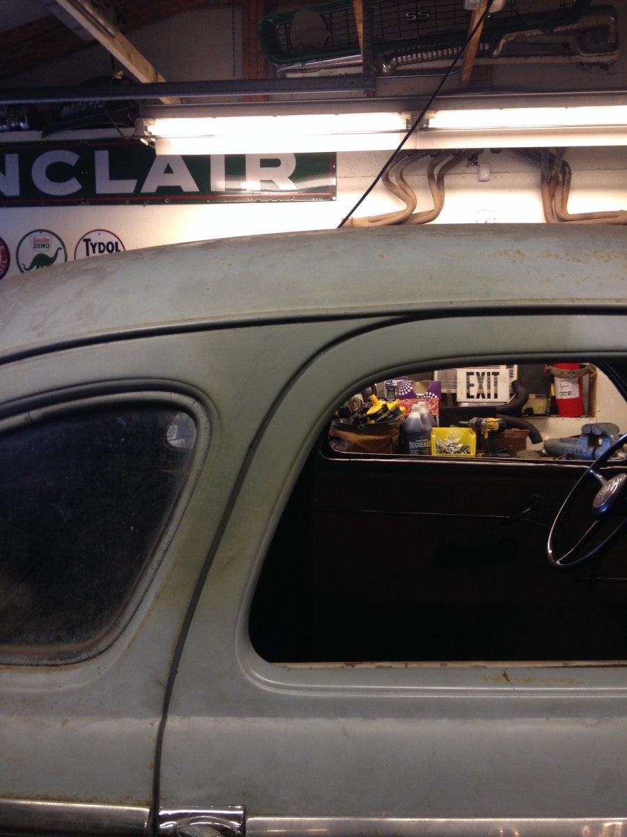

  4. The business coupes had the flat rear window, the club coupes had curved gl***. I’ve always wanted to swap the rear window on mine for a two Piece or curved unit.

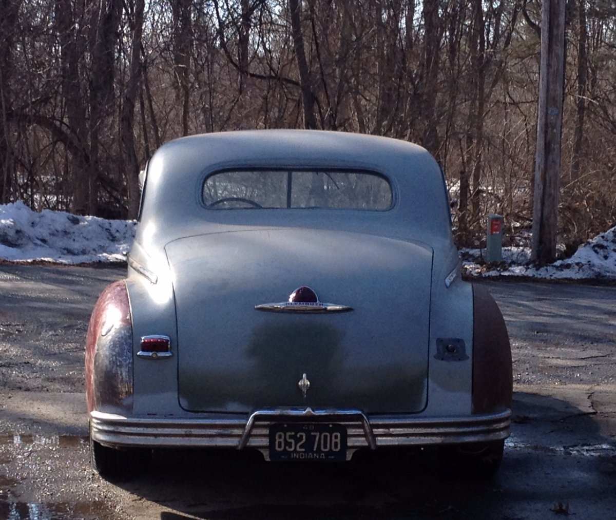

  5. Here’s a few pics of my 48 Plymouth business coupe. Just a few Kustom touches. Bumpers, rounded door corners and lowered. I’m on the fence as far as molding the fenders, on one hand I really like the stainless welting these cars had and on the other hand the body shape is perfect for molding the fenders.
    1813E8B9-1D49-46D0-910F-FDE8C9B32706.jpeg 422E6516-F8ED-40E2-8089-6F59E94282A0.jpeg 97C96A94-8517-4D92-831D-1F932821A7AB.jpeg
  6. By the way, your car really looks cool as it sits.

  7. Not being a nitpicker but the short roof coupe like my 1941 Plymouth used that body shell from 1940 to 1948, with the 1940 & 1941 cars also being available with the ASC or Auxillary Seat Coupe option which was small folding seat bases behind the split bench front seat and a lift up rear seat back that the small seat bases folded up behind leaving a large carry space.............in 1942 the Plymouth Club Coupe with a full size non folding rear seat was introduced, this model had a longer roof and rear side windows and continued this body style till 1948.....the original short roof coupe body shell continued till 1948 as the Business Coupe and was only available from 1942 with the split bench front seat, if you wanted to carry more p***engers you got the long roofed Club coupe...........Dodge, DeSoto and Chrysler introduced their 3 window Business Coupes in 1941 using the same doors that their longer roofed 5 window Club Coupes used, both body shells being used till 1948........andyd

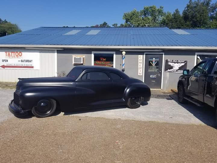

    Nice build. My buddy recently sold his 48

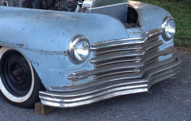

    Stumbled on the pictures of sectioning the bumper. 2.5”.
  13. j hansen
    Joined: Dec 22, 2012
    Posts: 11,759
    j hansen
    Did you start with stock -49 Plymouth bumpers and......did what with them?? Skärmavbild 2019-11-13 kl. 16.37.00.png
    40two and anthony myrick like this.
  14. Scotty........I too would like to know how you made the bumpers, they are a very neat distinctive custom touch.........andyd
    j hansen likes this.
  15. Heat and beat! The middle 5-6” is actually two pieces cut at a bevel then welded together then to the curved outer pieces. I think I have pics on my laptop at home I’ll look tomorrow.
    Yes those are 49 Plymouth bumpers. Between the front and rear it took part of a third one.
