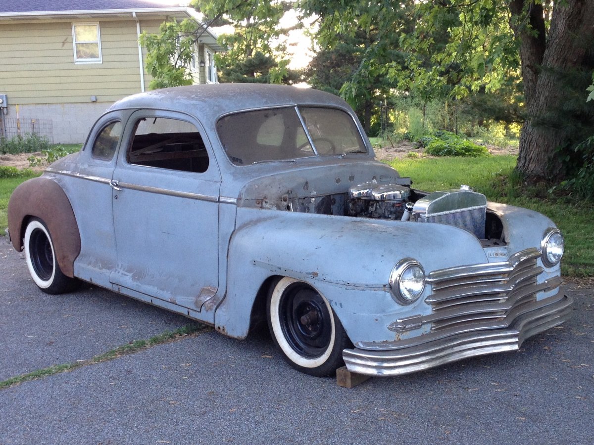

    I have a 39 Plymouth but I'm put a little move power in mine. IMG_20171029_091643708.jpg IMG_20190914_120702418.jpg

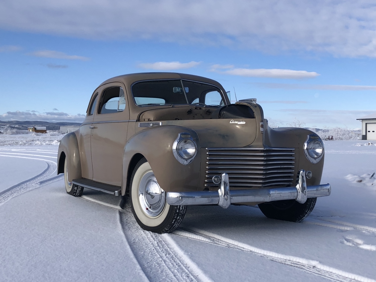

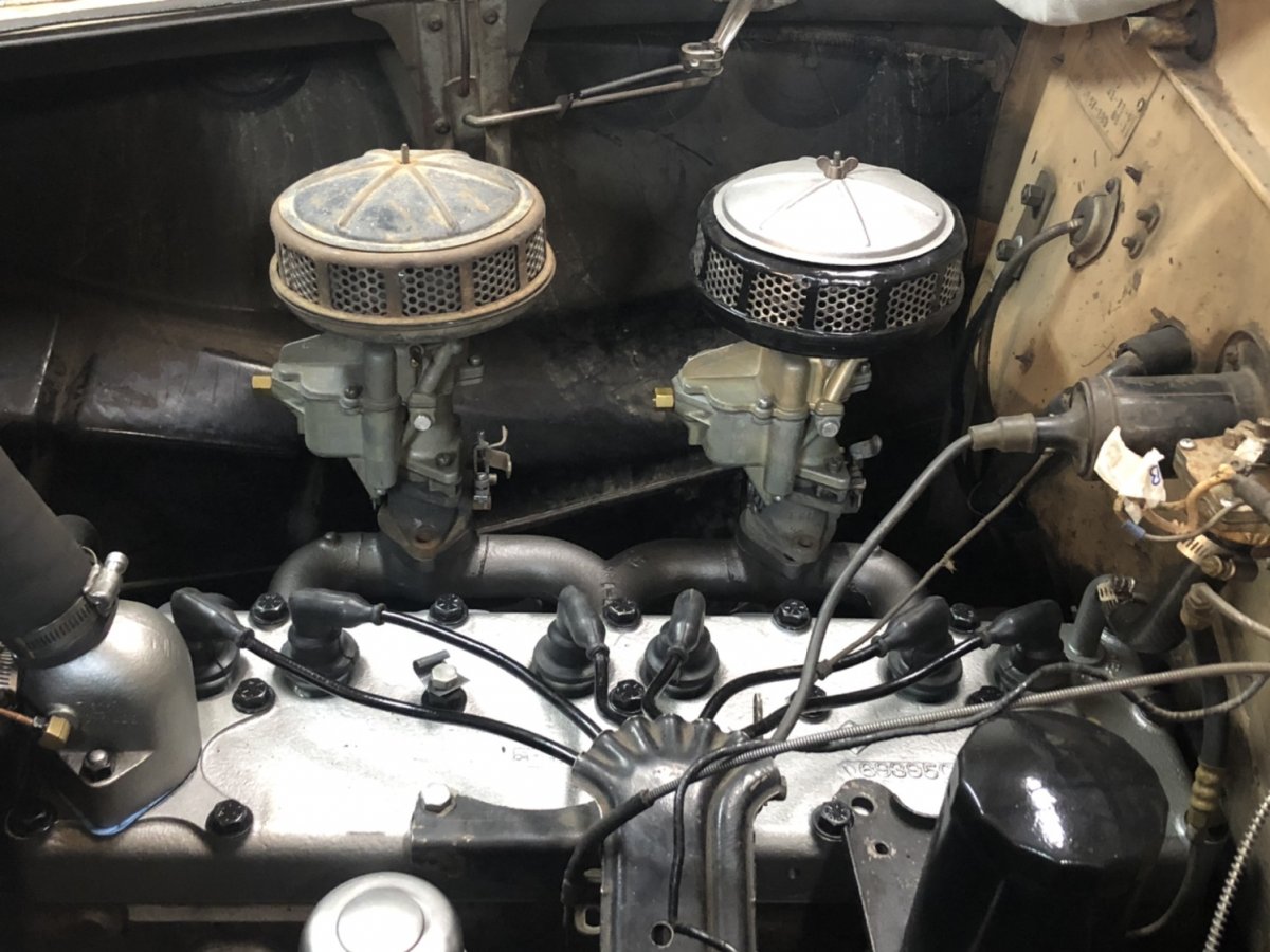

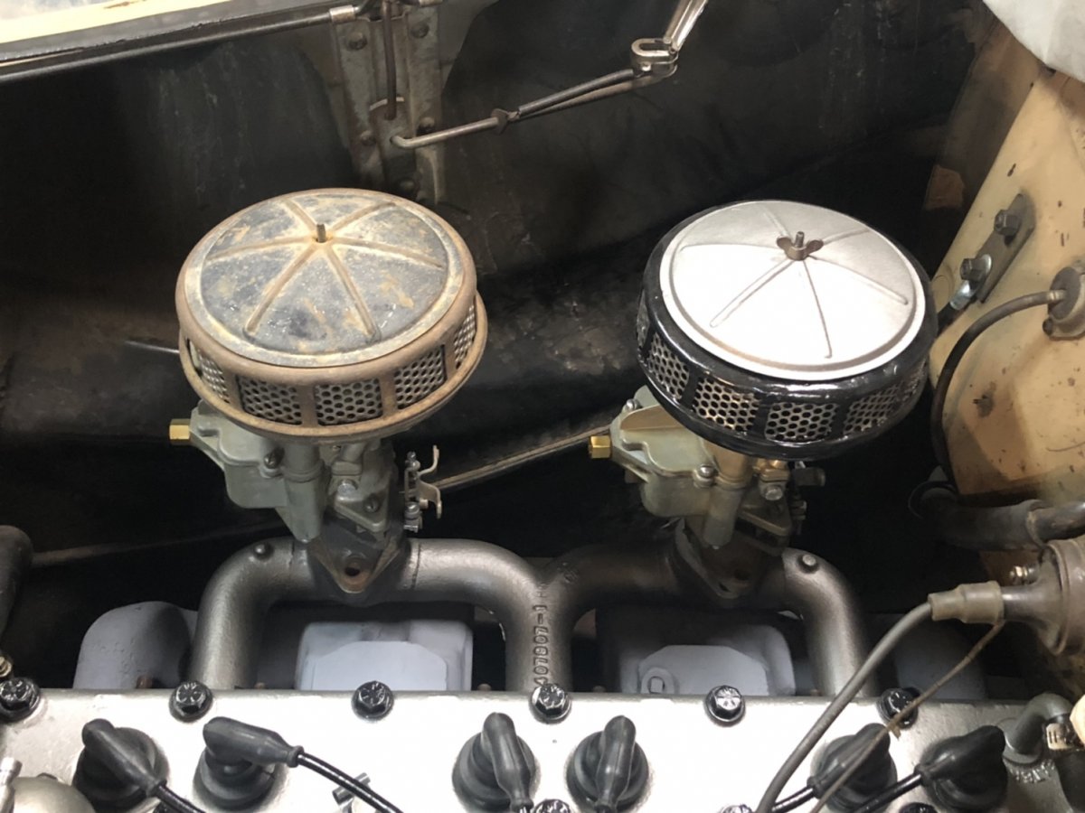

    Huge snow storm today. When the power stays on long enough I’ve been out buttoning a few things up. Then decided to mock up the intake and carbs. Boy this should be fun this spring.

    Will you need manifold heat?
  10. sodakmini
    Joined: Jun 28, 2011
    Posts: 518
    sodakmini
    No. I looked into it a bit. If anything I may need to let it warm up a bit longer. Which I normally do anyhow. I’ve found a lot of people running similar setups
  11. If you've got the room, and the ambition, you could splice into a heater hose and add a section of copper pipe which could be mounted the length of the bottom of the manifold from front to rear. Easy to attach with a couple of clamps. Maybe not the quick heat like you'd get from the exhaust manifold but would still help with fuel atomization and to prevent carburetor icing.
    Maybe fab up a long "U" shaped tube so the inlet and exit would both be at the rear so you don't have to snake a lot of extra heater hose around under the hood.
    chryslerfan55 and sodakmini like this.
  12. sodakmini
    Posts: 518
    sodakmini
    I’m not sure there will be any room. It hugs the exhaust quite close.
  13. You're right... I went back and looked at some of the manifold pictures above. :oops: They've got the exhaust snuggled up pretty tight under the intake, but then the carbs are quite a way above that. :rolleyes:

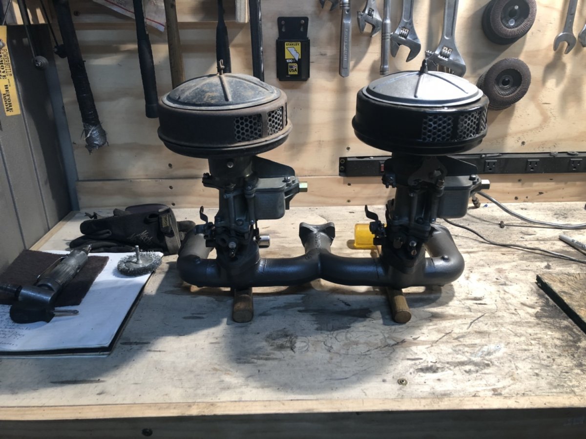

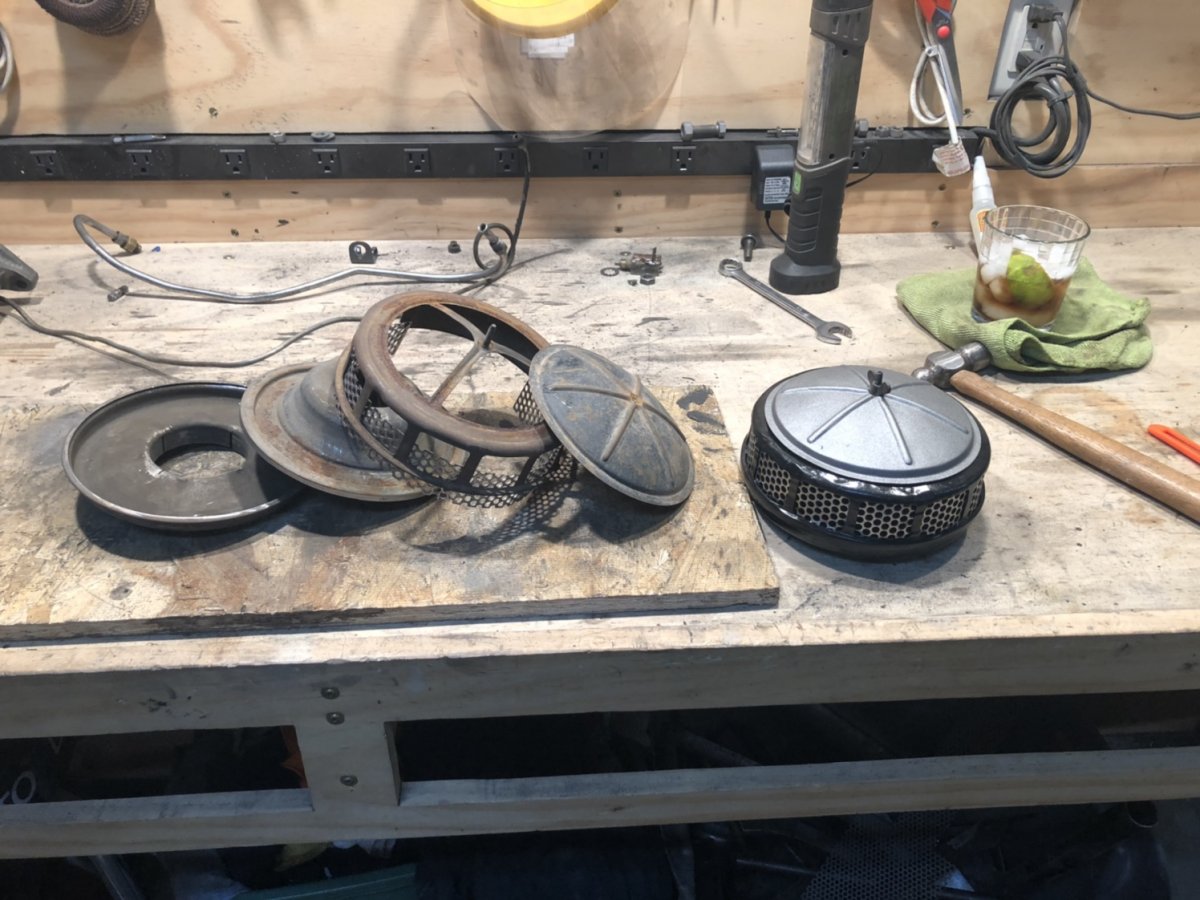

    Started working on the 2nd air cleaner tonight. Got a bit left. Did some mock up to see how high I can raise the carbs. IMG_8825.JPG IMG_8826.JPG IMG_8827.JPG IMG_8828.JPG
