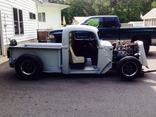

  2. Here is a pic during the build of the rear Panhard Bar. That rear ain't going no where.

    This truck belongs to a good friend of mine . He's been driving the heck out it for several years on Pennsylvania and Ohio roads . Bill

  12. 48stude.....That thing looks killer. What I was going for initially but found my own direction and look forward to getting it on the road.

  21. Here are a few pics I took yesterday. The stance may be correct but the fact still remains my spring unfortunately is 3" too long. The new spring will be the correct length and my shackles will actually function as designed. If you look close you will see the one side pic with the jack under front cross member lifting it 2". This 2" lift translates to just over 1" at the frame under cab which will give me just over 4" clearance.
