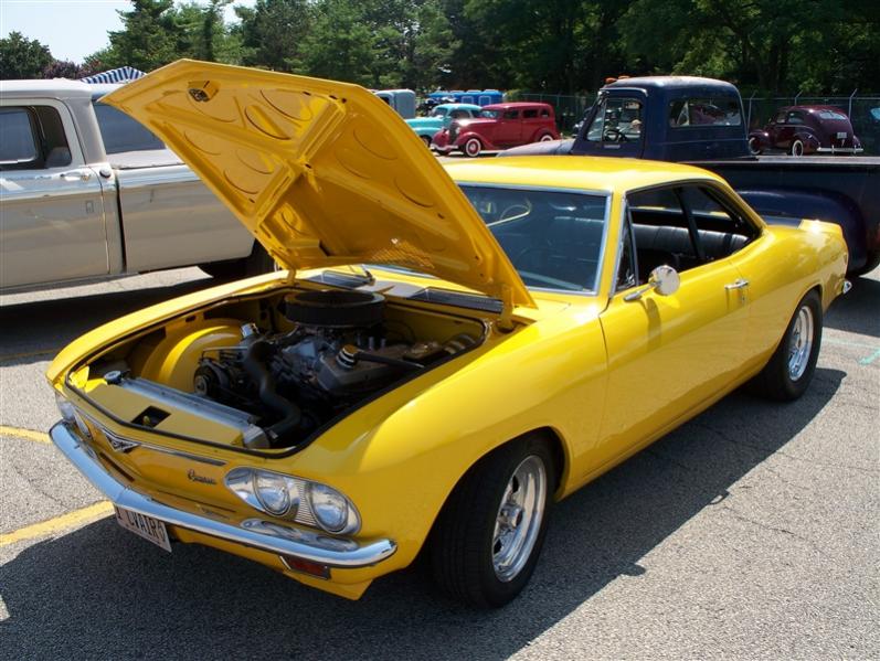

  30. Saw this at Louisville this year. My teeth about fell out when he popped the hood and showed us the 455 Buick in it.
