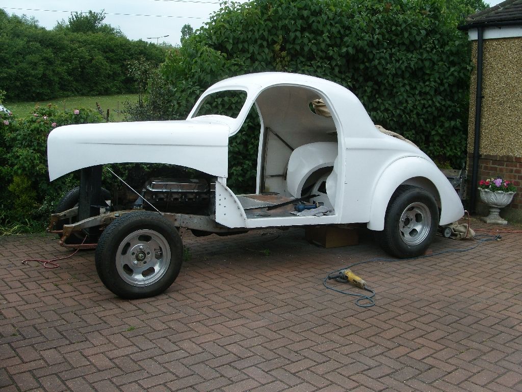

    Well the rain has gone for a while and the sun is shining again so managed to get a few things done.
    After a bit of tooing and froing i think i have the hood just right.

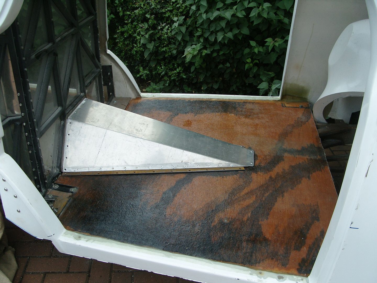

    Made a template of the trans tunnel and then bent it up in a bit of aluminium sheet that was kicking around, I made a steel mounting flange that is screwed and glued to the floor and the tunnel screws to that with small countersunk machine screws.
    Managed to get the floor gl***ed into place as its a job done thats been bugging me. First i flipped the body upside down and trimmed off the lower sill return to 3/4" wide (this makes it easier to get the body on & off)
    Then the areas that needed keying were marked with a felt tip pen as its difficult to see where you have been with the white. Used and angle grinder and finger sander to key it.
    Next the floor panel was bolted back into place with 3 layers of mat & resin in between the flanges, then a further 3 layers were added at the top & bottom of the joints, Then 1 layer was applied to the underside of the floor.
    Once the resin had hardened the body was put back on the frame and matting cut to shape for the inside.
    As per the underneath everything was gl***ed in.

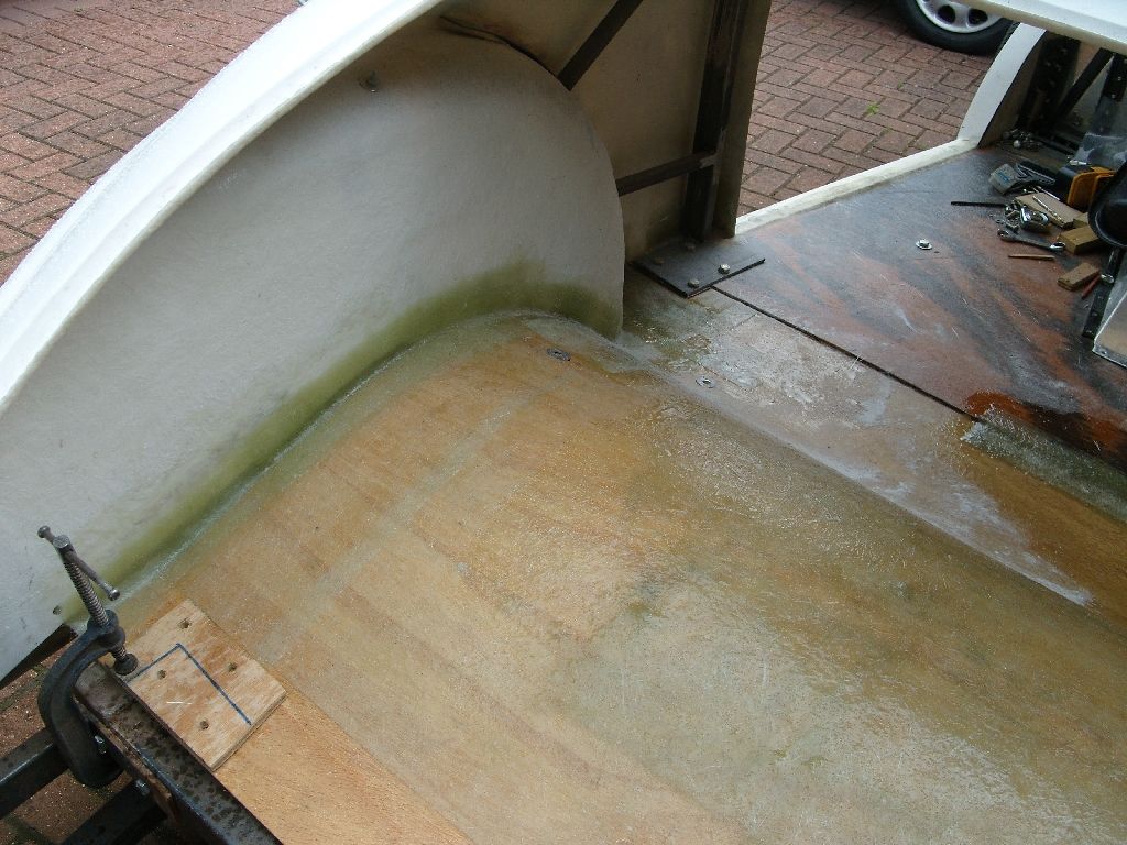

    Well in between the showers i managed to get the rear floor gl***ed in, I used a sheet of Bendy ply for this as the rear ch***is kickup has an S shape in it and i wanted the floor to follow the shape, Bendy ply is made with the plys running the same way and this allows it to take very small radius's, you can order it to be bendy along the 8' x 4' length or sideways across.
    First the shape was cut into the sheet and then the ch***is was drilled and tapped 8mm, this was then bolted down with penny washers to keep it all flat.
    Next the perimeter was gl***ed in and 1 layer put over the complete panel.
    The ply only comes 8' x 4' and the body isover 4' so it was done in sections, here the rear section is in position but not gl***ed in as i ran out of resin :(

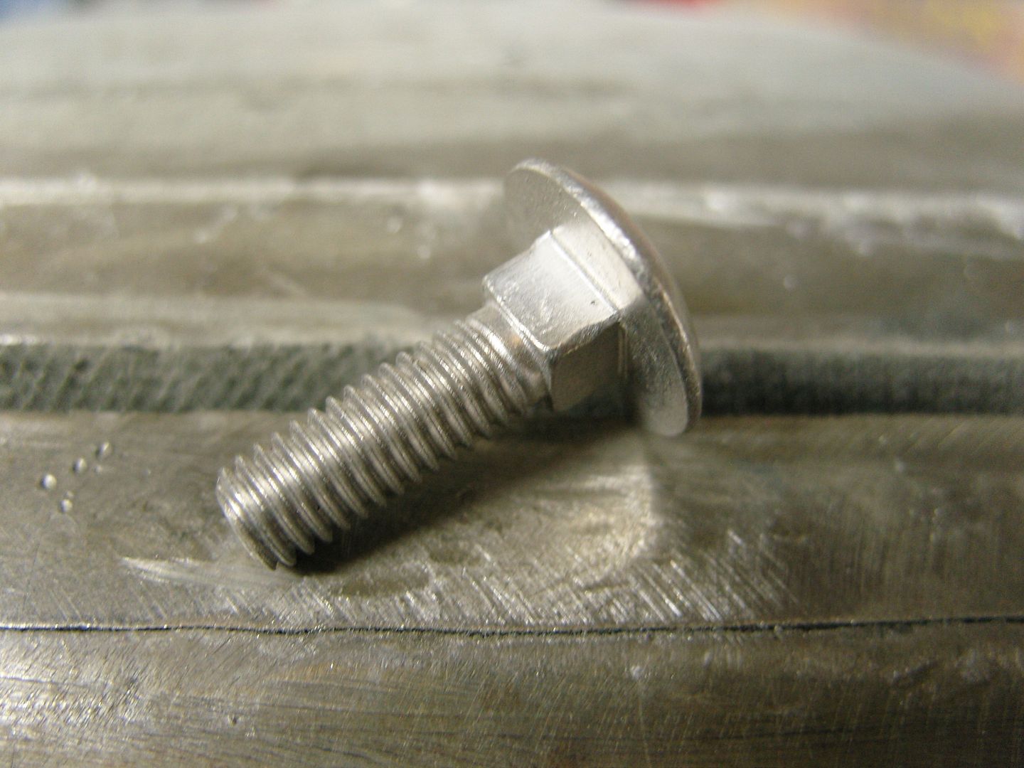

    Most of the grille got cut off as the Fairlane is a much bigger car, the grille is held to the front panel with some ground down coachbolts, the heads were ground down and given a polish.
    holes were drilled and filed square for the bolts to register in.
