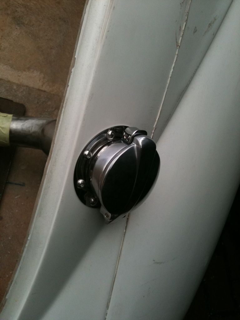

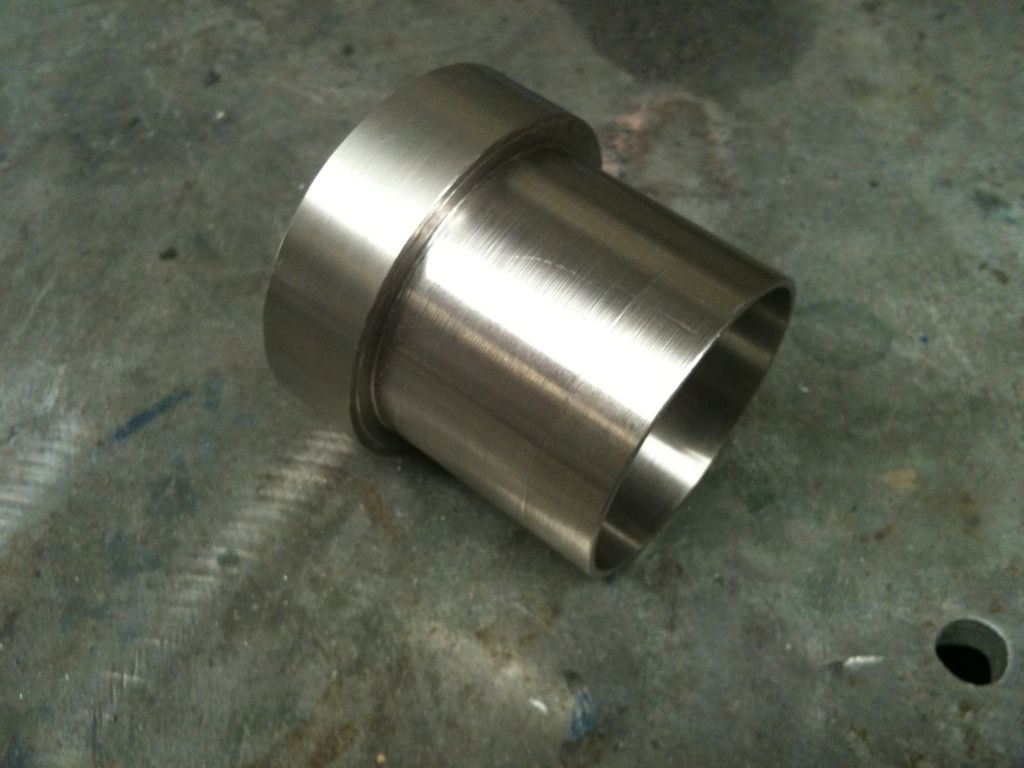

    It was raining here last evening so i had an evening on the lathe sorting my fuel filler and column drop.
    I found a lump of 2.5" stainless round bar in the s**** bin so managed to get both bits out of a chunk of it.
    Started with this
    And produced these
    I had an old motorbike flip cap laying around so gave it a repolish and made a flange from a bit of sheet stainless, put it together and got this
    Made up a couple of tapped spigots and welded them to the boss for the column support, The bolts that hold the rose joints in place also hold the collar in place on the column, they have points which engage in small holes in the column outer.
    Fitted the filler cap and it had stopped raining so made up the filler tube from some stainless bend offcuts, nothing wasted here.

    That fuel filler is awesome man! Looks great.

    Thanks, i'm pretty pleased how it turned out.

    Not that you need to be told this but make sure that the flip cap doesn't beat against the body when opened - for the rest of us stealing all these great ideas!

    First thing i checked buddy, clears easily, thanks.
