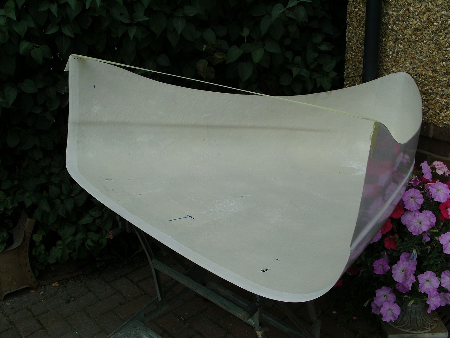

    Now the doors are virtually there i started on the hood, Its taken a couple of evenings to get right but i found the best way was to get the hood lined up with the beltline and then adjust the fenders to suit,
    It fits pretty well but being a single skin it tends to be a bit floppy so needed a little bracing here and there, first i attended to the rear side corners that stick out a little, it needed a simple brace on the curve to keep it in the right shape.
    A bit of measuring and a piece of tape to keep the sides constant and work progressed.
    A piece of 3/8" ply was cut as a stiffner and the area keyed up, the ply is held in place with a few blobs of body filler. Then matting applied, no picture of the matting going on as my fingers were a bit sticky.
    Here its fitted back on the car, 32 hood hold downs like they used back in the 60's, apart from a bit of blending and fettling of the gaps its virtually there. There will be no tight door gaps here as Willys were never known for their great panel fitment, don't want it too perfect otherwise it will look like a glass car

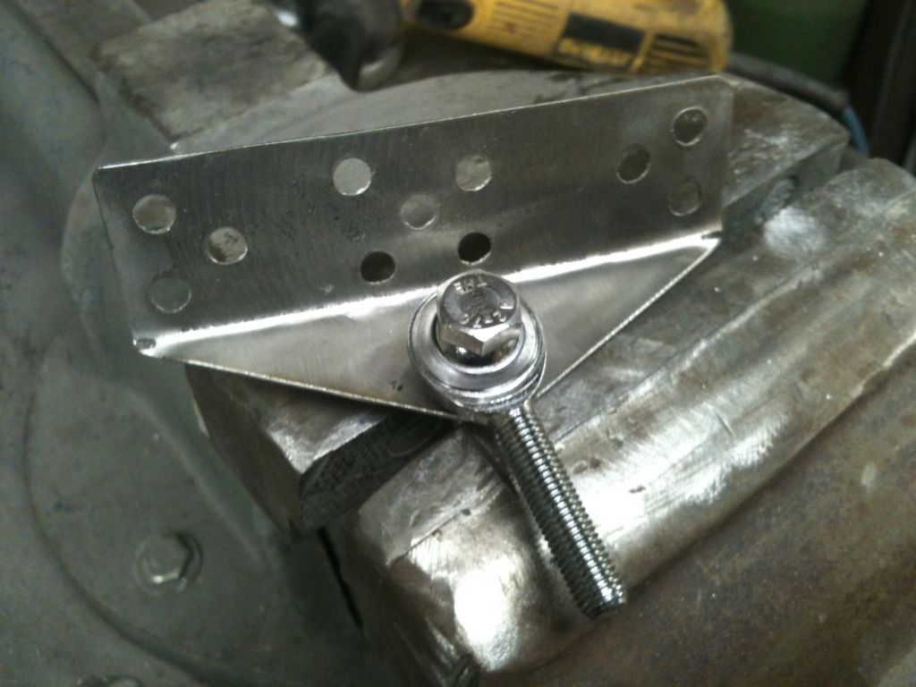

    After getting the hood 99% sorted i moved onto the fenders, they needed a bit of support as there is no inner fenders and I don't intend to fit any.
    My solution was to add a few adjustable bars to support and adjust the fender to hood clearence.
    The bars use 5/16" male & female cheap joints, The tube is 3/8" OD x 14swg wall so i could tap dierectly into it.
    The bars pickup on the radiator bar lower mounts.
    A piece of 2" x 1" wood is a temporary prop. The rear mount is glassed into the fender, it has holes randomly drilled to aid with the bonding.
    Sorry this bit is a bit boring but i know there a 3 people who bought bodies from me and it may help them.

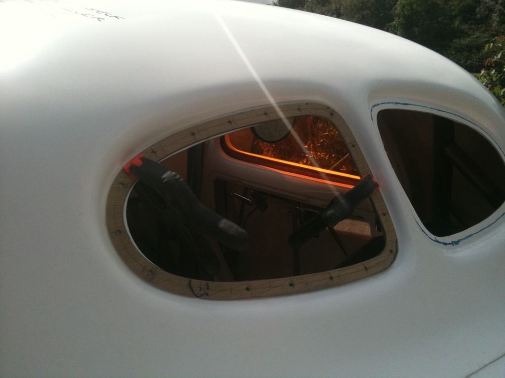

    What a weird day today was, an hour of sun then a rain shower and then back to sun again, been like that all day, anyway during the dry patches my trusty helper Gomez came over to assist in sorting the rear windows as I needed 3 hands.
    First job was to make a template
    Then the shape was transferred to the acrylic sheet and marked
    This is Gomez being humerous, little things please little minds !!!
    Next the holes were marked for the 3/16" button head screws, also the inner was marked & cut out.
    A quick check of the fit, all good.
    The template was clamped to the body and the holes drilled.
    Next the holes were transferred to the acrylic.
    Next the windows were bolted in. I was going to paint a black border around the window but i now have a better idea that will look like they are in rubber, stay tuned.
