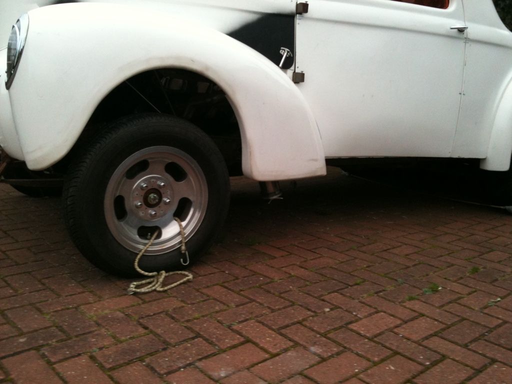

    As I said earlier the wingnuts were temporary, after searching the net for some tri eared spinners and not finding anything suitable i decided to make some instead.
    First i started with some stainless acorn nuts and turned off the hexagon part, next some ears were cut from 3/16" stainless and blended & fettled and pre polished, next a small jig was made for TIG welding them, then more polishing, then i had some custom tri bar wingnuts that i could tighten by hand :D

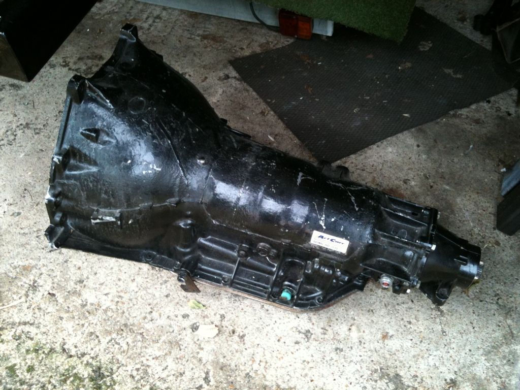

    Thanks to Jason (fatguyz) who collected my TH400 from Steve & Mitch (thanks boys) who in turn collected it from Zane at Zannetec (more thanks Zane)
    I bought the Art Carr with Transbrake box secondhand with 2nd gear slipping and Zane kindly rebuilt it for me, I would highly recommend Zane he does an excellent job and is a nice old boy too :D
    Over the Autumn i need to strip it back to bare aluminium and epoxy prime and paint Porsche India Red to match the motor and also fit the larger capacity aluminium trans pan i have.

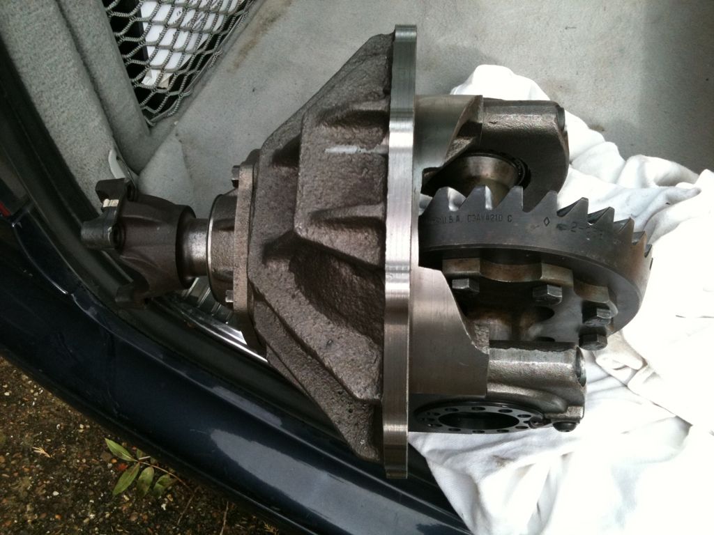

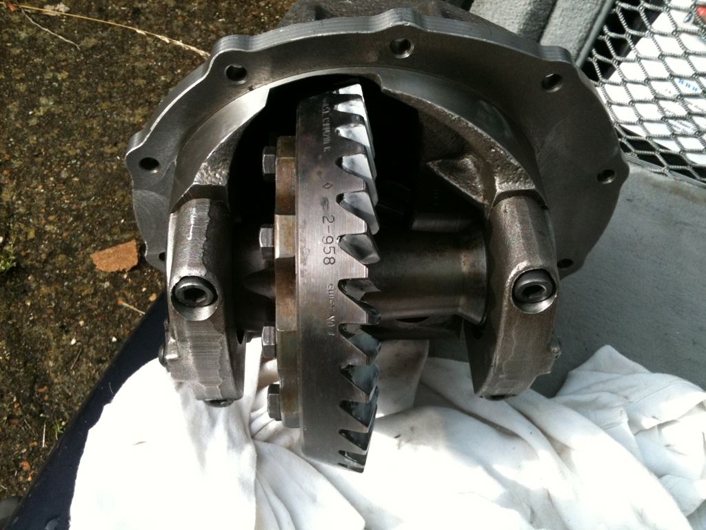

    Another recommendation is for Paul at Southern Axles, Paul has been racing for years and knows his stuff, His shop is only a block away from mine so was the obvious choice to ***emble the axle parts i had collected, Diff case is a brand new item with 3.89 Zoom gears mounted on a 31 spline Spool, with a 1350 yoke, all new bearings etc etc, again this needs to be epoxy primed and painted, i'm not sure what colour the back axle is gonna be yet, suggestions welcomed.

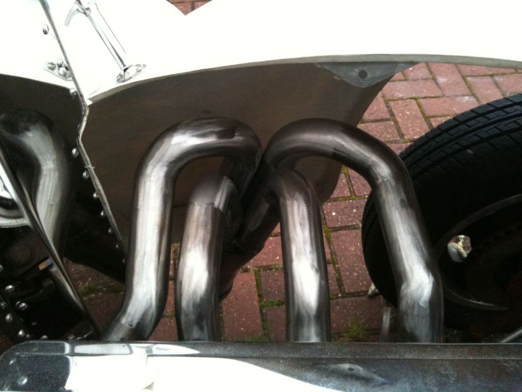

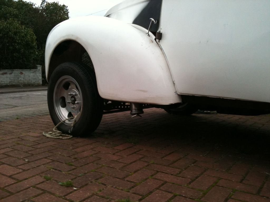

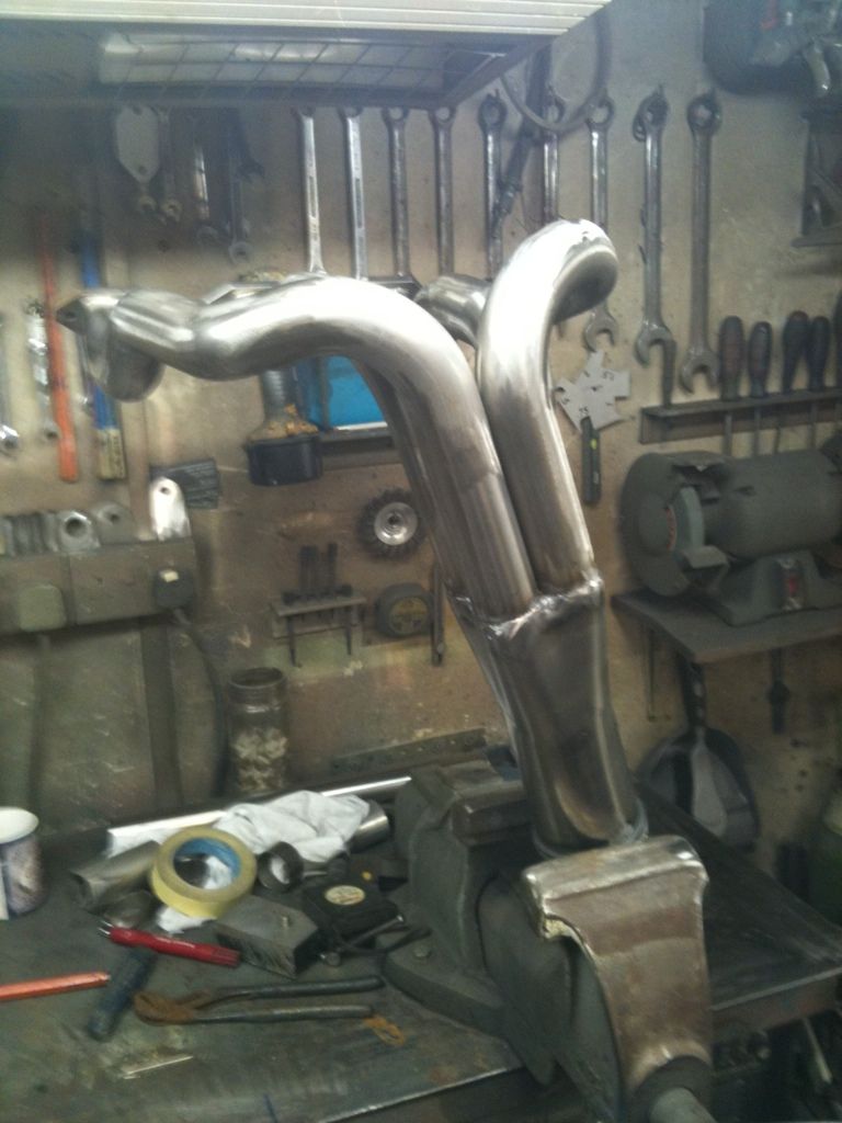

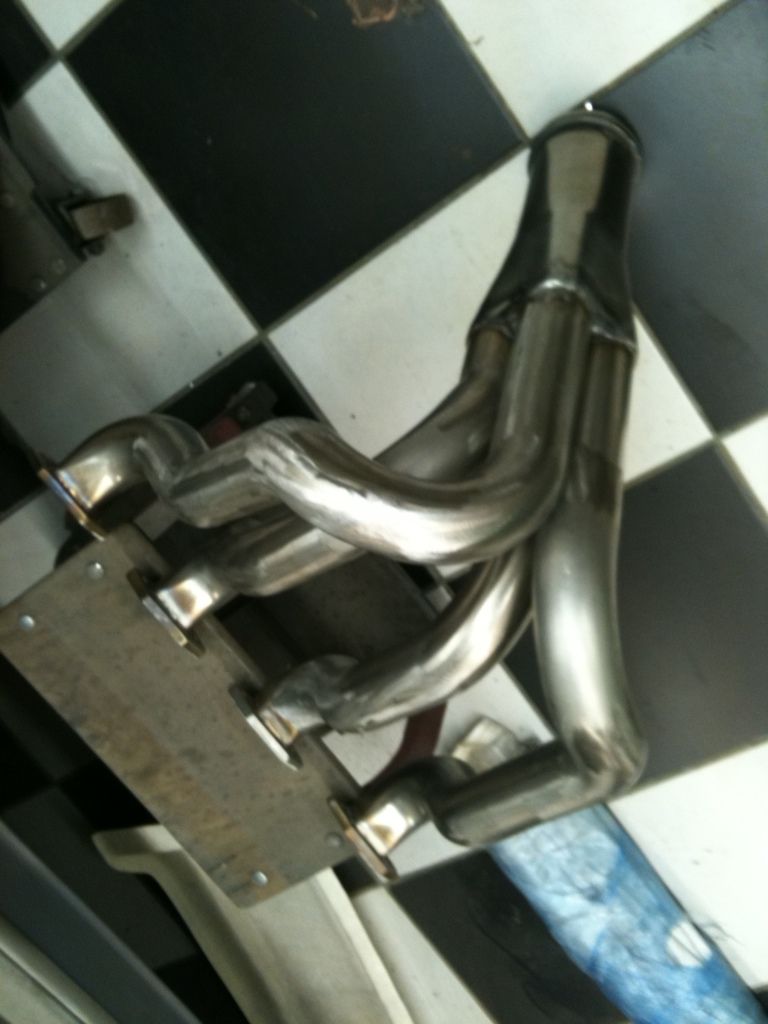

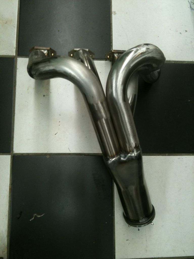

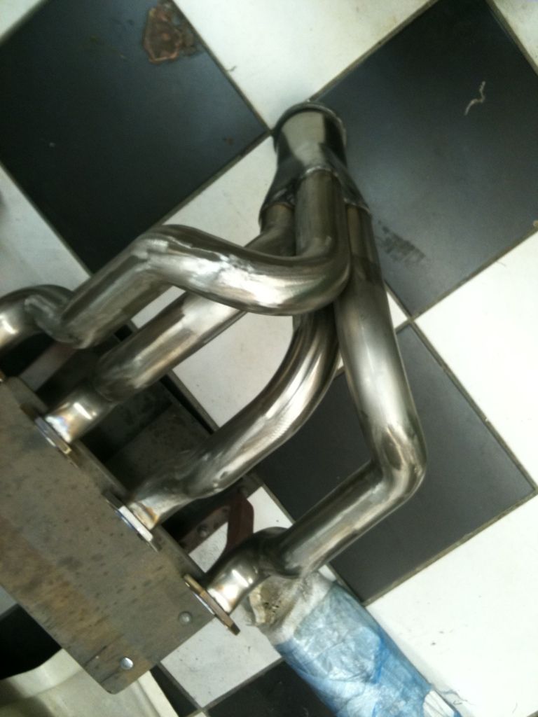

    On saturday i finally finished the drivers side header, took longer than i thought !!! Now the really hard part is making the other side match.
    I just wanted the bottom of the collector showing and easy access to the wing nut for uncapping.
    Its getting dark early now, winters coming !!!
