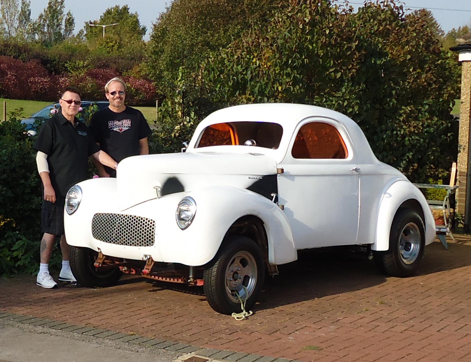

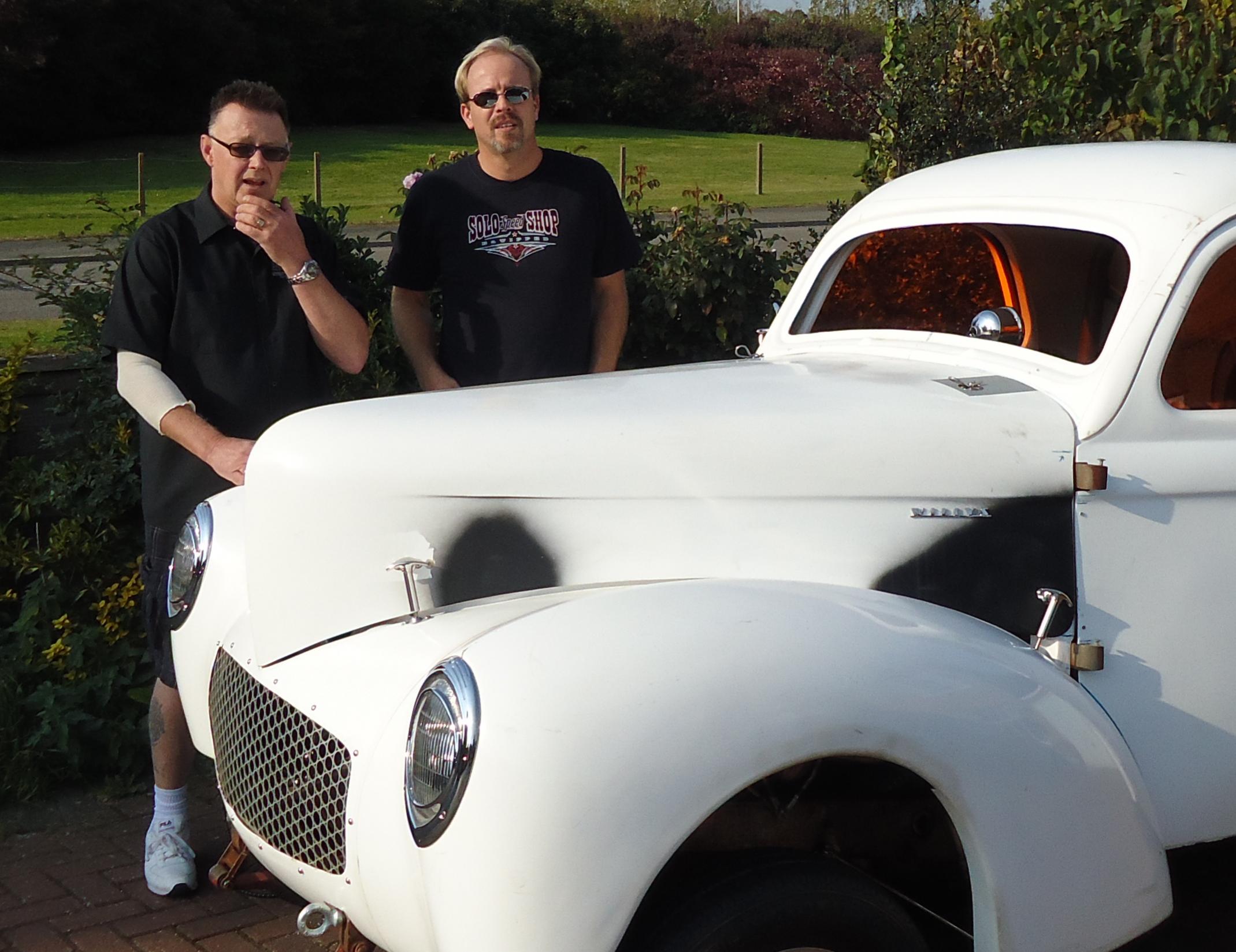

    Great fabrication work there Langy. Just so all you guys know what this gentleman looks like, here's a pic. That's him on the left. (and no, I'm not standing on a box.) It was awesome to meet you last week Steve!

    I'm jealous, both you guys are excellent car builders with GREAT hair!
  24. 1971BB427
    Joined: Mar 6, 2010
    Posts: 9,816
    1971BB427
    from Oregon
    Glad you guys got your shirt color coordinated for the pic! ;)

    Wow, just wow. Awesome car, and the fit and finish of those stainless parts is just amazing, top notch work dude. Can't wait to see this one finished.
