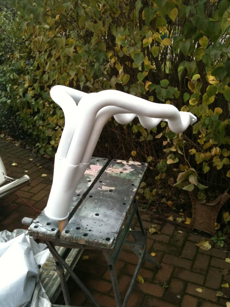

  12. langy
    Joined: Apr 27, 2006
    Posts: 5,730
    langy
    Mostly bits & pieces done today, nothing worth a picture but i did get my headers done in white and wanted to see what they looked like so bolted them on with a few bolts, Its just the look i wanted.

    Looking good Steve. What did you coat the headers with?
  14. langy
    Posts: 5,730
    langy
    Eric they are made from stainless so they just got a coat of VHT white.

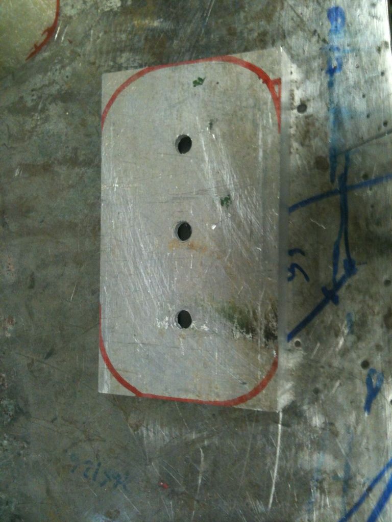

    I was sat in the drivers seat the other night and realised i couldn't reach the dash when strapped in, I needed the important switches closer to me.
    I solved this with a gl***fibre box which was moulded off a washing sachet container.
    I aim to mount this with some stainless tube between the seats and run the wiring through the tube so its hidden.
    I thought a nice finned top plate to hold the switches might be nice, thickest bit of aluminium plate i had was 1/2" so a quick call to my mate Allan and he had some 3/4", He also kindly offered to mill the slots in it to save me some time.
    First the 3/4" aluminium plate was cut.
    Next it was marked out and drilled and counterbored.
    Next the grooves were ball milled into the plate.
    Next to get sloping sides on the fins the plate was tilted at 14 degrees and the sides of the fins got a p*** with the cutter.
    What we ended up with.
    Next the shape was marked out and the excess cut off.
    The ends of the fins were then curved.
    Next job was to remove all the sharp edges and replace with nice radius's and give it a quick polish to see how it looked.
