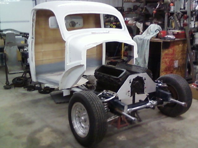

    Not much happening as winter is now upon us but i did have to put in a firewall behind the seats, was going to use aluminium sheet but decided using 3mm ply was easier and once it had some gl*** & resin on it it would stiffen up.
    Did it in 2 pieces for speed and ease.
    Heres the opening to block off
    First a template was cut and tried for fit.
    Next a layer of gl*** mat was applied to each side.
    All gl***ed in place, like a steel panel now.
    Also got my battery box made up & fitted.
    Also when i went to the chrome shop this week some of my cage/seat mounts had been done, He is doing it in between jobs so hopefully the rest will be done next week.

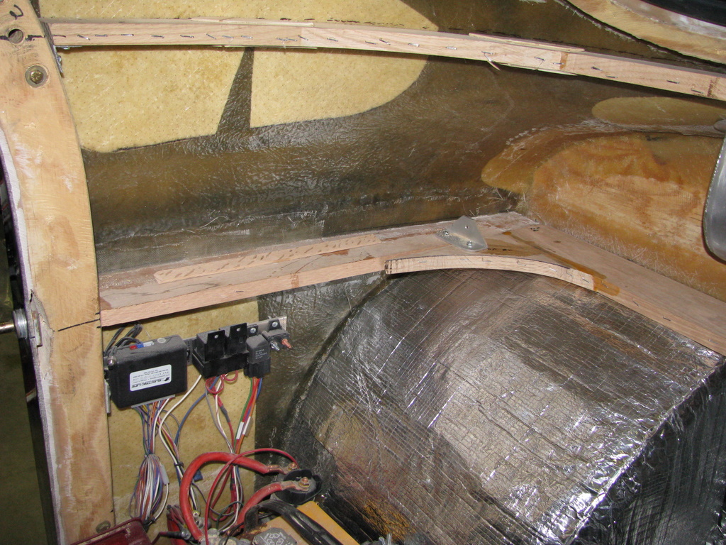

    Langy, I've been just lurking here for quite a while. I truely enjoy watching a craftsman build his car. I also have a "plastic" car that I built myself much as you are doing.

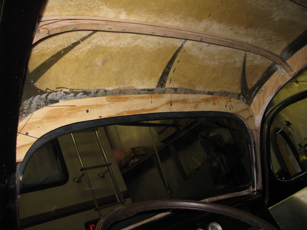

    About the stage you are at I began thinking of the interior. I'm pro Street rather than "g***er" and my car was created with the idea that it would be driven as close to daily as possible. To date a little over 2 seasons I'm at 17k miles. I'm not sure whether you are going with the gqsser spartan interior or a more conventional upholstered style. I'm split. Upholstered headliner and seats but aluminum sheet inside door skins. So far.
    Here are a couple of shots of the roof bows that I made. They are cut from premium oak and glued where necessary. I made the mistake of gl***ing 3 of them to the roof. Don't do this!! My body is thouroughly oven cured and I thought the new resin would not affect it. Not so. the outer skin or gel coat shrank enough that it caused ripples in my fresh paint job. I was able to cut them out and over the last summer the heat relaxed the mess and it is hardly visible now. The new roof bows are installed with silicone sealer which allows a micro amount of movement as the body expands and contracts. Just something for you to consider.
    I also bought an industrial sewing machine and spent a couple months learning to use it. I then created the head liner and carpeting along with a number of other car projects.

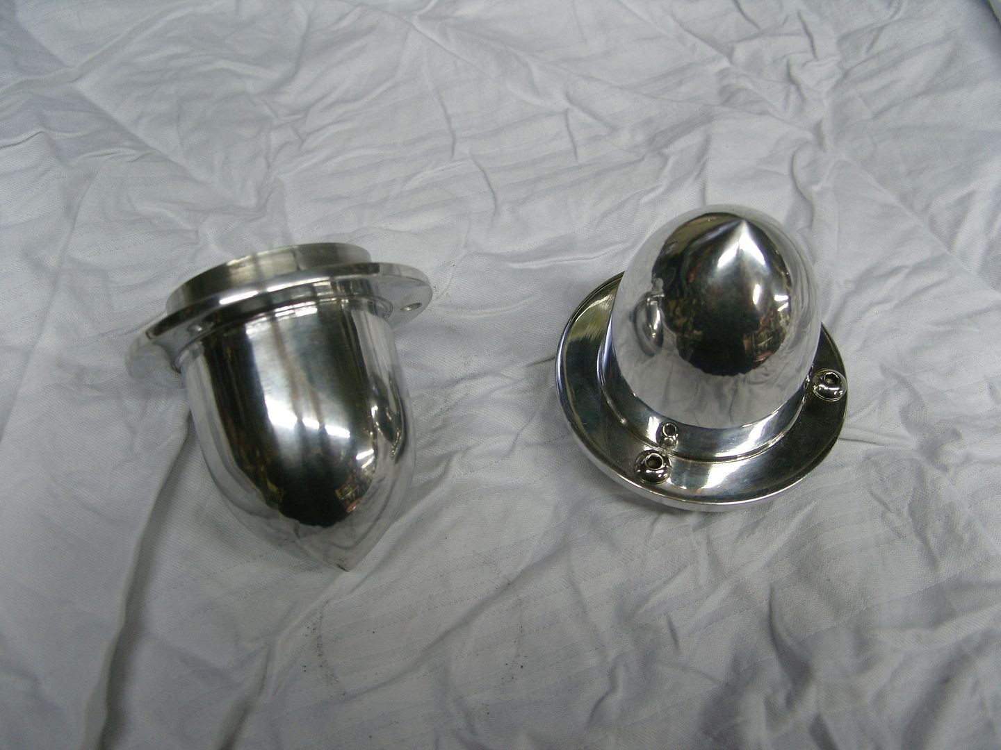

    I gave my Mags to a machinist as the plan has changed slightly and i needed more accuracy than the old bridgeport i use has, I needed to come up with a pair of grease retaining caps for the outside of the hub so i spun a pair up in the lathe from 2.5" aluminium bar.
    Firstly i bored out the shape and then turned the outside shape into the bar, then the outside was sanded to a nice radius.
    The first one came out perfect :D
    But i screwed up on the second one by taking off to much material, these are only 1/16" thick so it was easily done :eek:
    I always say everybody screws up occ***ionaly but the important thing is how you rescue the situation and save the day by not having to remake another !!!
    Welding was my first thought, Now i don't do much aluminium welding and certainly not on something this thin !!! Anyway popped over to see my mate Gary and we decided to have a go at it, as soon as the TIG sparked up it blew a hole so it was decided to run 2 beads 1/4" apart with 1.6mm rod and then fill in the gap between with 3mm rod, It worked a treat although doesn't look pretty !!!
    Back at the workshop it went back in the lathe and the inside was rebored and cleaned out, then the outside was recontoured and sanded. A liner was made to be a slide fit inside so it could be gripped securley in the chuck.
    A quick wipe up on the polisher and the job was done, 3 equidistant holes were drilled for machne screws that secure it to the wheel hub.

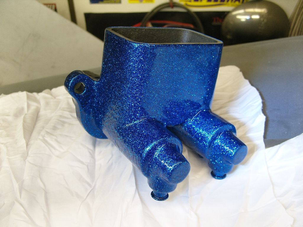

    Had to paint some kitchen cabinet doors today :( so thought while i had the gun out i would do a test piece to see what my Blue flake was going to look like.
    I chose the master cylinder as I had already smoothed it out a bit.
    First up i gave it a couple of coats of Epoxy primer
    After it had dried it got a quick key up with 600 wet and a coat of Black epoxy on it, I've decided to use a Black basecoat this time as it will save me a lot of work when i paint the body, I can primer it in Black and then go straight on with the blue flake therefore saving money on bascoat and time.
